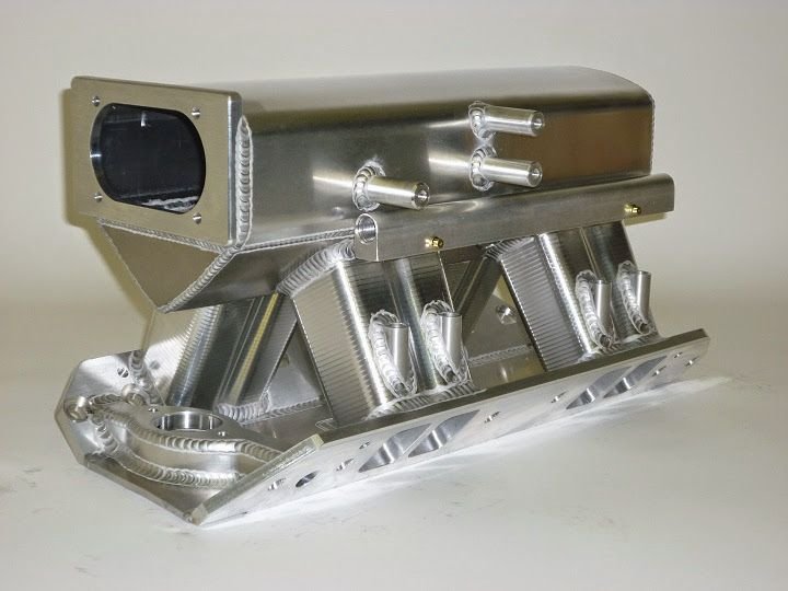

The ones they made for my 525 efi's.

I was watching *****in rides looks like a Hogan ?

Speedy, look up Marcella Intakes.

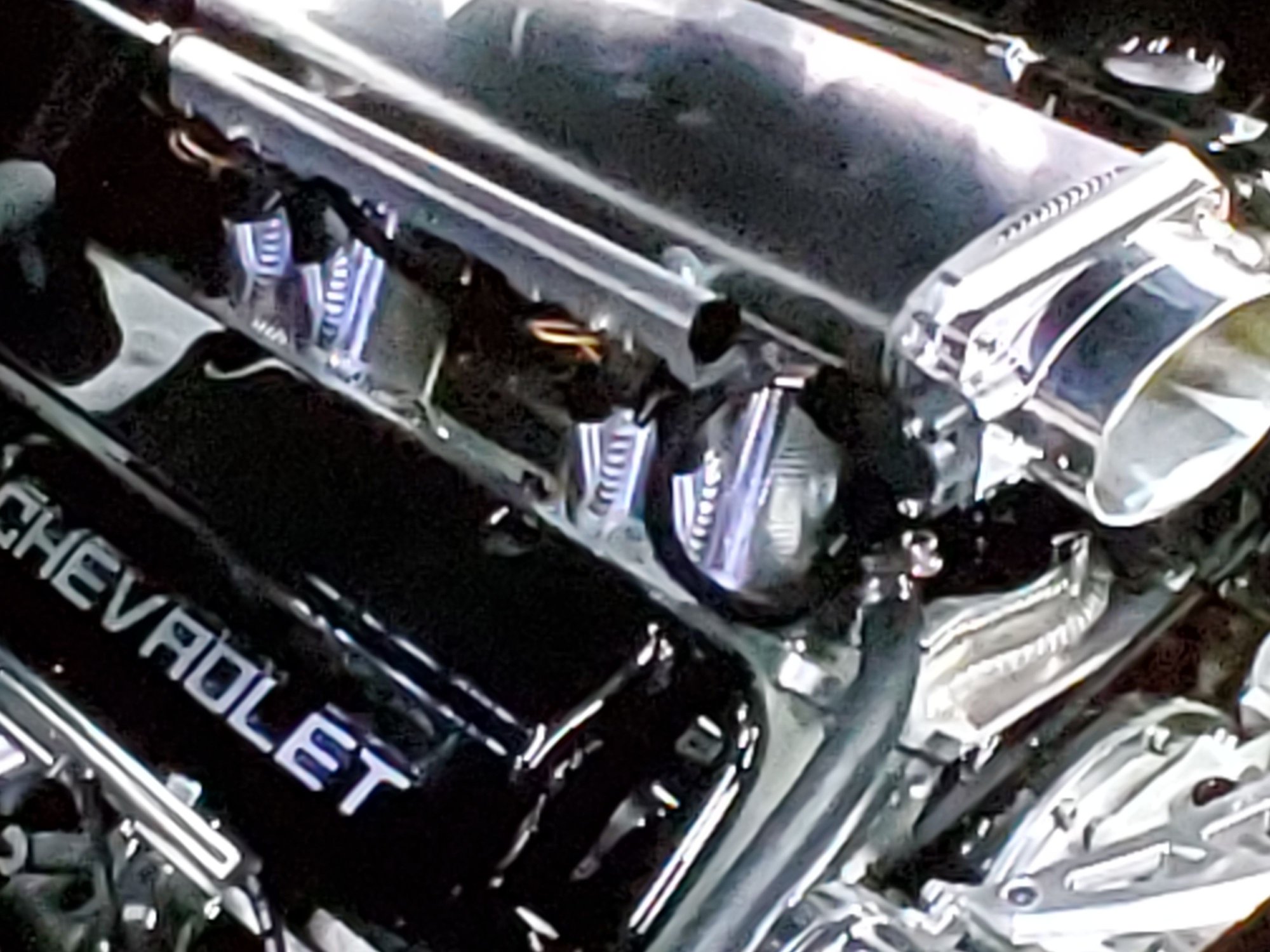

I’ll get a better pic next week, but we have Wilson sheet metal intakes under the whipple 8.3’s on these.

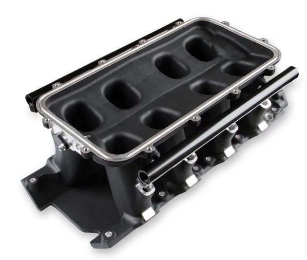

I was looking into this below my Whipple on my 302, but the stack up is 14.5". A little too much sticking out of the hood.
I don't think an EFI one is available for BBC.
https://www.holley.com/products/engi...arts/300-274BK

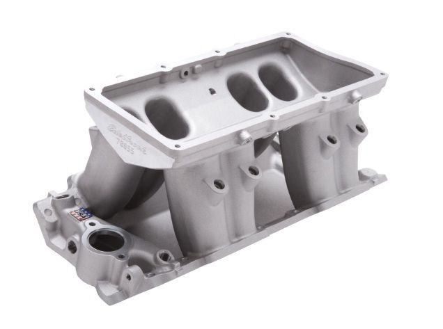

Well son of a bitc#... This might work.
https://www.edelbrock.com/victor-ram...ons-70855.html
