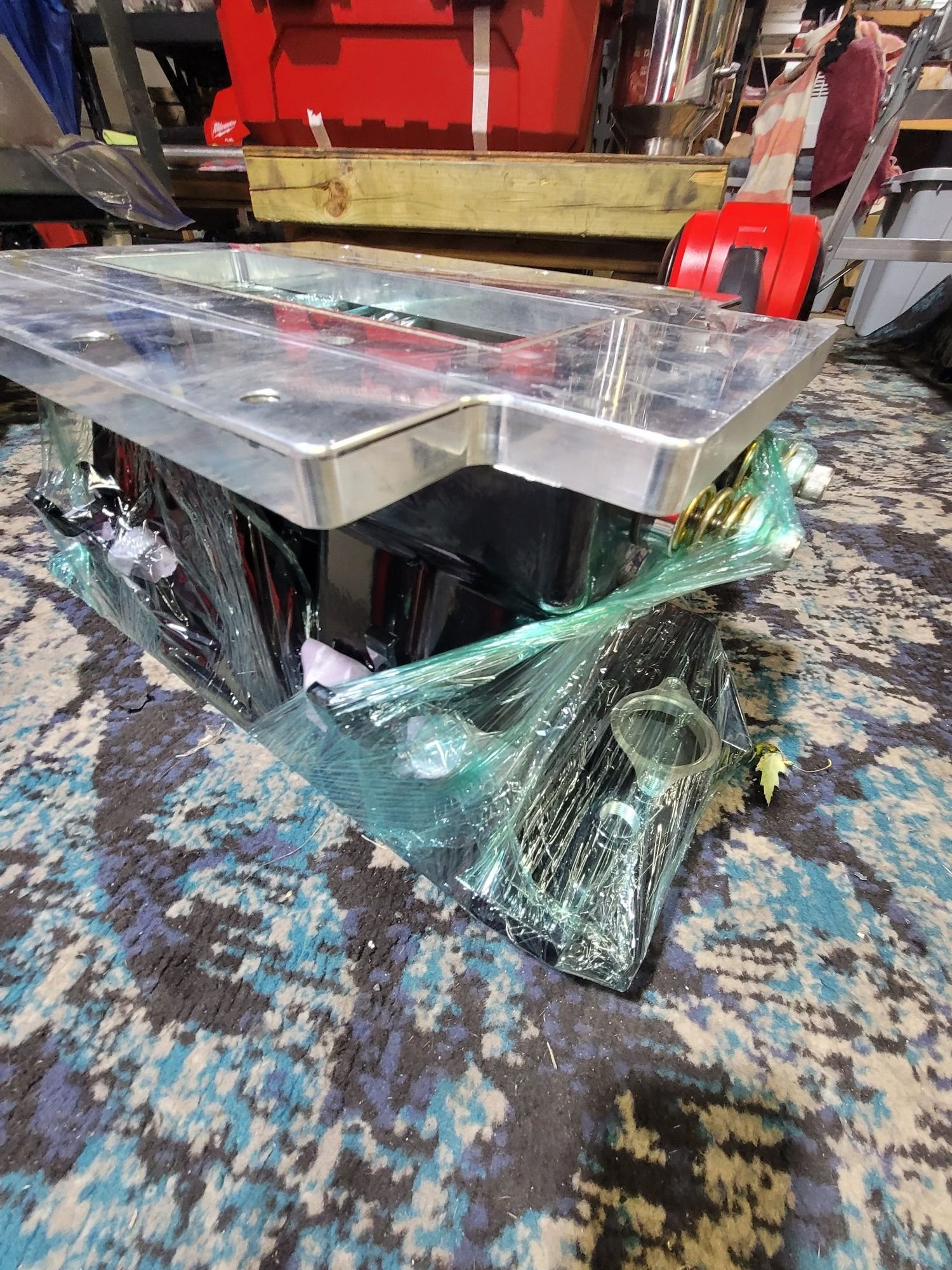

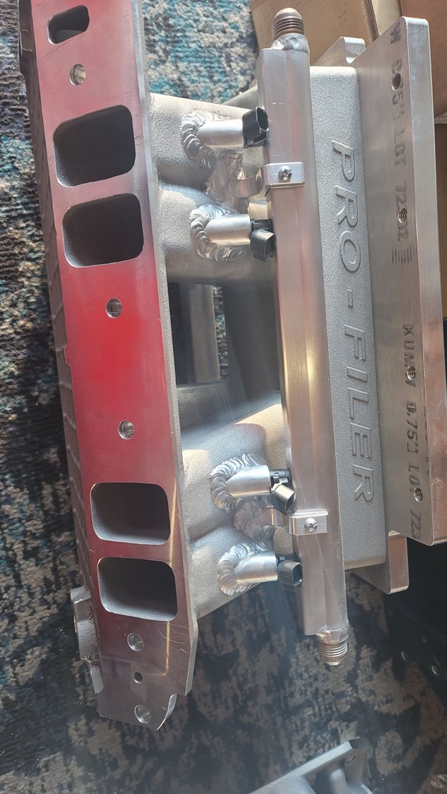

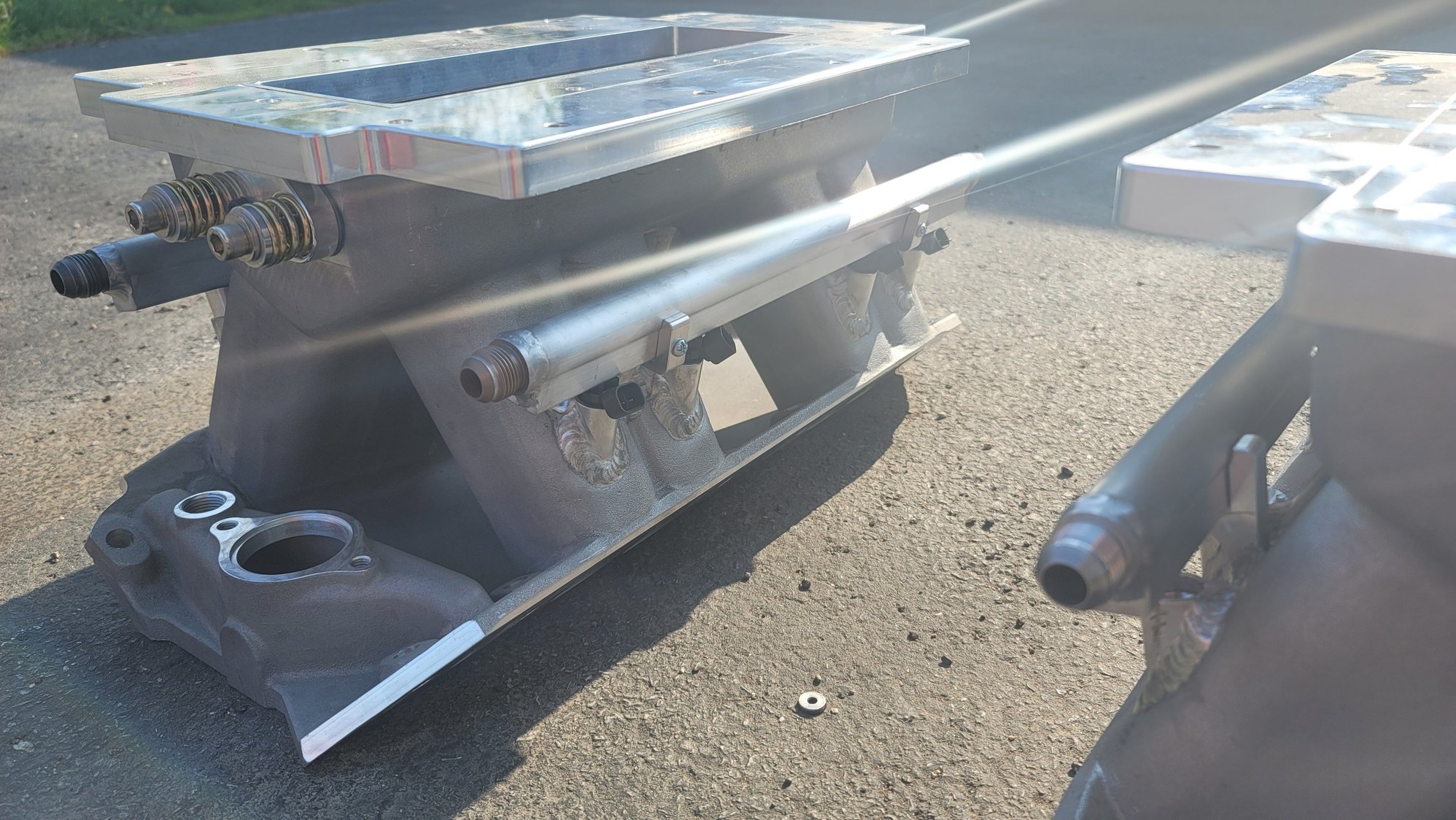

Off to powdercoat .

Looks great! I've been waiting for this post.
That's what I think I'm going to do with my 8-71 SBF intakes. Instead of welding the injector bungs in I'm going to freeze fit them in.

Those freagin ports look like you could crawl through them to ck your valves!
Badd ass!

Ya they pretty large , I can see the $6/gallon fuel disappearing pretty quickly

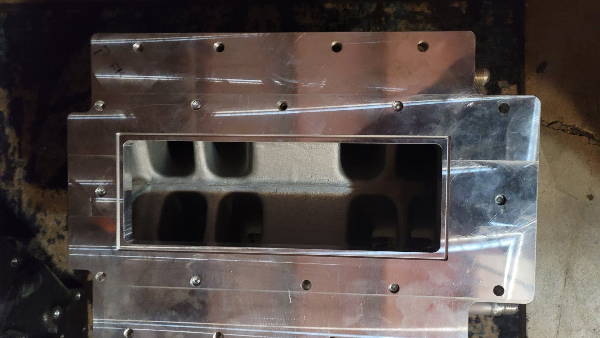

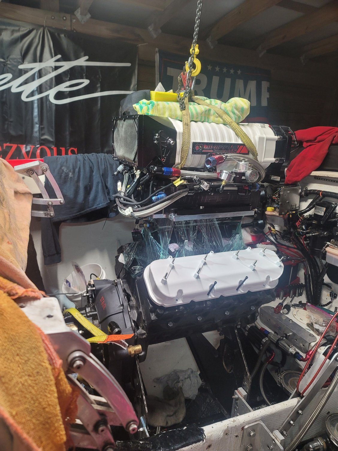

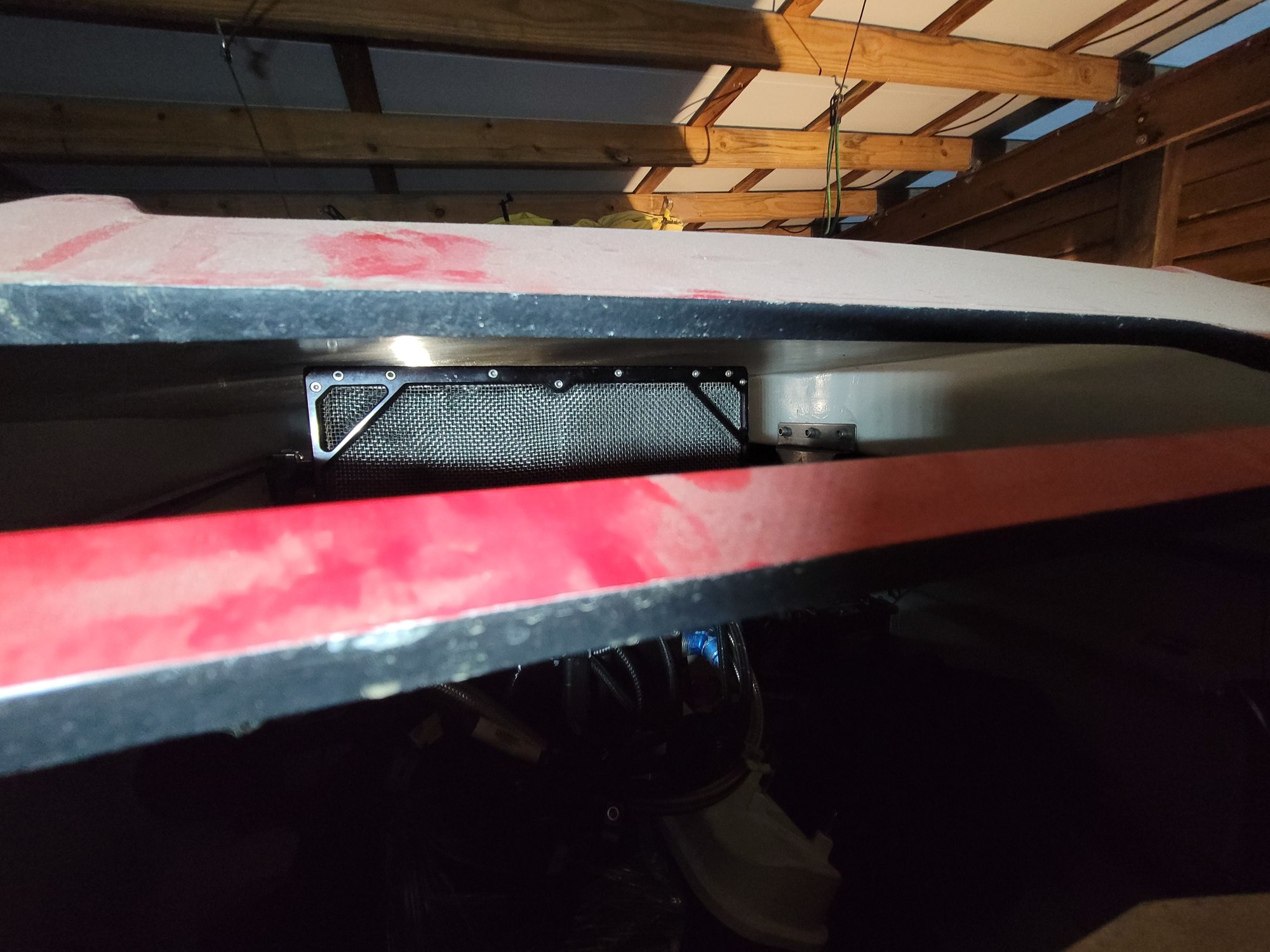

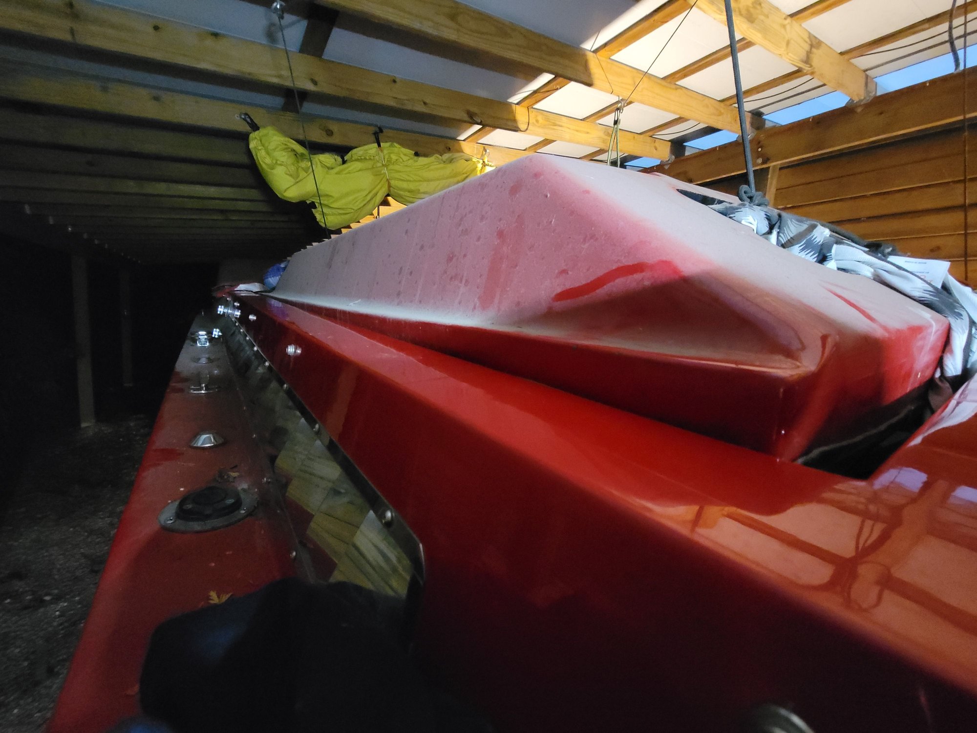

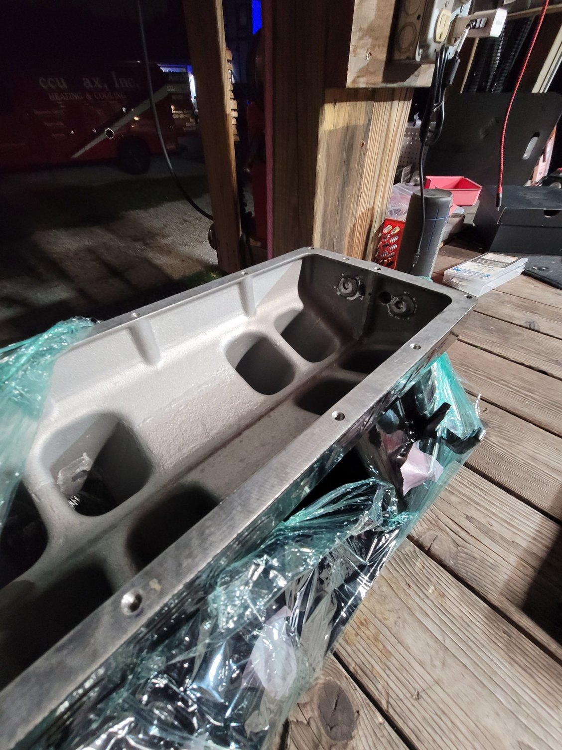

The tunnel cram project is dead.
With the number 6`s drives I had to raise the engines so the trans would line up and that made the whole thing too high for my hatch and I don`t see a safe way to mill anything to gain that back.
This sucks, I spent a lot of time and $$$ modifying these intakes, they`re all powdercoated and ready to go too
I can mill the top plate but that only gives me 1/2"
I also sold my almost new intakes so I shot myself in the foot there too.
