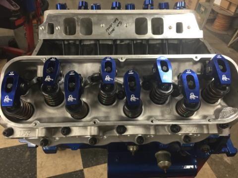

I understand, I believe the article was written for automobiles. Trying to answer my own original question and I have many more. This is what happens when the engine builder keeps the owner totally in the dark about his own build. I wasn't even allowed to attend a dyno session and got only a grainy vid and dyno sheets as proof of life. When I got it home I found untightened plugs in the injection ports in the intake manifold and carb base plate just as I left them when I delivered the parts. I asked specifically for pics with the oil pan off so I could verify my parts where used(Trust but Verify) never got one. Pics of rockers installed but avoided letting me see the lifters(Trust but Verify) I know what's supposed to be in there and will verify before this thing ever sees fire. The whole thing turned out to be a chitty deal and still pisses me off. Pulled a valve cover when I got it home and found that they where drilled and tapped for breathers and oil fill WHILE BOLTED ON MY NEW ENGINE. Didn't appear to be run like that but surely set me up to blow it up. Cleaned up the mess but will remove the oil pan and verify no debris and my parts among some other things. From what I see, beautiful professional job of assembly BUT...............I have questions including how it was set up .on the dyno. Crappy deal for me but I'll eventually get it sorted out. It's why I come here seeking knowledge.
