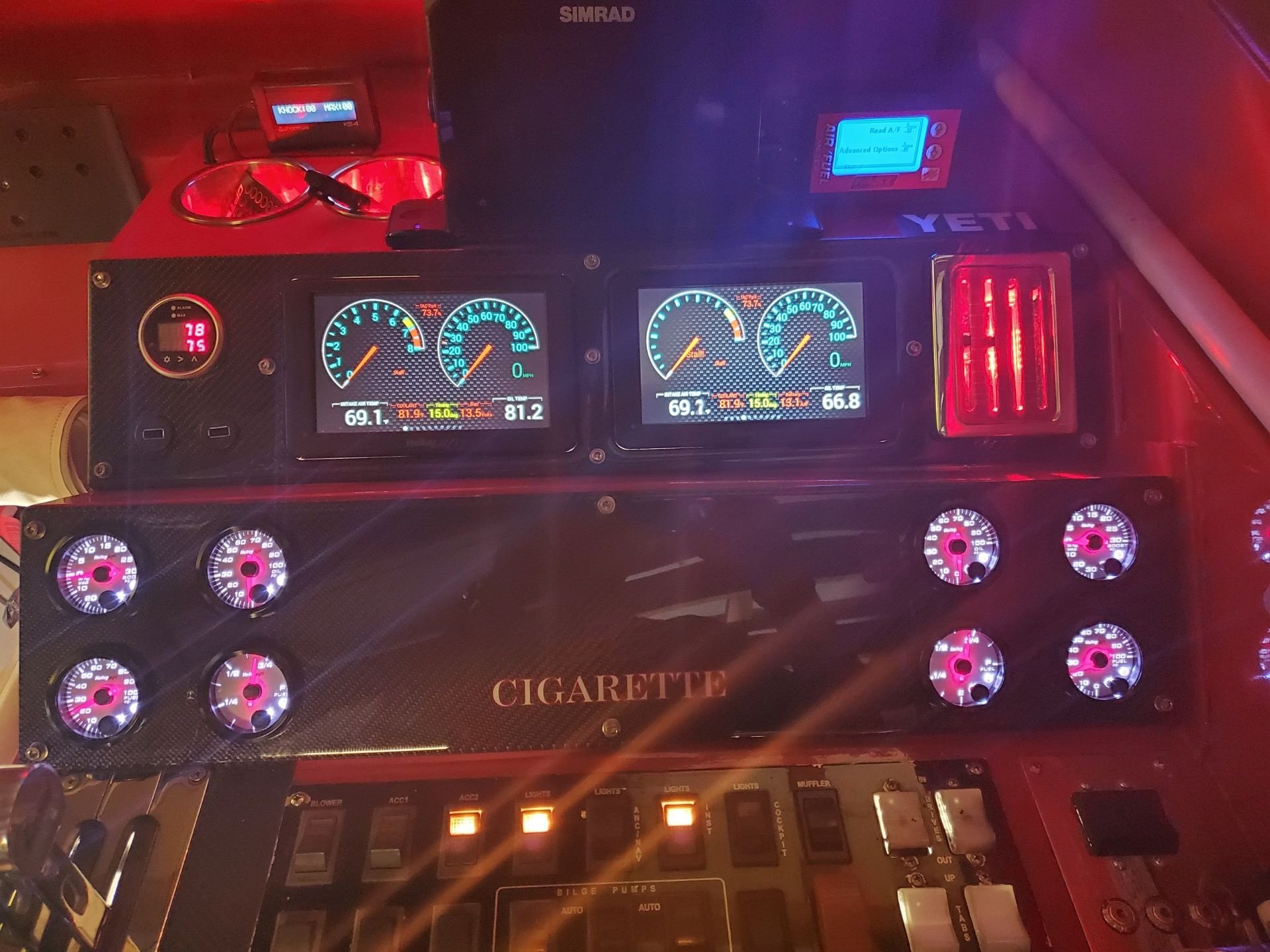

Originally Posted by the deep
Is this what I need? Which one do you guys use?
https://www.amazon.com/Innovate-Moto.../dp/B013UG0M8K
I have innovate gauges in my dash two sensors per engine

I went the gauge route too. I was going to use the handheld, but I'd like to catch issues as they come about. Cheap insurance.

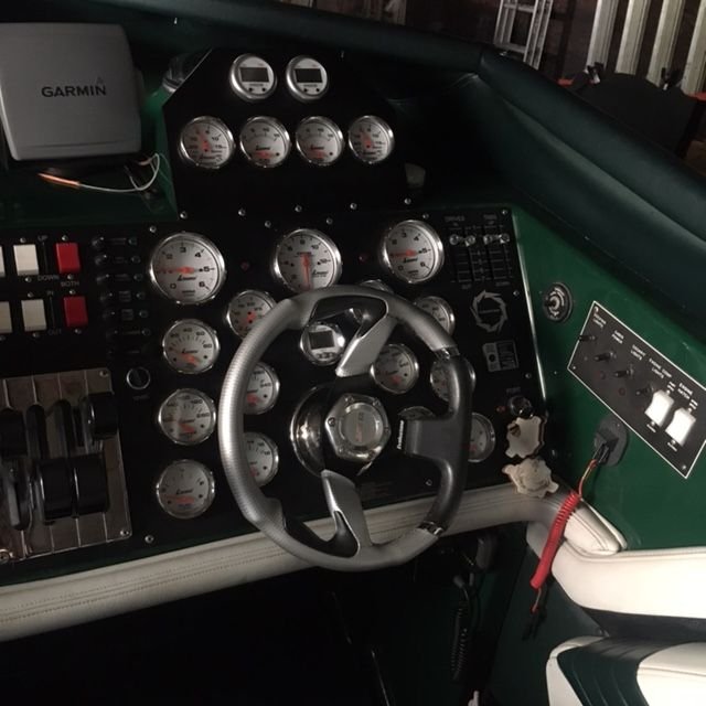

I had it mounted on the dash
