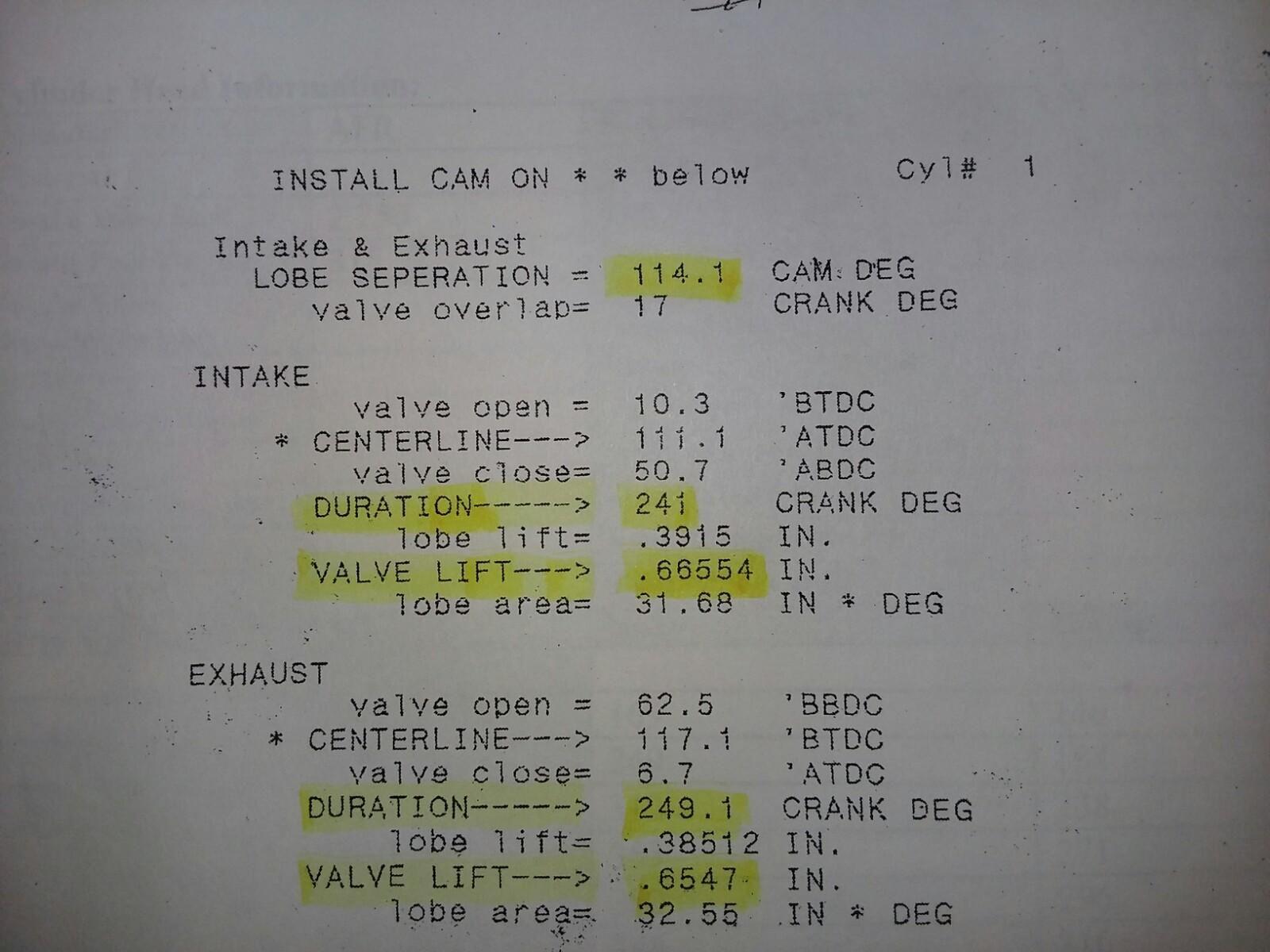

Yes the builder was Bersani. The engine was still in their truck when I got there and I noticed some mucked up things right off the bat. He did then admit to me this was the first roots blower engine he ever built........thanks RM Builder. Sounds like a road trip is in order to Frankenmuth, Michigan. No one around here understands blown marine engines. I've never been around dyno's or blown engines so no experience although been a wrench turner my whole life. Like I said, this is a one shot deal for me so I've got to get it right. Here's the cam card. Yes it has the cylinder swap. Not even sure which tails to run, dry or dry to the tip?
Something else to keep an eye 👁 on! Looks like some familiar specs from way back. Little less lift than full force.
