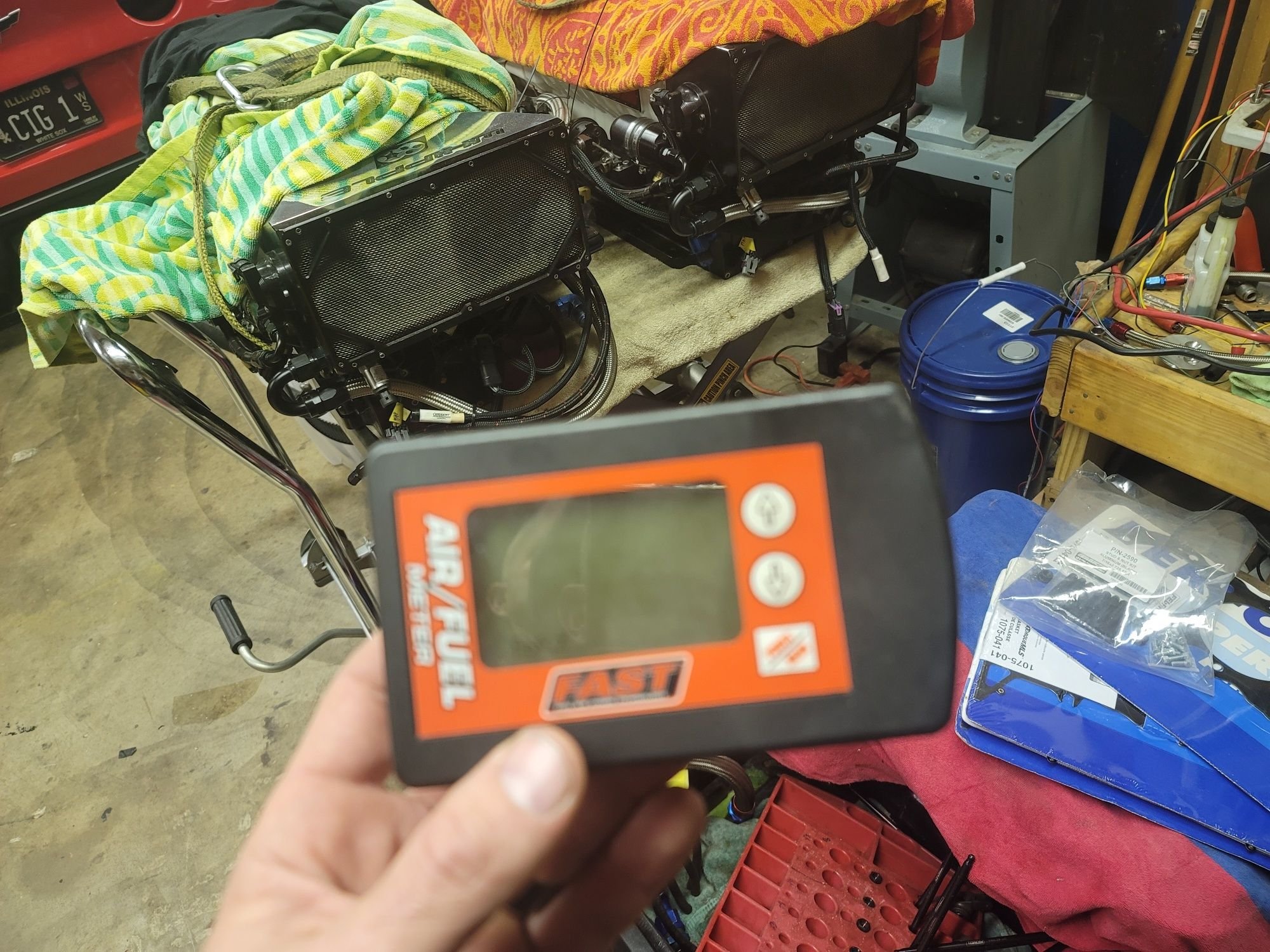

Old 12-15-2021 | 07:02 PM
  #59
F-2 Speedy's Avatar
Posts: 11,439
Likes: 3,970
From: Midwest & T-Rock
thats the one I have ^^^^
F-2 Speedy is offline
Old 12-15-2021 | 08:17 PM
  #60
Joined: Jun 2009
Posts: 9,989
Likes: 6,484
From: Chicago
I have this left over , you`re welcome to it .
You would have to buy the wires, it`s a dual 02 kit but the wires are still in my boat and I`m not pulling them out anytime soon .
https://www.jegs.com/i/FAST/244/170402/10002/-1
