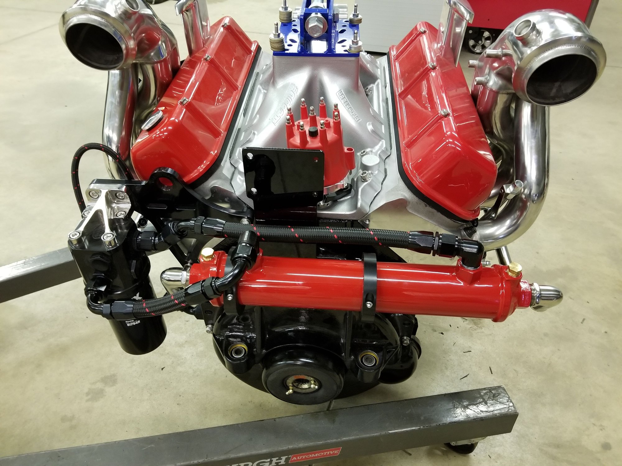

hardin thermostatic controlled filters and 3x15 coolers
about the cleanest , most compact way i could get it done.
