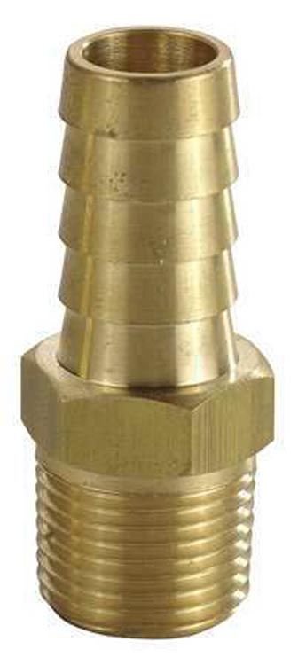

This is s pic of the fitting. Sure looks like pipe thread to me. Specs on link above indicate this too.

Those prefilters have been discussed on here before.
I don't think there ever has been a crossover number to the auto world discovered.
The GM apps use M16 x 1.5 threads and have an O ring seal situation.
And the Merc is a NPT setup.
My boat is an 03. When I got it 12 years ago I thought replace those, they should be cheap enough.
Now at link SB posted $73.00 list. WTF
They were like $60 back then. For that?
So I put these 100 micron with correct NPT to hose size barb.
100 micron is customary prior to pump in the racing world.
Stainless screens, cleanable.
Never could find the Merc micron rating and I cut them open there was this measly plastic tube strainer in there.
Hope I got pictures still somewhere. I'm going to look.
If not, cut your old one open and share, see what's in there.
