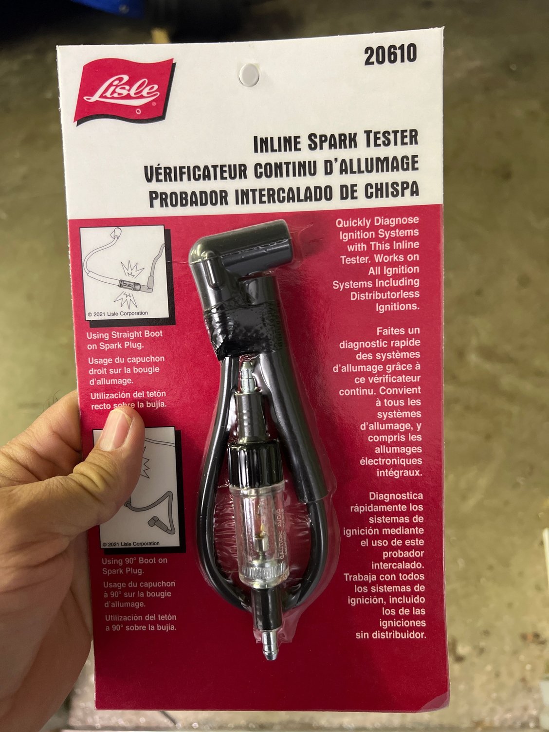

Originally Posted by SB
Lisle (or other’s) spark testers are under $20 and found literally everywhere, including your local parts store:
SB,
I've considered it. Can't you use a timing light to do the same thing? Just curious.
Thanks. Brad.
(947)545-8991
Brad Christy is offline
Old 08-02-2022 | 05:58 AM
  #103
Joined: Jan 2021
Posts: 309
Likes: 150
A timing light will flash when any spark is detected , a tester let's you see a spark to help determine the quality. Some more expensive ones are adjustable requiring the ignition to jump larger gaps to troubleshoot weak ignitions.
carnutsx2 is offline
Old 08-02-2022 | 06:13 AM
  #104
SB
Joined: Nov 2004
Posts: 14,154
Likes: 3,714
From: On A Dirt Floor
SB,
I’ve considered it. Can’t you use a timing light to do the same thing? Just curious.
Thanks. Brad.
(947)545-8991
Sarcasm. Okay, your considering buying coils too. :wink

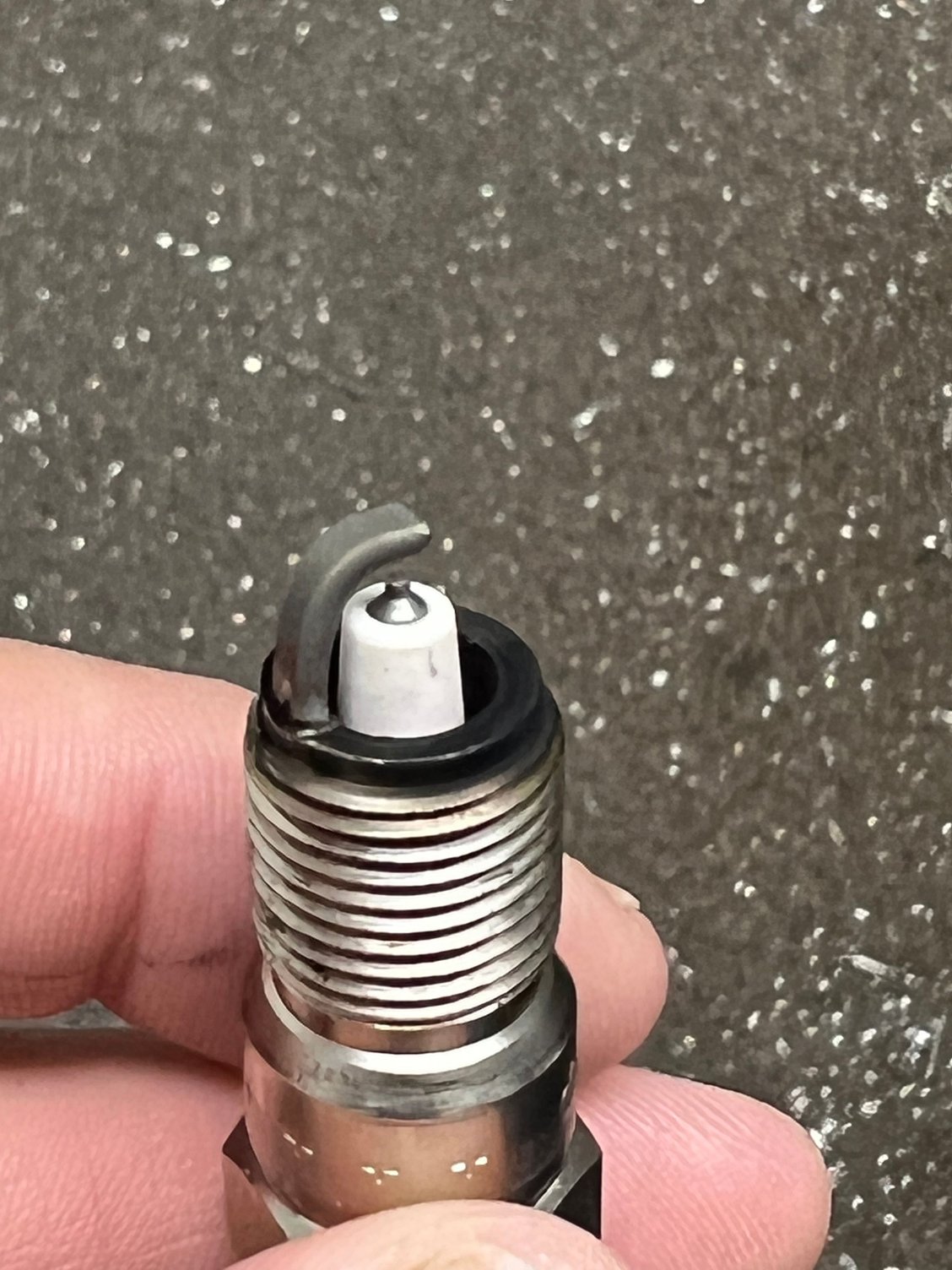

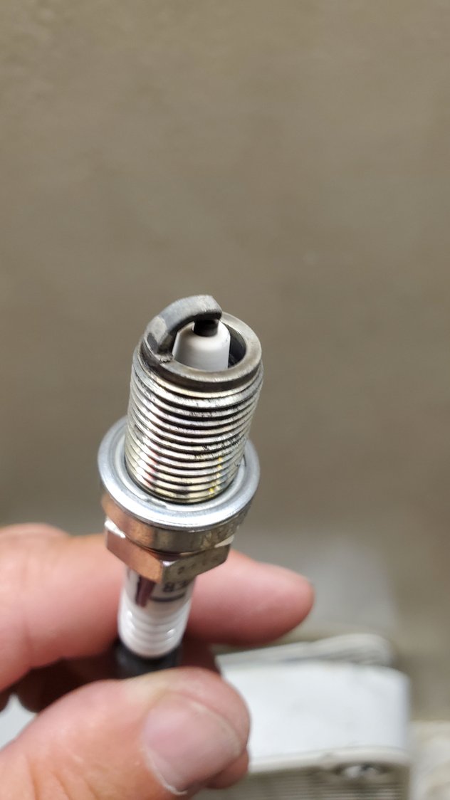

Originally Posted by underpsi68
That plug looks like something hit it? Aluminum?
Take a picture of the side of the ground strap on the plugs, like this. Trying to see the heat line, if there is even one.
Underpsi,
#3 (for reference)
Thanks. Brad.
(937)545-8991
