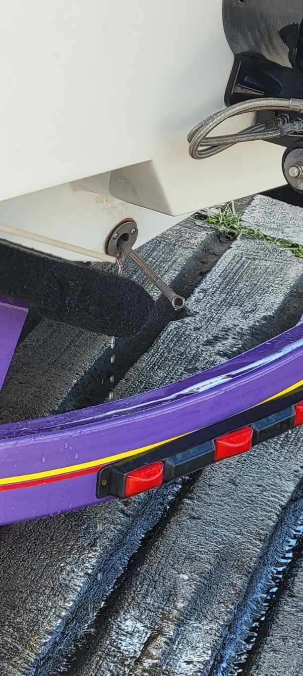

Originally Posted by SB
Brad, don’t be silly. 10mm tools are never found. :wink Thus the million lost 10mm tools memes.
SB,
I beg to differ….
I just couldn’t get it out. 😒
Thanks. Brad.
(947)545-8891
