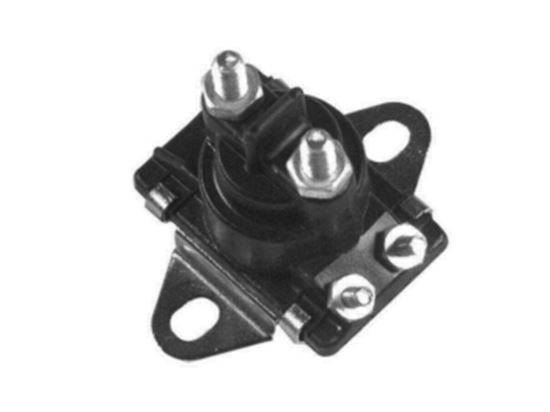

Next comes the compression test. I picked up a remote starter switch. Now I gotta find the starter...... God, that's gonna be a PITFA......😡
Thanks. Brad.
(937)545-8991
Your engine doesn't have the remote starter solenoid ?
(#11) https://www.mercruiserparts.com/bam/.../31823/6708/30
Pic below
SB is offline

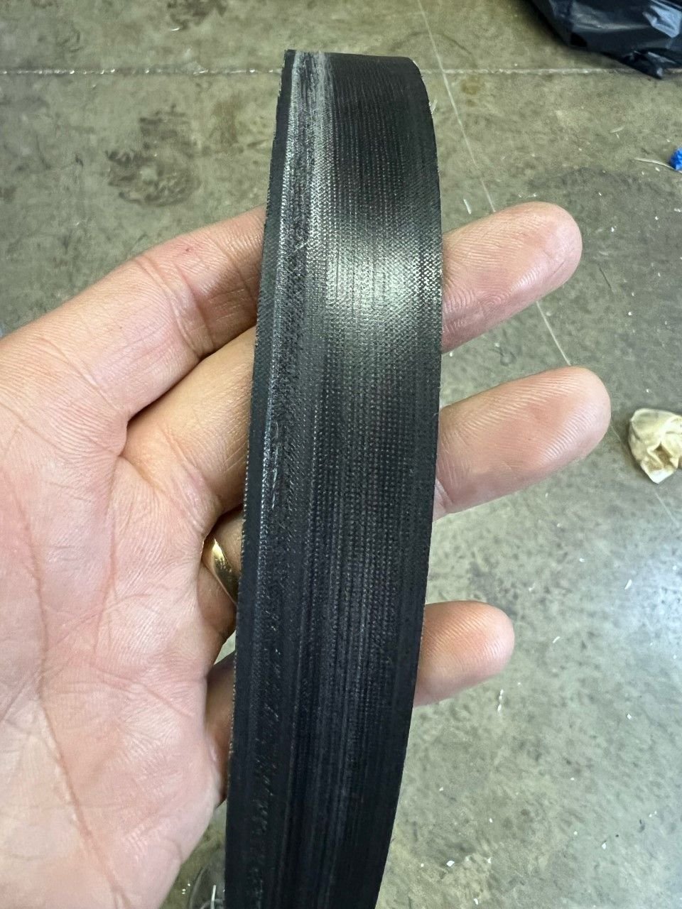

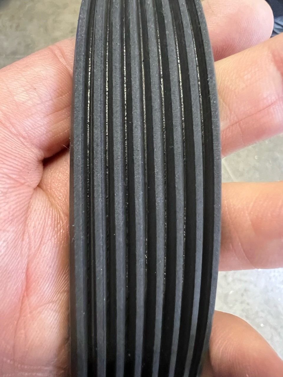

Got the belt changed. Had to make a cheater bar for the breaker bar, and had my nephew hold the tensioner off the belt while I changed it. Only dropped the breaker bar into the bilge once.
It certainly looks like something was rubbing on the outside of the belt, but I'm positive there wasn't. This doesn't mean there wasn't something rubbing on it in the past, before we bought the boat.
This doesn't look like a ton of wear on the belt, but I don't really know what to look for. There is some glazing in the valleys, at the bottom of the Vs, so that could be an indicator that the Vs themselves were worn to that point. The new belt was considerably tighter getting back on the pulleys. The old one came off with the tensioner still pulled back. Getting the new one on required relaxing the tensioner, getting the belt over the rims of the pulleys AND over the tensioner, then pushing the belt to the side, pulling the tensioner, working the belt around it, then releasing the tensioner while ensuring the belt was still between the rims of the pulleys.
Thanks. Brad.
(937)545-8991
Why is that belt so tight ? I can take my whipple belts off with a 1/2 ratchet..........I have 3 or 4 used marine BBC starters if your interested

Maybe someone was trying to remedy a belt slippage issue with more tension?

I haven't touched it since we bought it. Part of the problem is the location and absolute absence of space to work. The tensioner has a 3/8" drive port. I was using a 12" long 1/2" breaker bar with a 1/2-3/8" reducer adapter, and had zero space to work in. Once I get the cheater bar in, it was pretty easy to release the belt.

OK. So, I think I found that little unit. I'll have to pull the top cover off the engine to verify and obviously to use it. So.... How does one actually use it? Is it the actual starter solenoid? Or is it a bypass solenoid, in place simply for diagnostic purposes? I'm looking for wiring diagrams, and finding PLENTY of them, but none specific to Mercruiser, near as I can tell.

Connecting the two big terminals should crank the starter. The run from the ignition key to starter is too long for proper voktage/amperage to move the starters solenoid, so a remote mount removes this issue. Plenty of diagrams fir Mercruiser's remote starter solenoid.
