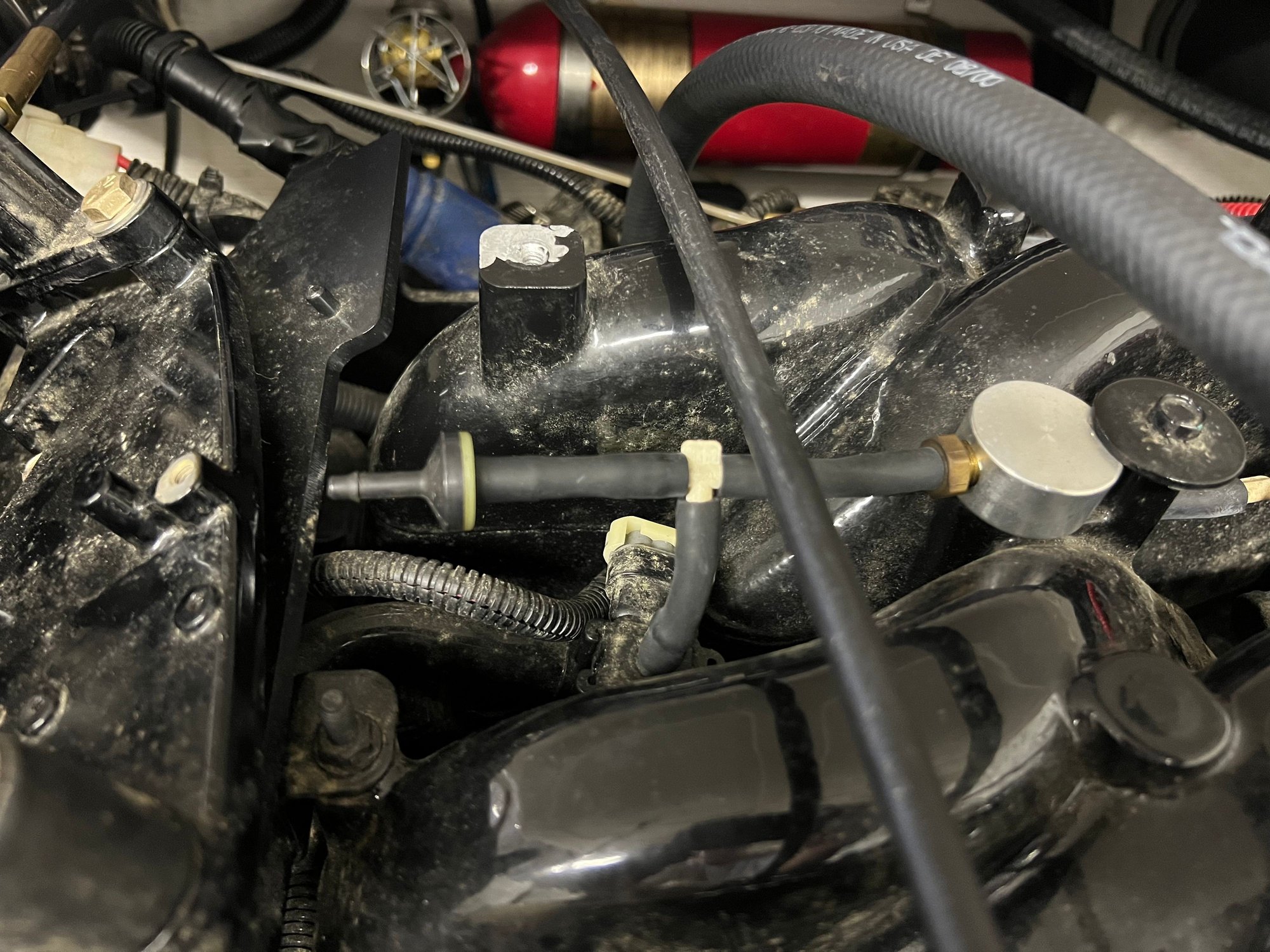

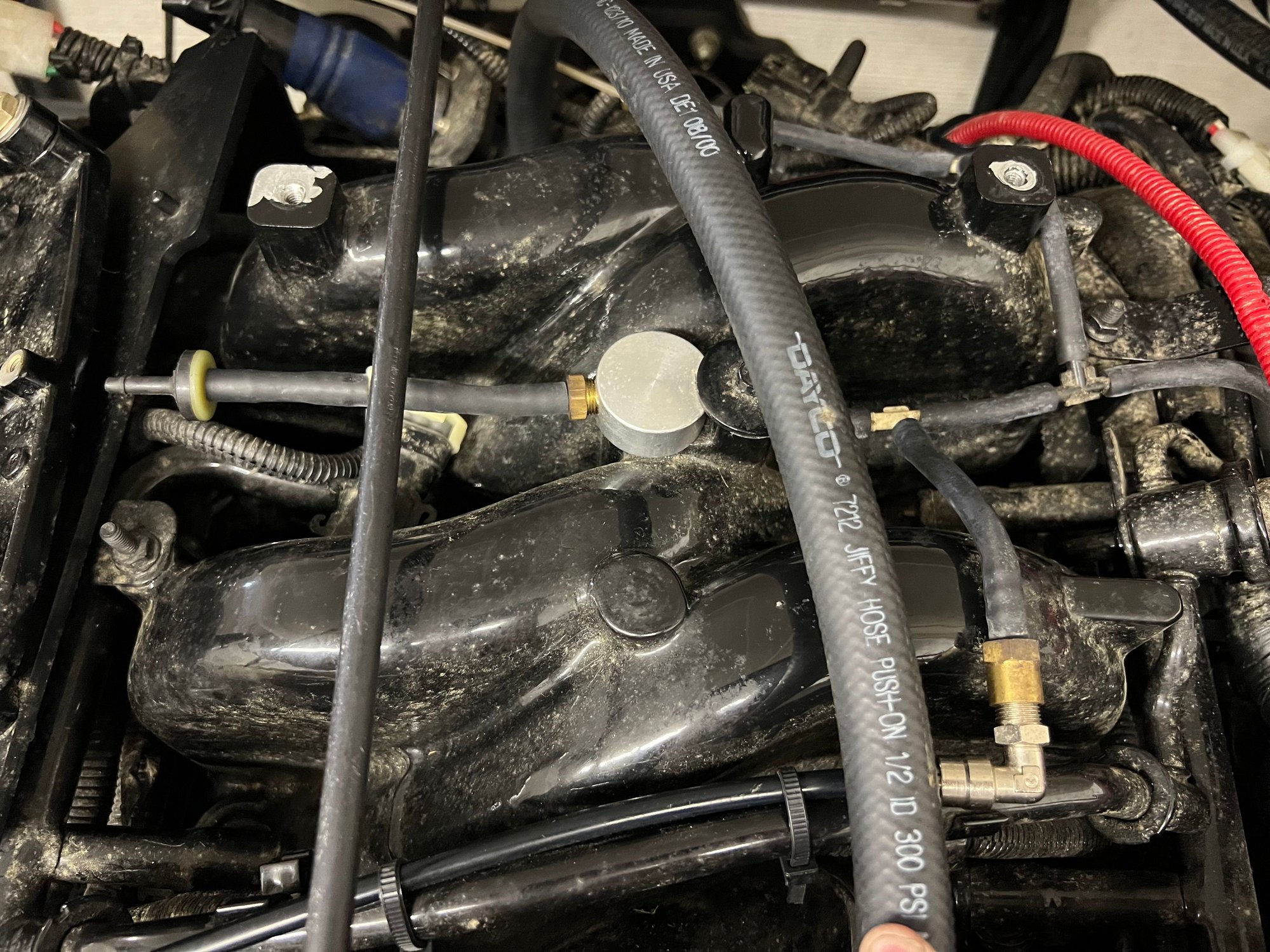

Guys,
What is this widget? And should there be something connected to that nipple pointing to the left?
Thanks. Brad.
(937)545-8991
Brad Christy is offline
Old 08-01-2022 | 08:00 AM
  #85
SB
Joined: Nov 2004
Posts: 14,154
Likes: 3,714
From: On A Dirt Floor
Good question. The aluminum thing under bolt is for sourcing intake vacuum. The sensor on left attached to it by vac line is the map sensor. The round item to left of that is a one way valve. But question i share with you is why isn’t this hooked up to something ? Should it be hooked to fmu or is there a vac line to it already ? Or, shoukd vac line end at map sensor ? I’d talk to ati/procharger on this. Looks like their deal as the oe engine’s map sensor is typically where that aluminum piece is.

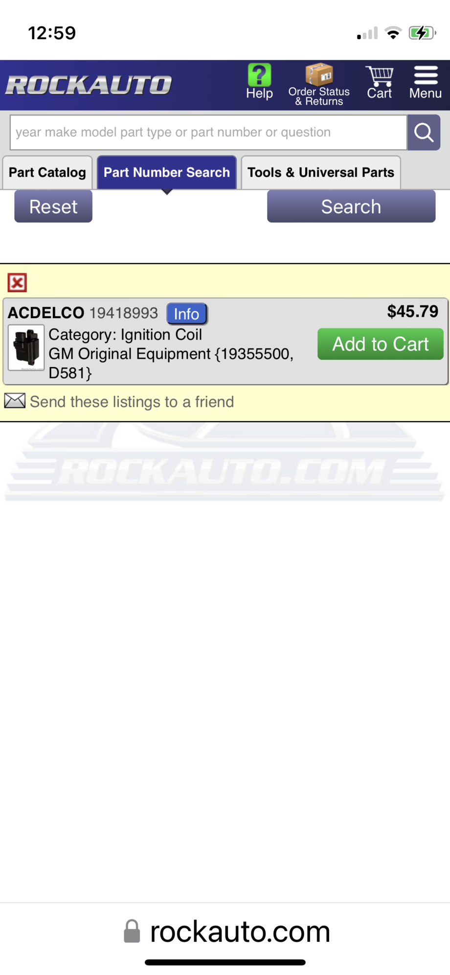

Guys,
Are these two coil packs interchangeable?
Amazon Amazon
https://www.amazon.com/ACDelco-D581-Original-Equipment-Ignition/dp/B000BYGD60?source=ps-sl-shoppingads-lpcontext&ref_=fplfs&psc=1&smid=ATVPDKIKX0DER https://www.amazon.com/ACDelco-D581-Original-Equipment-Ignition/dp/B000BYGD60?source=ps-sl-shoppingads-lpcontext&ref_=fplfs&psc=1&smid=ATVPDKIKX0DER
The first one seems more readily available and is listed as a "newer" model. In the event I find I need to replace mine I want to have a plan in place.
Thanks. Brad.

Appears to be same.
You can also go to acdelco.com. Go yo parts look up and interchange #.

SB,
And cheaper than Amazon, too. 😎
