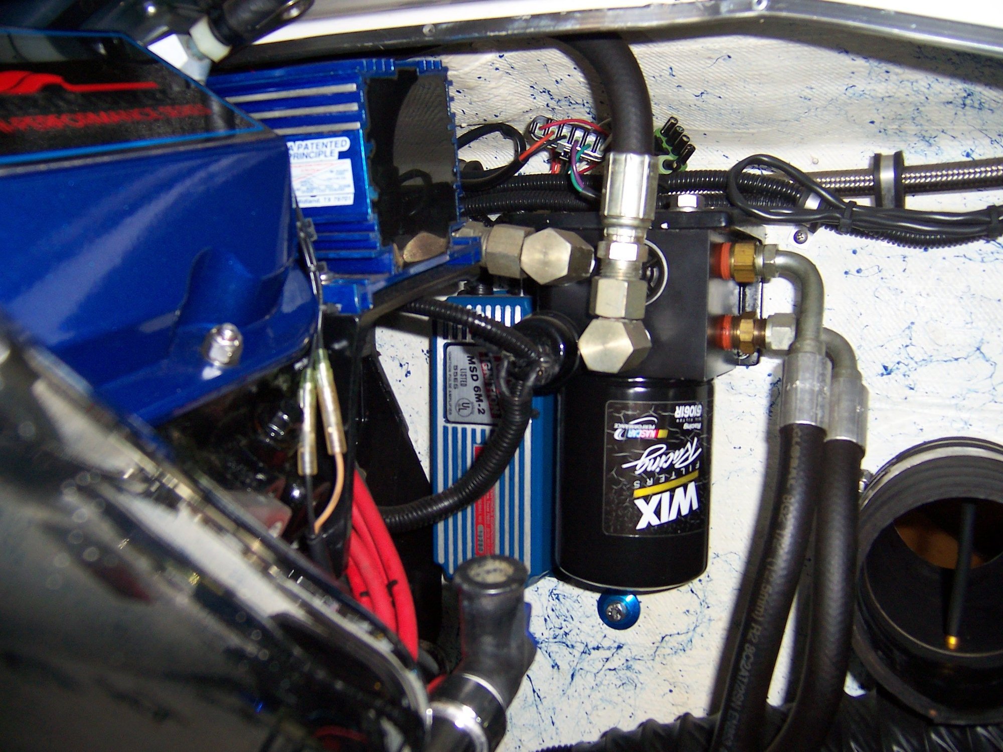

So, I read that the new K&N HP3003 is the old 3002. I've also read that the only difference is that the old 3003 has a built-in bypass valve, and the old 3002 did not. Does this mean that the 3003 I've currently got, after ordering a 3002 (Amazon), does NOT have the bypass valve? How do I know if I have the if I have the NEW 3003 or the OLD 3003? And, with the stock Merc 496 configuration (oil temp sender mods aside), do I NEED a bypass valve, in addition to one that may or may not already be there? Is there one in the stock configuration?
Thanks. Brad.

The factory 496 gen 7s have a 30psi bypass valve located in the block. You don't need a bypass valve in the filter but either way would run fine.

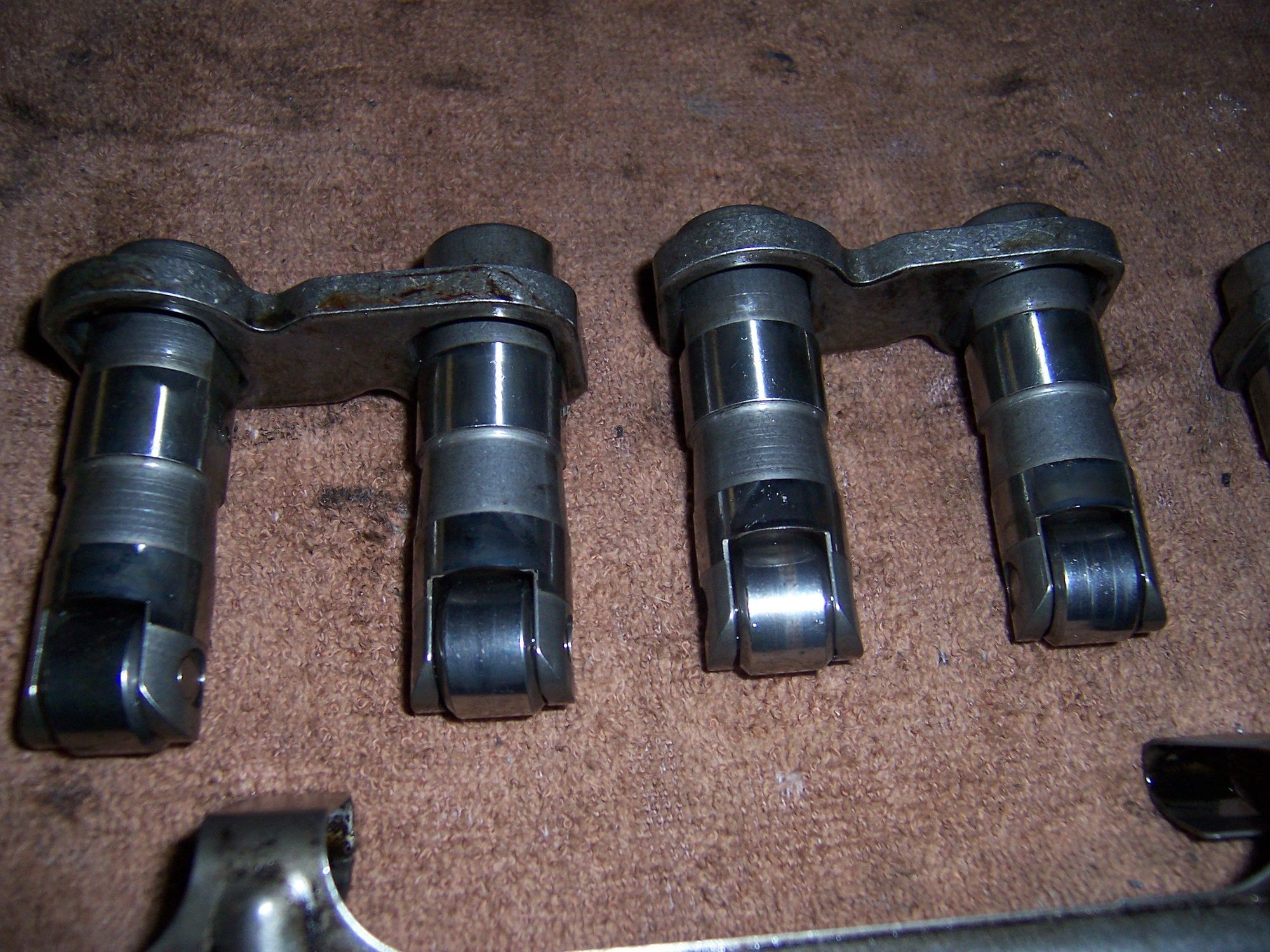

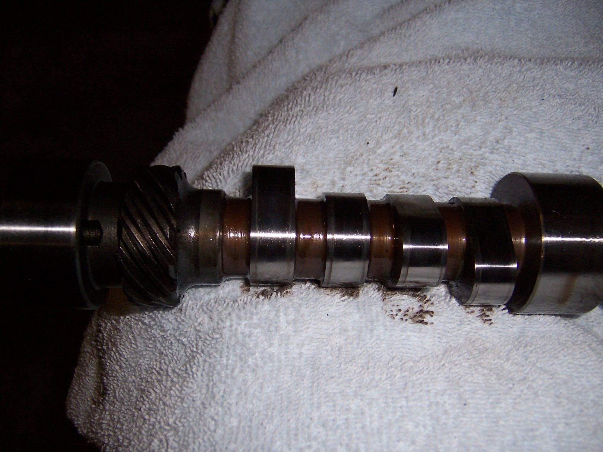

If I have a choice to run a better fiter with a better micron rating why would I chose a Racing filter designed for flow on race cars? .. even if an engine went 100 passes without changing oil or filter (nobody thats smart would do that) thats 10 hrs. I certainly don`t change my oil every 10 hrs.
I`m running the filter with more filtration, to me that`s a no brainer.
I like my filters to filter .. never had a flow issue due to a filter being too good.

They say pictures speak a thousand words. As a side note, this HP 500 had 17 hours of offshore factory race time when I bought it. Never used a drop of oil which is crazy for a BB. You guys telling me I just got lucky my chit didn't blow up? I'm showing you empirical evidence. We don't run in a dirt track environment. 15W50 Mobil 1 changed every 50 hours.
