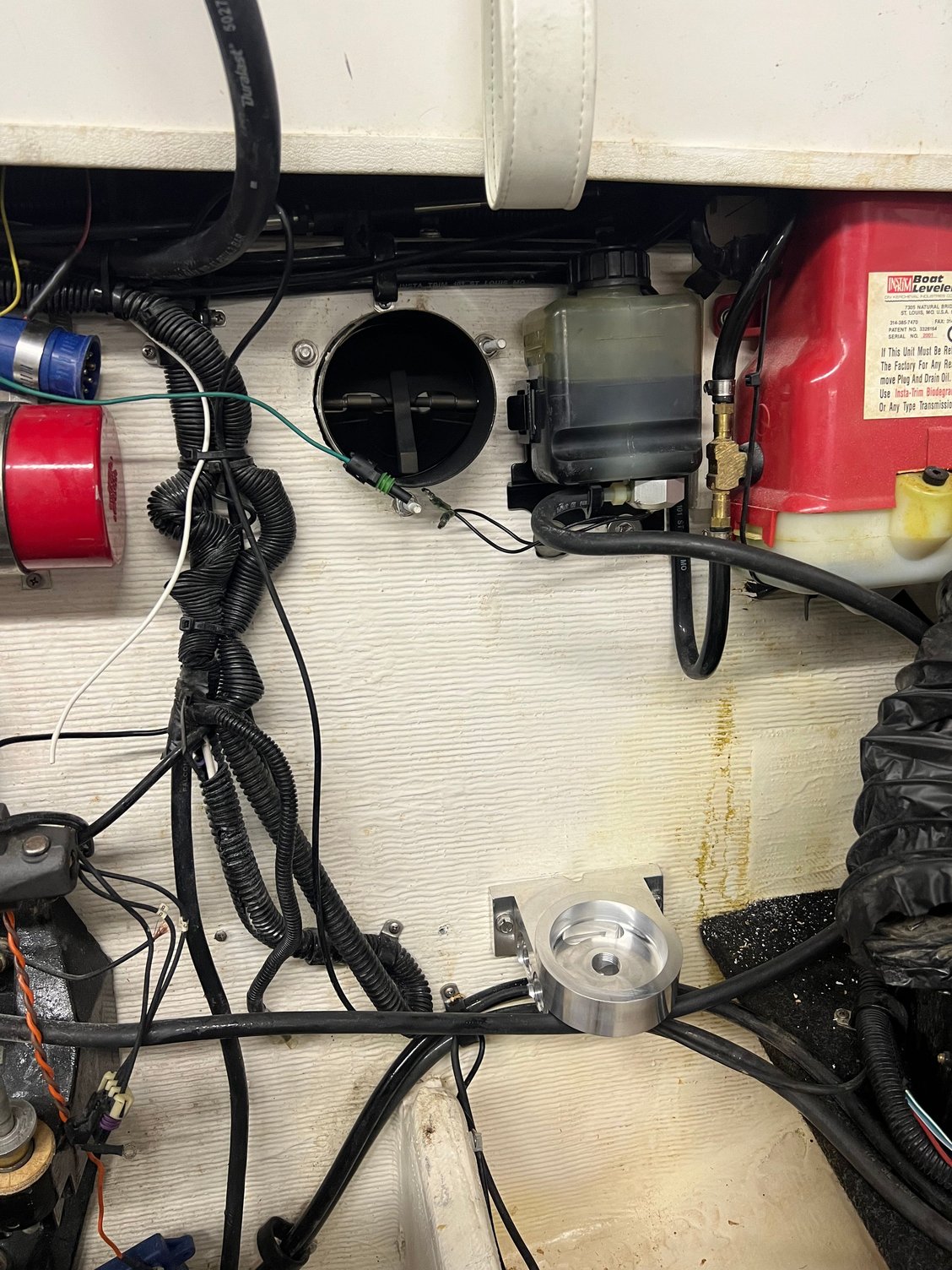

Got the battery switch relocated and mounted
Got the oil filter mount and drive oil reservoir located and “mounted”.
Now that I have all aluminum hardware that is being mounted to the transom, it will all go out for black anodize. When I get it back, I’ll fill all the holes with 4200 and get it all permanently mounted.
Thanks. Brad.
