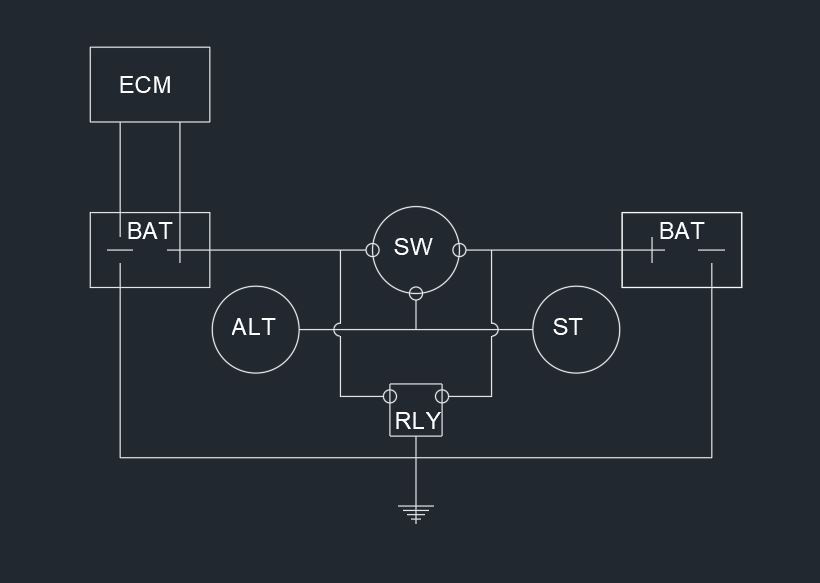

Guys,
I picked up one of these, and I intend to wire it like this:
This still leaves the ECM out to dry in the event of a catastrophic ECM battery failure, but it's the best I can come up with, and no different than a single battery setup. On the right track?

Connecting directly to the battery cable wiring, you remove the potential for lower voltage feeds from poor connections (resistive) down system. Also noise as Dan mentioned. Ground wiring also important for electrical 'noise'.
The protocal is likely to ensure positive successful use and removes a factor when troubleshooting. You may have good wiring practice...others...as we've all seen, are less than desirable.

I vote to wire straight to the battery.

Guys,
Thanks. Brad.
Tartilla,
Yup. As you can see from the diagram, I am planning to connect straight to the battery, including the ground. I just had to figure out how to charge both batteries, regardless of which battery the switch was on. Now, if I could just find an automatic, voltage sensing switch that would instantly switch to the other battery and give me a chance to get back to the trailer should the direct-connect battery take a dump. As it is right now, if the battery the ECM is connected to takes a sh!t, I'm high and dry, and I'll NEVER hear the end of it from the CFO.
