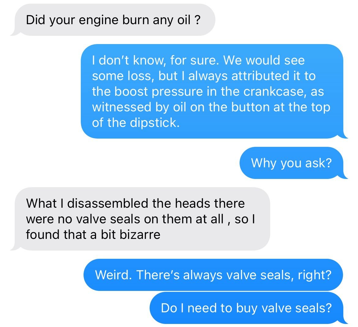

Originally Posted by ICDEDPPL
I dont put valve seal springs on the exhaust.. I thought some guys leave em off all together , More lubrication.
Dan,
Not in my wheelhouse. I know what you’re saying, but the builder didn’t specify. He said, “No valve seals”.
Thanks. Brad.
There's a few types of valve seals. I've used the hat style on the exhaust vs a fixed on the guide boss positive seal.
The hats seem to allow lube but also reduce it from a full exposure.
Exh guides don't have the vacuum draw through energy like the intakes do.

It's bizarre that he has not seen that on a performance marine engine. Sometimes you will see a puff of smoke on start up dependent on oil viscosity and duration between usage. I've run with no seals before. I currently do not know how my heads are setup, I believe like Dans.
Rookie,
Marine engines are about all he does, and mine is very likely the most vanilla engine he's ever done. He didn't specify if it was just intake valve seals he was expecting to see and didn't, or all of them. I do know I don't recall seeing any smoke or smelling burning oil at start up or any other time. We did have some oil loss, as I've mentioned, but minimal, and, after learning about the PCV situation with the 496, I attributed it to a boost issue forcing oil up the dipstick tube.
I have total confidence in the builder, as he comes very well recommended. I'm sure the heads will be set up properly for our application, including valve springs.
Thanks. Brad.

The 496s came from the factory with valve stem seals (16). Your builder has built several 496s up with superchargers etc so he knows what a factory untouched stock 496 should have. Very strange indeed.
87MirageIntruder is offline
Thanks. Brad.
That's kind of a soft spring, but I don't recall cam specs. I think OEM cam is very mild and easy on valvetrain components.
