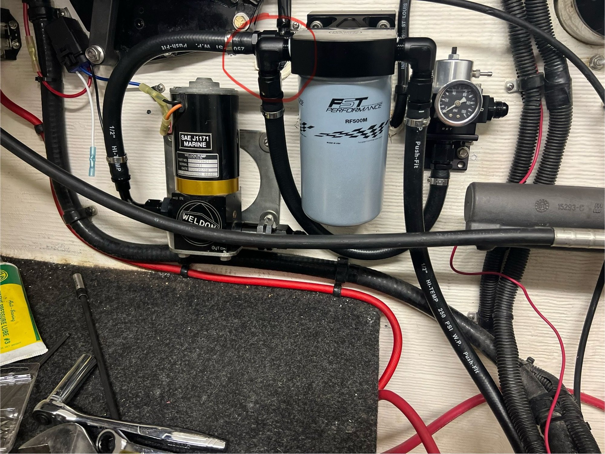

Guys,
Thinking about how to purge the bulk of the air out of the fuel lines for initial population….
As can be seen, I am returning the regulator bleed-off to the filter head. I have explored the option of adding a return bung to the tank, or teeing to the fuel fill tube, which would obviously make this an instant non-problem, but I just don’t see it happening. I don’t have that level of commitment to what is involved. The hose at the fill port is all but inaccessible, and getting it off at the tank has proven impossible. I could maybe tee into the vent tube, but I could see that as being problematic. If not, do tell. Otherwise….
I’m thinking about replacing this elbow with a tee, allowing for a purge line to be attached that will allow the air to escape without having to run it through the filter, continuously recycling it until the injectors consume it. I know some air will have to go through the injectors, but I’m just trying to minimize the process. Obviously the tee would be capped once purging is done.
My question is this:
With this tee open, will the pump pull fuel through it instead of from the tank? I could see it doing so at first, when the entire fuel tract is dry, so I’d plan on capping the purge line (which would be at a vacuum at this point, until we get fuel to the regulator. I’d think the pump would then put the purge line at a higher pressure than the vacuum being drawn on the tank, and the flow would reverse, flushing fuel and air out until “all” the air was gone. From that point on, at least until a fuel filter change, which would require a repeat of the purge process, the fuel tract would be fully populated and devoid of air.
Yes/no? Thoughts?

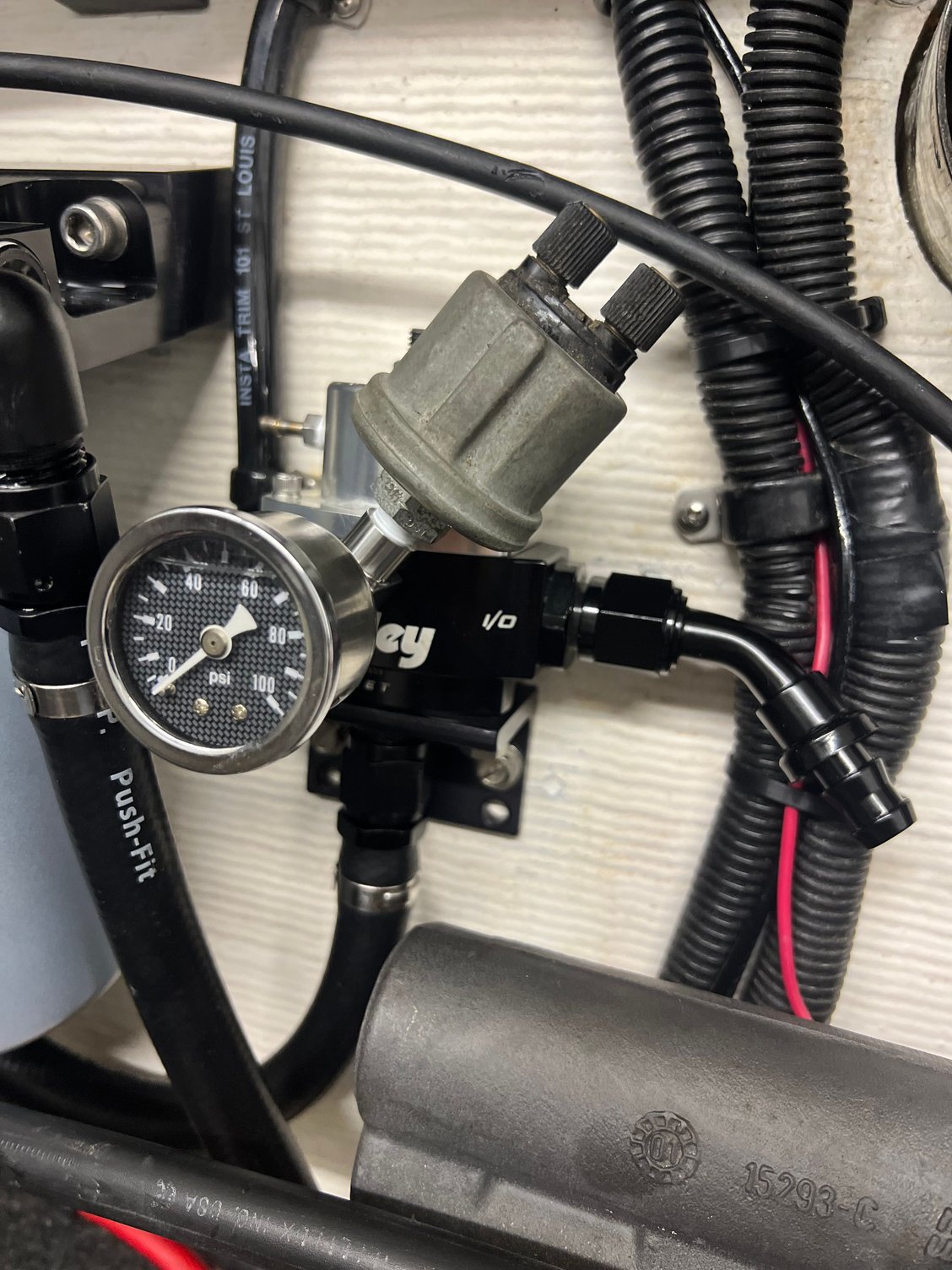

It has been discussed, but no, I don’t have a gauge port on the rail. I have since teed the gauge port on the regulator and included the pressure sender, but the gauge is still on the regulator. Will this not reflect the pressure at the rail?
The OEM fuel rail doesn’t even have a return line, so I know the injectors will eventually consume all the air in the system. I’m just trying to expedite the process a bit.
Thanks. Brad.

you think that would be the case,,we saw differently.after days of running,we finally sent the return to the tank and rail pressure was perfect.this happened on 47excalipers whippled 496's.we tuned his engines on the dyno and we knew the afr's would change,,but the swings were crazy.put the gauge on the rail and it was bouncing.
hope your situation is different,,just keep an eye on it.

I am not at all opposed to running the return back on the tank, but I’m not, at this point, willing to commit to breaching the tank to install a bung, and have yet to find a feasible way to tee to the fill hose. I can get to the top of the tank, and get the fill hose loose, so that I can move it, but at about 1/4” of movement, it just hits a wall and won’t budge. I can get to the fill hose at the fill port under the gunwale, but getting it loose is going to be next to impossible. I’m pretty sure I can tee to the vent line at the top of the tank. Thinking about it, the tank should always be at neutral or negative pressure, with the tank drawing however much air the injectors are consuming through the vent. Is this a viable option?
Thanks. Brad.

Going back to the filter head will be fine and works. I believe the 700s are plumbed the same way .
I`d put a fuel cooler in that line to prevent hydrolock.. not sure what youre talking about injectors and air ?? What air?
