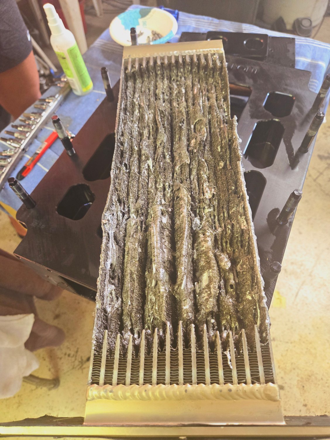

My cams were always as easy on the valvetrain as possible.
Bad kitty engines had low spring pressure (220#) solid roller and I suspect the intake valve bounced and lit a fire in the intake melting the intercooler.

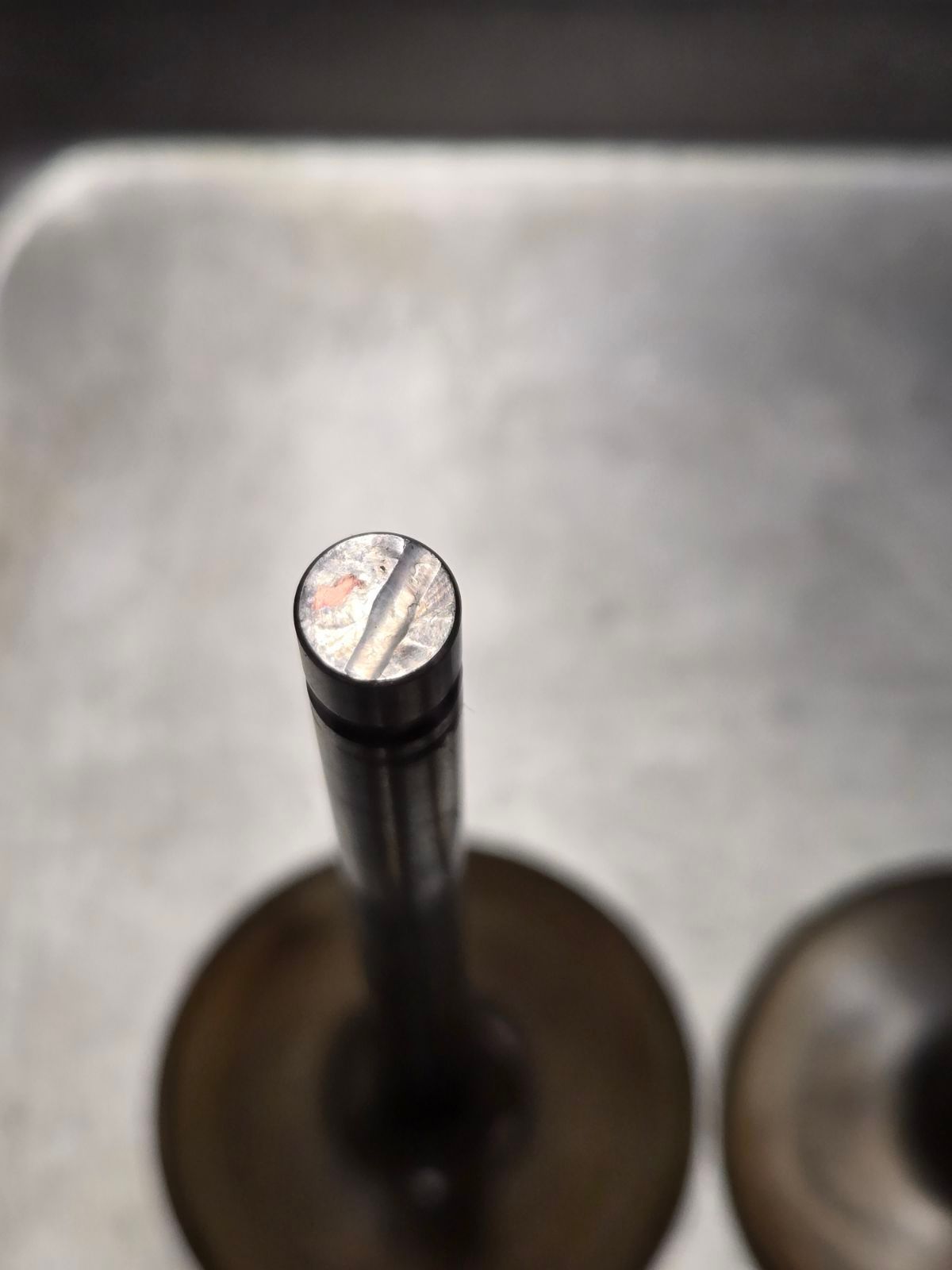

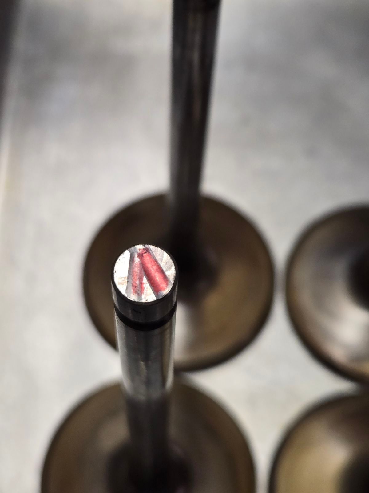

My head guy would insist on 200-225 hydraulic, 275 solid. . That bit me in the ass only once with comp lifters that couldn`t take the pressure but Johnsons should be able to handle that with an easy lobe. Otherwise I never had a single valve train issue ever.
My valves got beat up pretty good on the Bad kitty Engines.. I think probably also due to insufficient valve spring pressures or too much lash? I don`t believe the lash was checked after break in.
