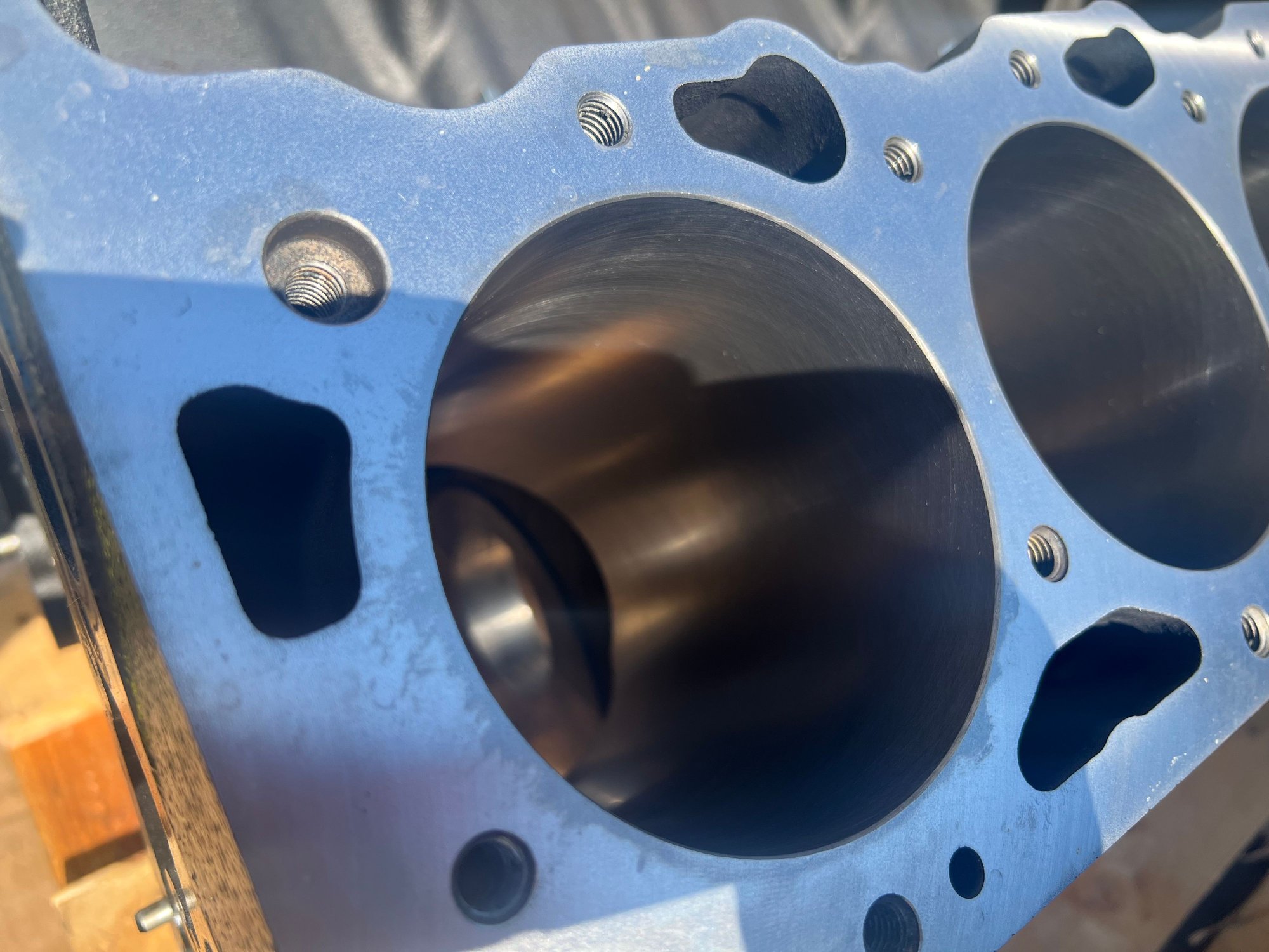

Tartilla,
Bores are plateau honed. Extremely fine finish. Machine work was done on some of the latest equipment in the industry.
Not my block, but really cool machine. It does pretty much everything. It probes the block, aligns it and goes. I didn’t get a pic of the hone, but it’s pretty cool, too.
Final home was done by spindle pressure, which means the machine detects when the hone is to size. They are all within a couple ten thousandths of an inch, and identical finishes.
I‘ve got PennOne 30w break-in oil in it right now. After about 5hrs run time, I’m going to replace it with VR-1 and the remaining PennOne (I bought a case, and used 10qts) for the next 10hrs. Then I’ll swap back to AmsOil 20w50. Probably run that for another 10hrs and change it again.
Thanks. Brad.
