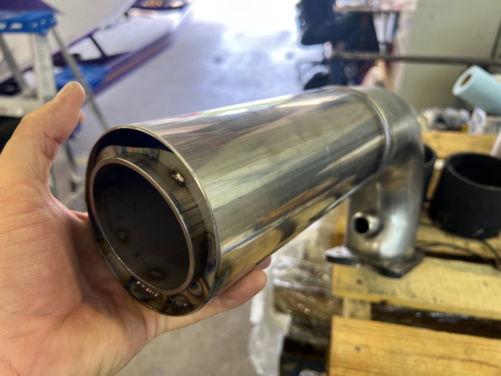

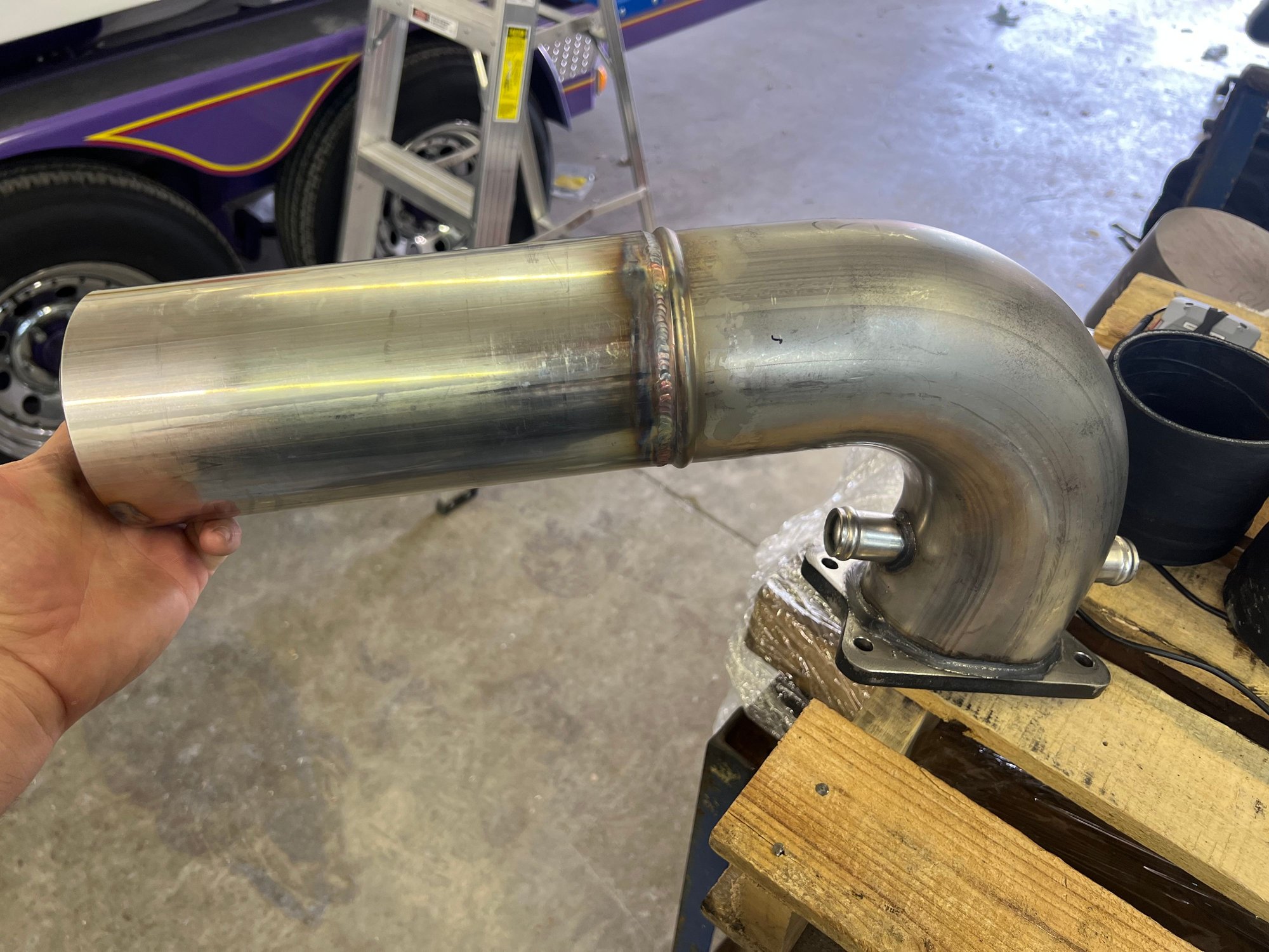

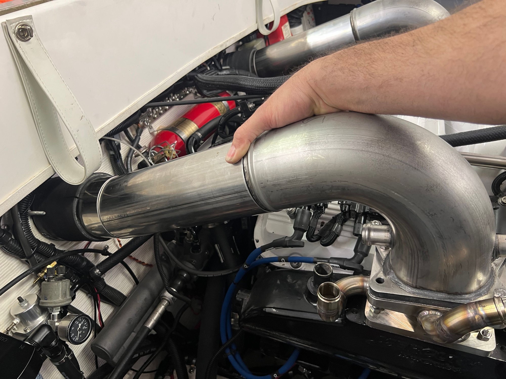

Smitty, Tartilla,
O2 Sensor Bung
O2 Sensor Bung
Does this change the context in regard to the false lean?
Thanks. Brad.
Brad Christy is offline
Old 05-26-2025 | 04:49 PM
  #626
Joined: Aug 2019
Posts: 1,250
Likes: 420
From: BC
You're a ways away from the transom. 3" risers?
The O2 sensor is a bit closer to the exh port than what most O2 sensor manfacturers would recommend. But also at the collector merge point. It's likely more a heat factor, and guys that run late timing or poor atomization...a lot of the A/F charge is burning in the port/pipe.
Smitty would best know what would be sufficient. Many ecx tails have the O2 sensor well down stream, vloser to atmosphere that has an easier time coming up the pipe. Reversion of air, not just water is also happening.
Dual 3" pipes will support a lot of HP dry, and less wet of course. That's with effectively zero pressure restriction from the pipe size.
Tartilla is offline
Old 05-26-2025 | 07:07 PM
  #627
Posts: 3,601
Likes: 1,169
From: taxachusetts
Brad
where you have it,it will work.would have liked it more towards the middle of the adapter in reference to the outside 90° pipe.
sutphen 30 is offline
Old 05-26-2025 | 09:54 PM
  #628
Joined: Aug 2019
Posts: 1,250
Likes: 420
From: BC
Sutphen jogged my memory that you fab'd up the O2 sensor bung plate. One of the specs for install was a 10° angle down. Something like that. Likely to drip off any condensation and moisture.

Originally Posted by sutphen 30
Brad
Sutphen,
I put it where I could put it.
i can tell you, by observation of the software, the WBO2 is working beautifully.
Thanks. Brad.
Tartilla,
Somewhere here on OSO is a thread by Eddie Young, where he details how he installs an O2 bung in the side of the Merc elbow, and it’s pretty much exactly where I have it in my setup, relative to the top of the manifold, and I believe he has it pretty much square to the exhaust path. Mine is rotated around the axis of the C/L a bit, just because it was where I could squeeze it in there. I realize I’m probably getting a lot more reading from a particular cylinder than a general exhaust charge, but it is what it is.
Thanks. Brad.
