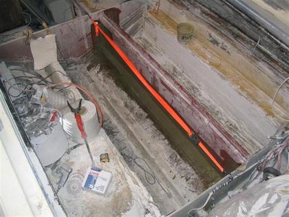

Ok today was depressing. Yesterday I cut out the old stringer. Then today I was grinding and grinding and grinding. It plain old SUCKED. I decided to grind off all the old tabbing. I did not need to but I wanted to so that I was not adding any weight. Like the 15 or so pounds would likely make a difference at this poin...... Anyhow that is what I decided to do. Tomarrow I hope to get the part above the stringer ground down and then tab the first stringer into place.

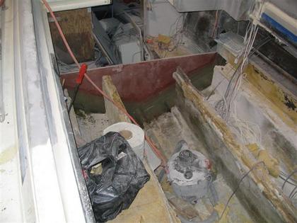

Well I got the stringer glassed in on Monday. It came out awsome and I am feeling good that I can do this now. I was worried that the amount of glassing that I had to do in such a short time was going to be a issue but I just kept moving and I got it all in before the resin kicked. I only mixed up about 1.5 - 2 qts at a time. This took almost 3.5 qts to tab this all in.

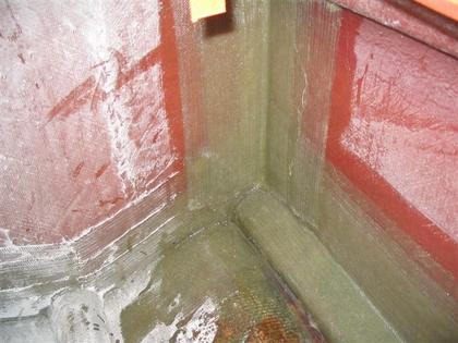

This is the front corner to the new bulkhead.
