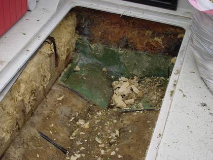

Well today I spent the day grinding. This part of the job SUCKS. I purchased a Tyvek suit, taped it at the wrists and ankles. Then I put on a hood, repirater, and safty glasses and just went to town. Took me about 4 hours of grinding and it is ready for me to make the new bulkhead. As you can see from the picture it made one heck of a mess!!!!
Jon

This is the port side grinded out.

This is the Starboard side. The hump in the middle is the drain from the bow.
