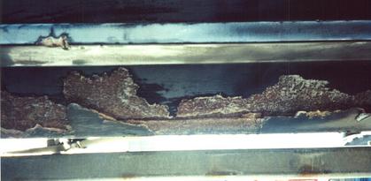

that brings back memories from when I had my keel split open about 5 years ago. the marina dropped the boat with the forklife and it fractured the keel. Well, to make a long story short they had some mickey mouse guy look at the bottom and determined the was nothing wrong with the boat.

the boat actually turned out better than new. We put in extra stringers, a new gas tank, a new bulkhead, and blue printed the bottom. I picked up 4mph.
