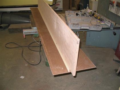

This is one of the stringers for the sides of the gas tank. I made the mistake of leaving the wood in the back of my truck and it was not flat. It took a curve sitting in the back of my truck for two weeks So I had to find a way to make it straite again. The solution that I came up with was to snap two chalk lines on a board 5/8" apart. Then I put screw holes along one and used the other as a guide. I then straitened out the wood along the lines. Worked very well for two of them but one still had a little bit of a curve on top, not a big deal as long as teh bottom is super strait. It was.

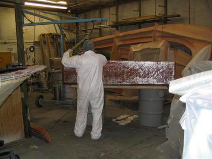

We then painted by brush the resin onto the stringer. Then put the fiberglass over the top and drapped it down the sides. After a while we realized it was going to take for ever and looked over at the chopper gun next to us We turned off the glass feed and used the resin spray to make the process take a LOT less time.

Spraying the other side.
