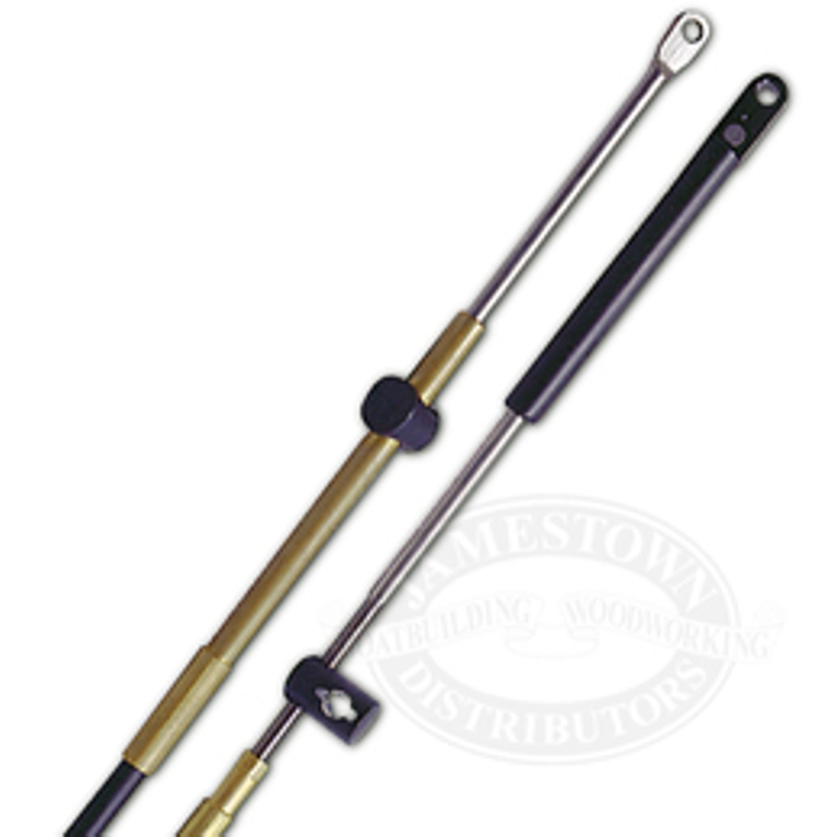

Originally Posted by Mbam
Patrcik, I am not sure what a 600A is. Can you post a picture?
Marc here is a picture of what my old cable ends look like.
The cable on the top left is what was connected to the throttle assembly. The bottom right picture is what is connected to the carburetor and transmission
Attached Thumbnails Shift/Throttle cable compatibility-600a-cable.jpg
phughes69 is offline
Old 08-10-2012 | 05:25 PM
Mbam's Avatar
Offshoreonly Advertiser
Joined: Mar 2001
Posts: 2,518
Likes: 283
From: Pompano Beach FL, USA
Patrick, you are going to need new 33C style cables and the adapters I posted a picture of previouly. Take a look at that cable reference Rookie posted, it is great!! Are you buying a new control? It will come with the ends for the control.
