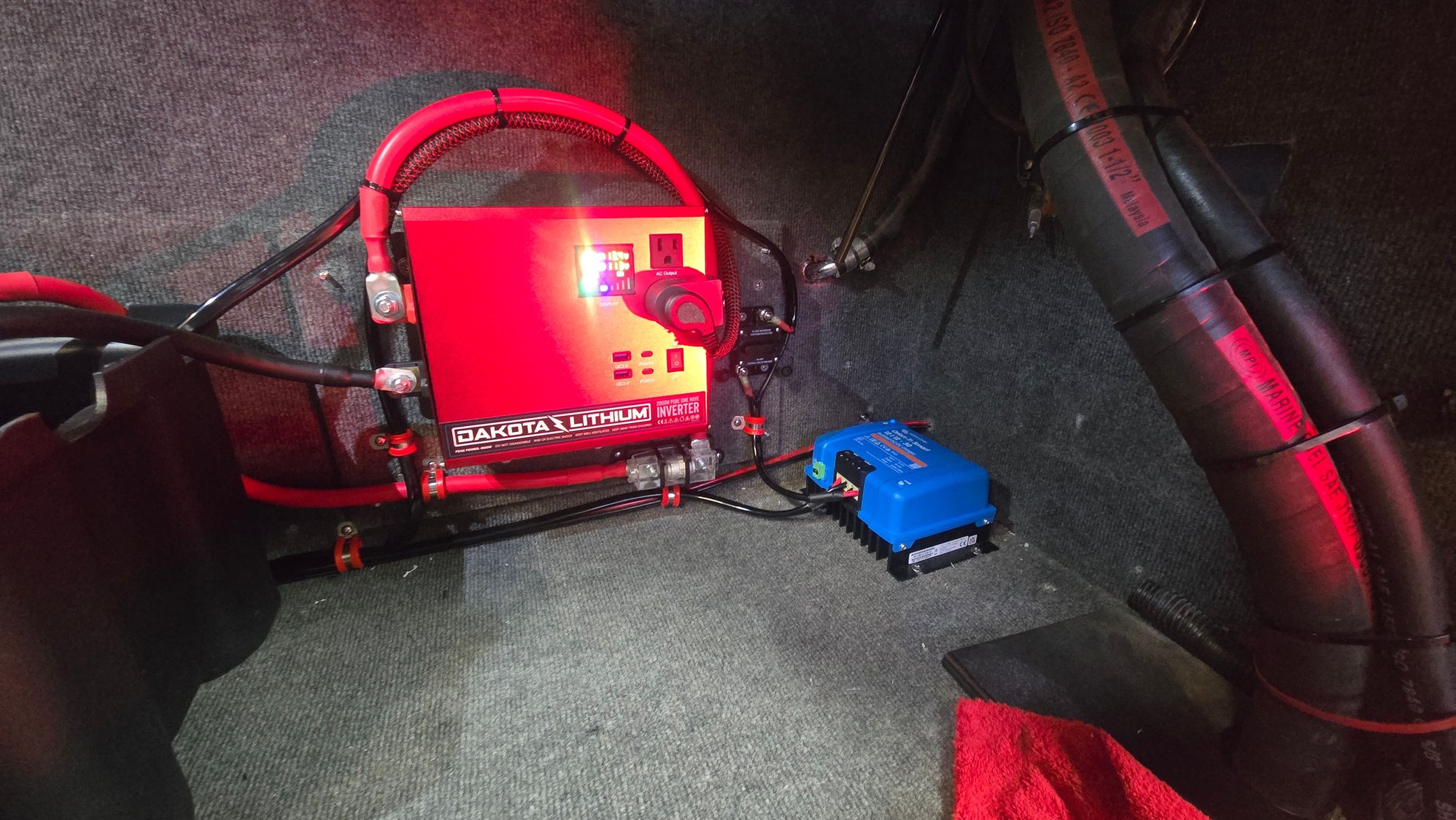

Might want to consider adding a DC to DC converter. I added one to my boat off one motor only - sends up to 50 Amps (dynamically) from deep cycle starter battery/port motor alternator to 200AH LIFEPO4 house battery. This way you can keep the fridge cold and AC going while under way and not discharge house battery until engine turned off. IT's been working great (so far).
Great minds think alike
