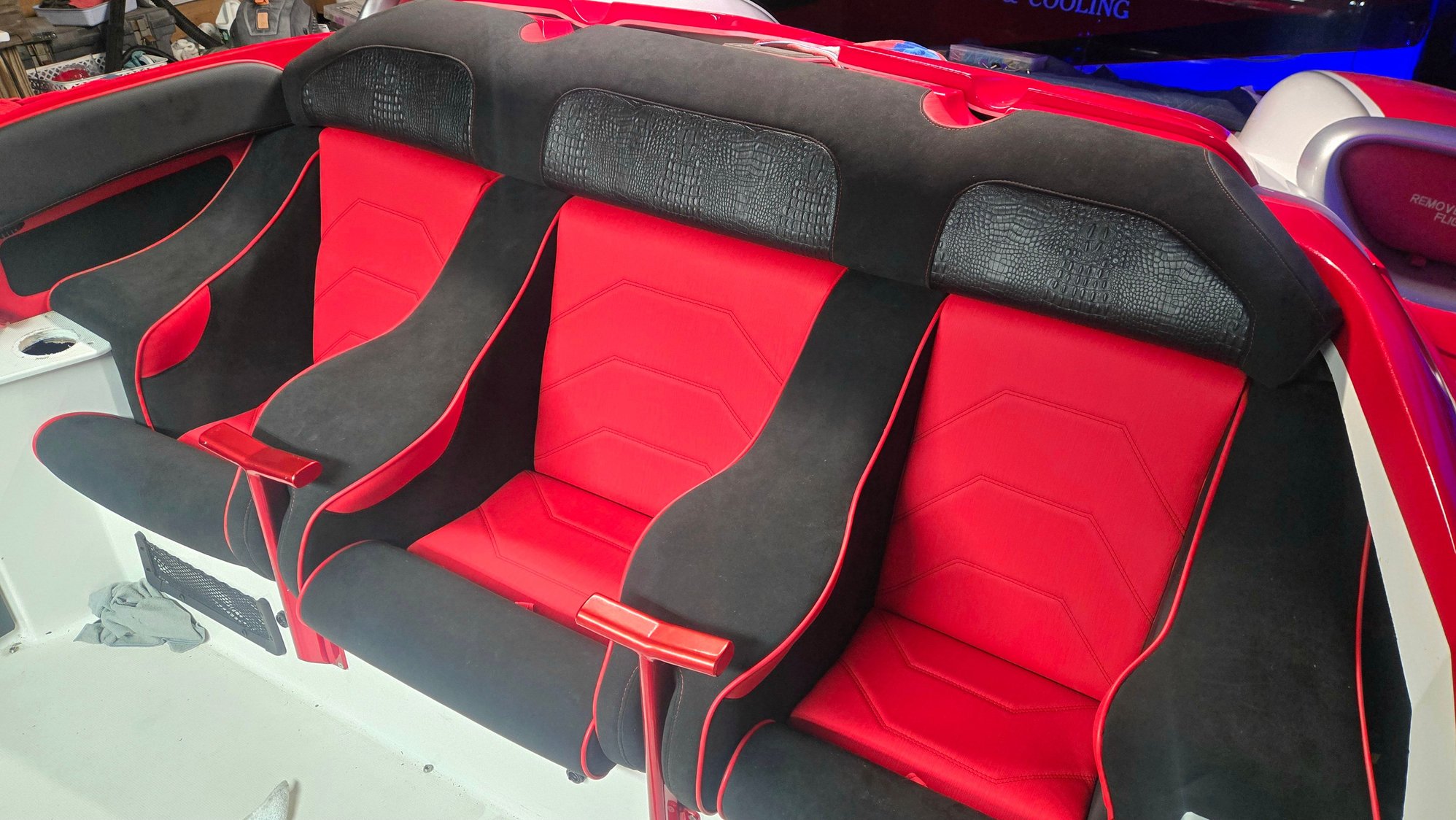

AI also designed my seats .
I executed the design.
Came out great.
ICDEDPPL is offline
