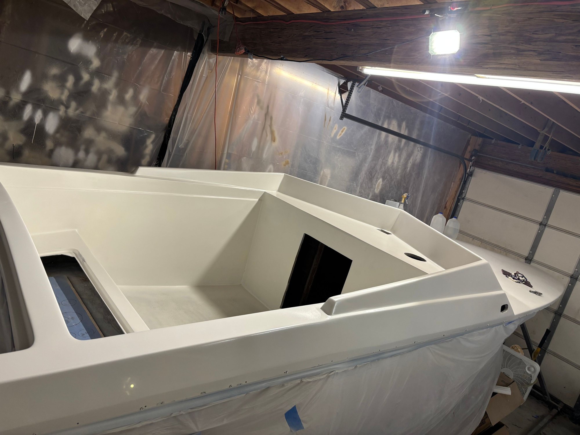

How was the awlgrip spraying? I have rolled it but had to spend a lot of time back dragging it. Stuffs strong when it's cured. Nice work
i only sprayed it because i bought all the spray converters etc but if i were to do again id roll it. Its too tight of and area to spray and look good and it all runs to the keel. Itll work for a race boat thought well see how it cures up.

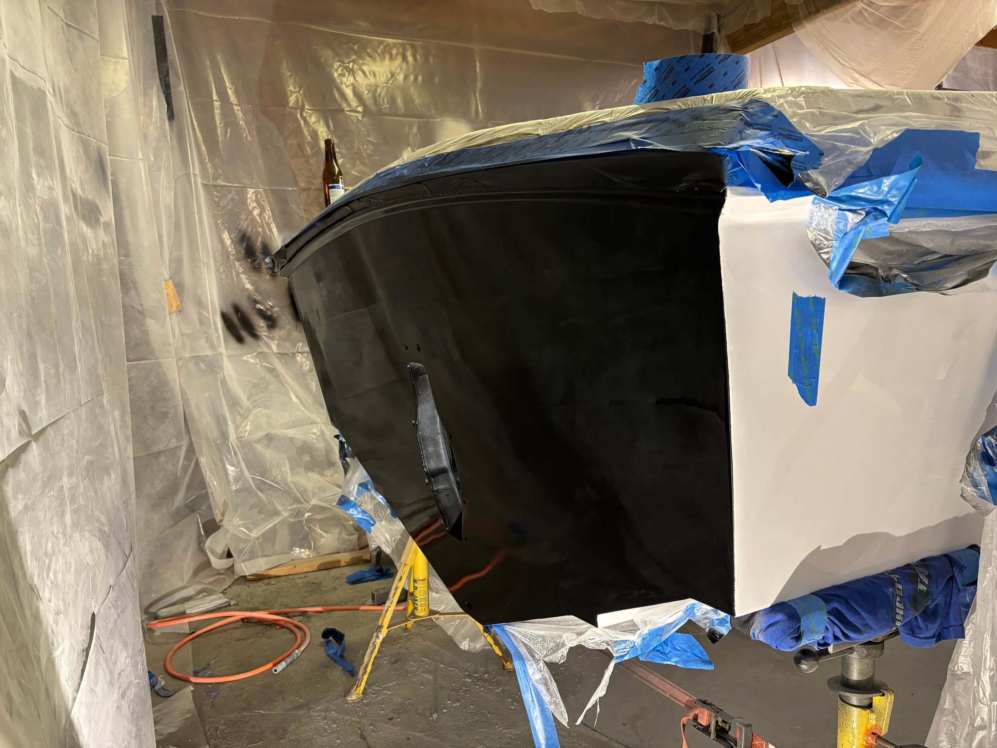

Transom painted. Went black to break it up came out decent. Time to start rigging it!
Sanded and buffed it. Awlcraft se with 3000 clear over it. Reflection test

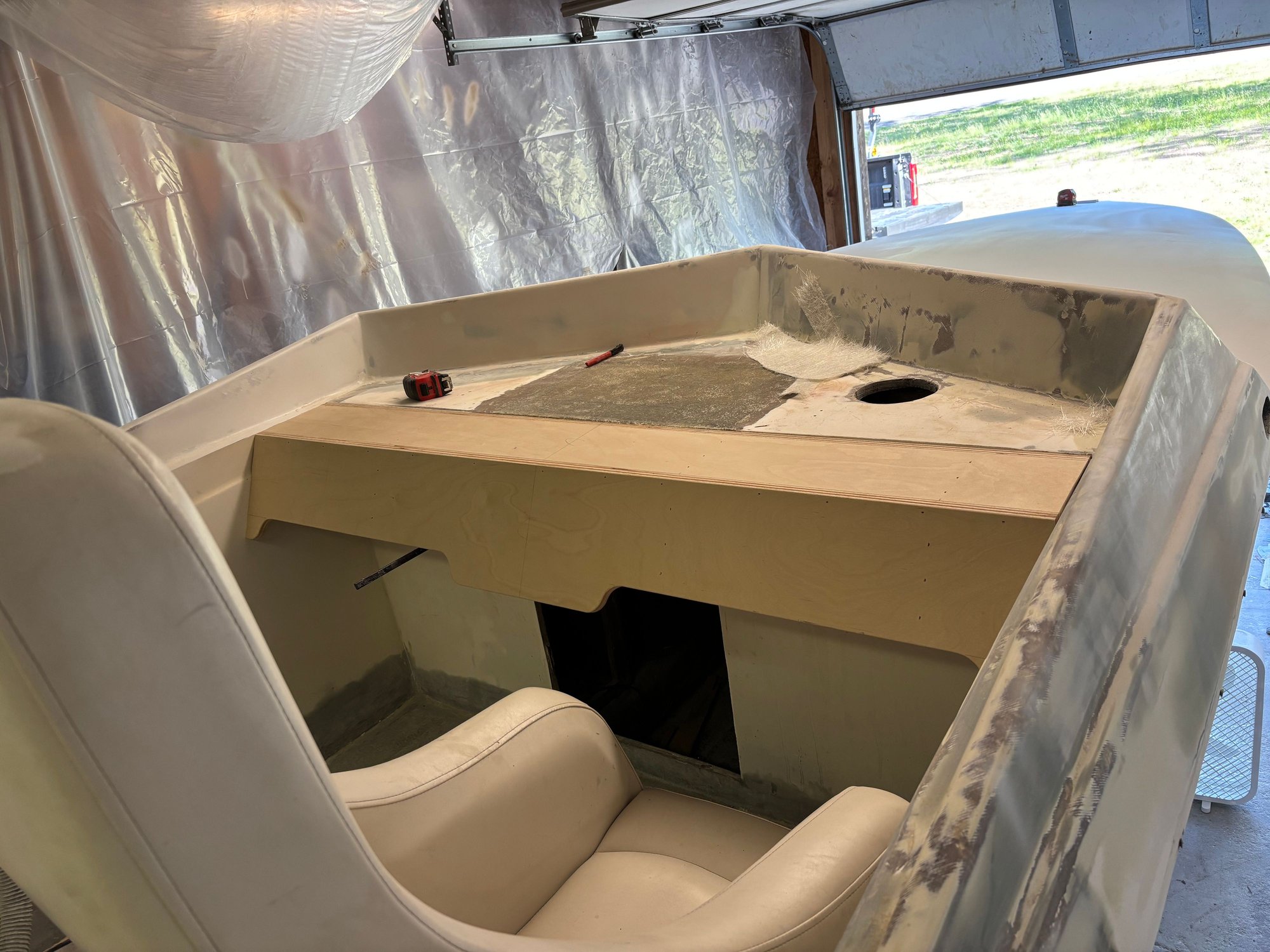

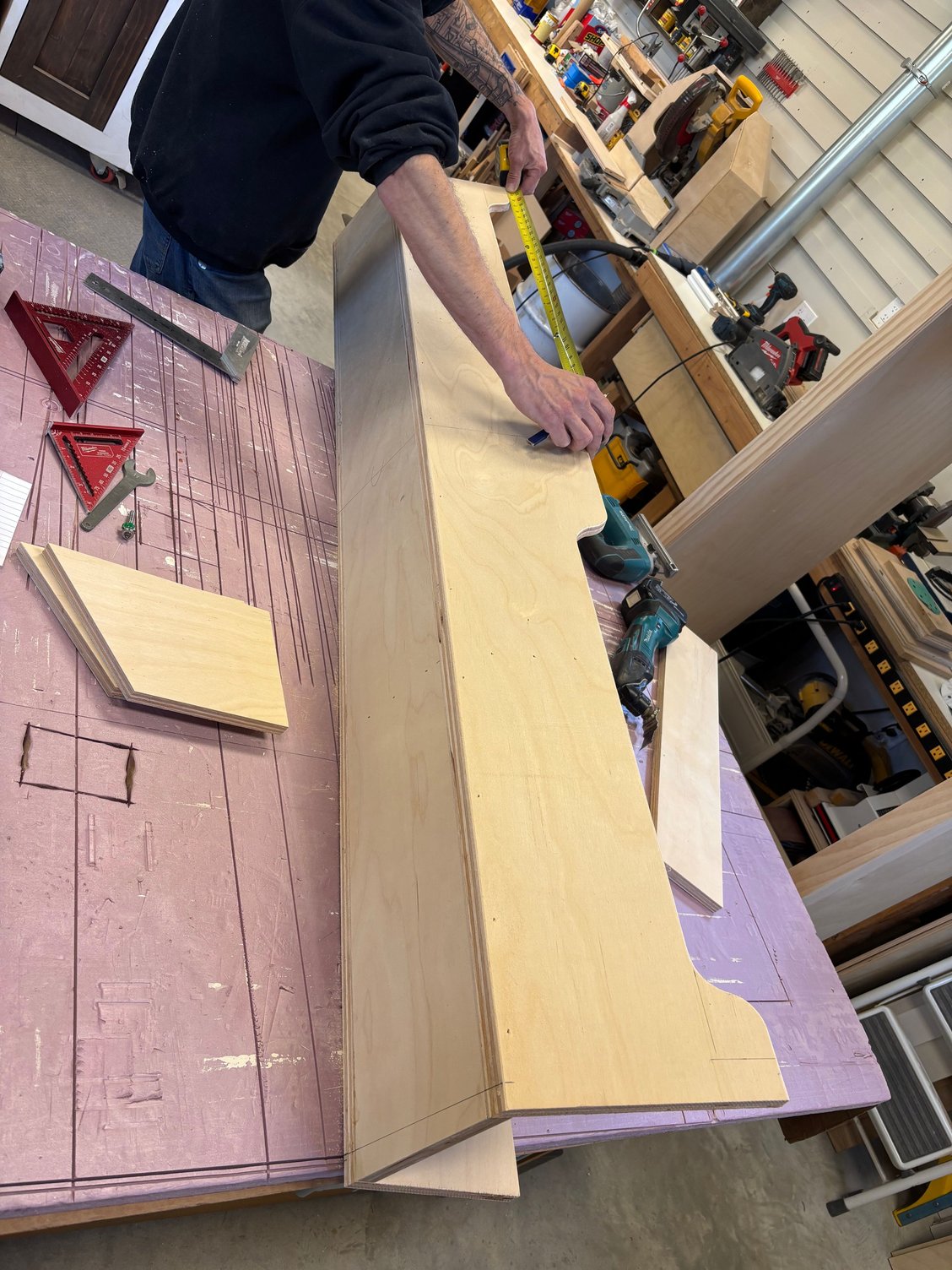

Dash made by the trim king himself Nick. This boat is no where near square and on some goofy angles. Guy took a few measurements on scratch paper and made this at his house in an hour dropped right in. Guys a wood wizard. Primer got laid down on everything after this dash will be glassed and painted.

What is that hole on top of the dash for?
the old compass was there. Still deciding how the top will be and if were putting one back in or not.

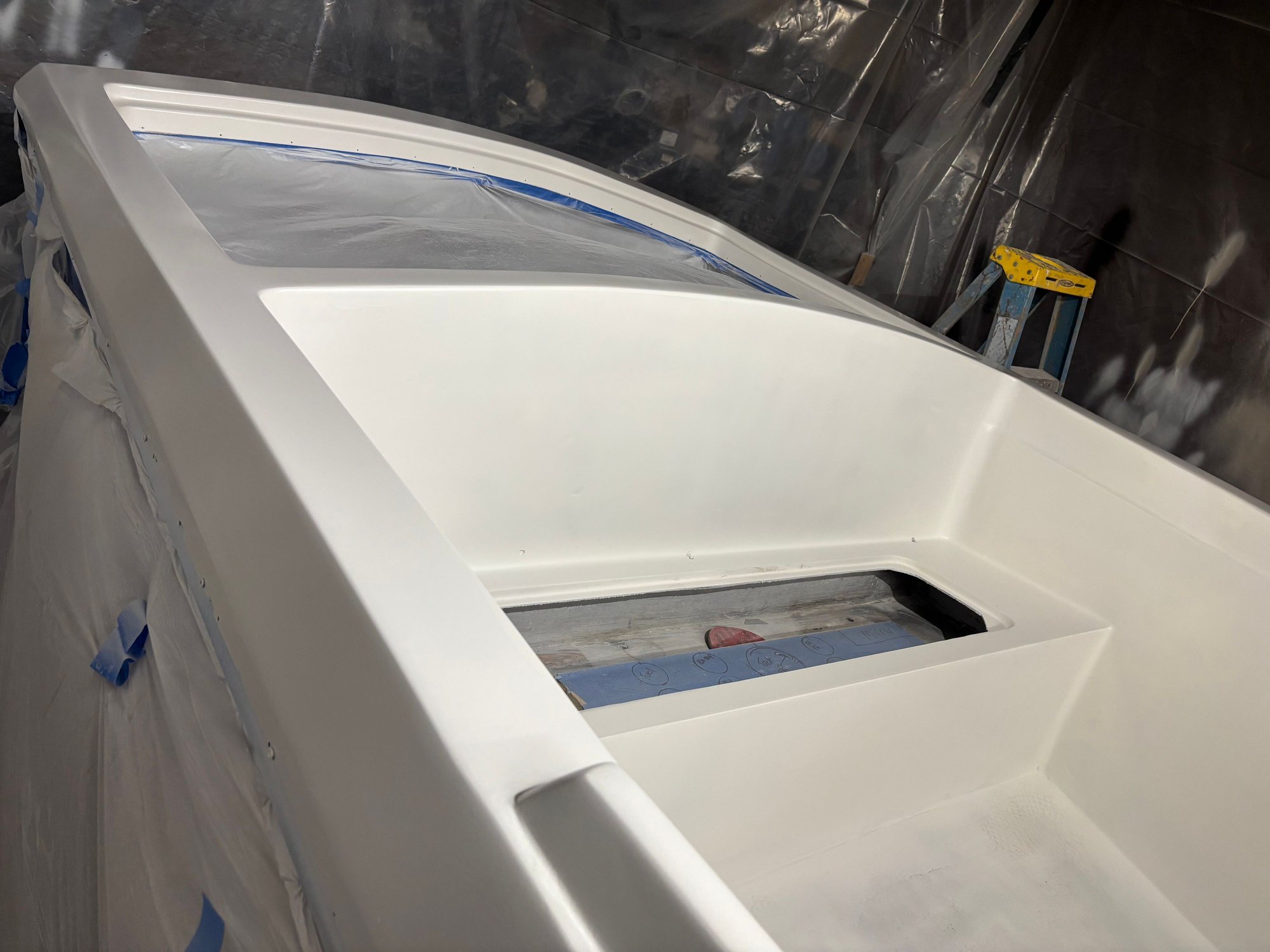

All in finish primer sanding today and final paint tomorrow
