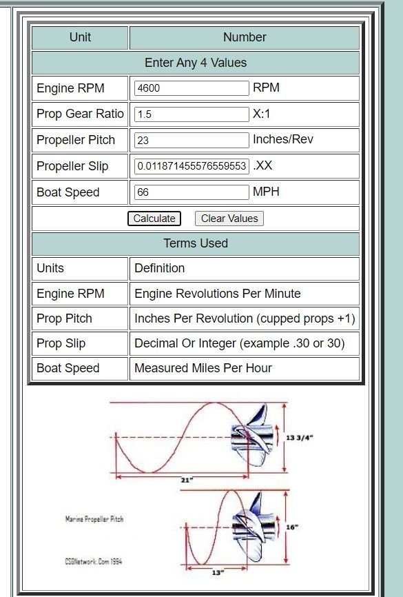

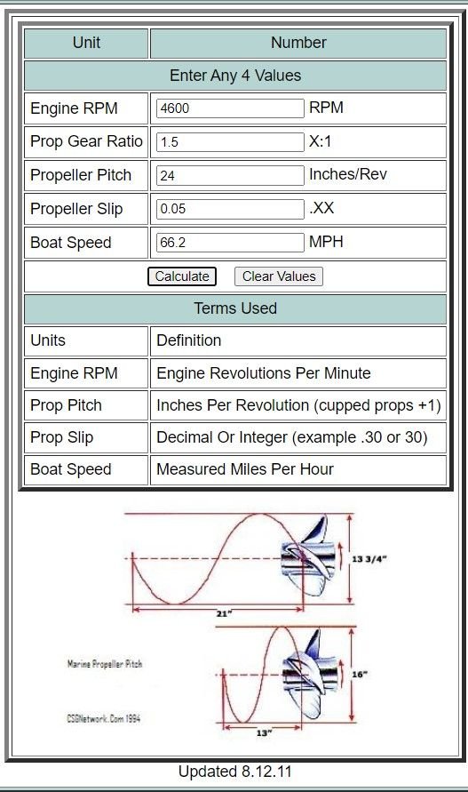

Originally Posted by bajaman
Well...assuming your tach is right and your prop hasn't had some work done to it...you're already running at over 95% efficiency, e.g. only 5% prop slip, which is...remarkable. My Baja 208 ran similar speeds but was 400 rpm or more higher. The hulls ARE pretty efficient...but the way you have it all hooked up, I'd be hesitant to mess with it!
what happens if you put 23” into the equation as many say Bravo props are typically 1” less than stated.

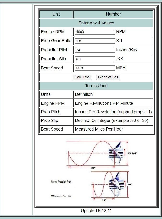

Would be 1% prop slip...keeping the 66 mph as a constant.
My guess is that the tach is off a bit and the engine is actually running a higher rpm. GPS doesn't lie and we know a TEN percent prop slip is much more realistic, as a minimum:
