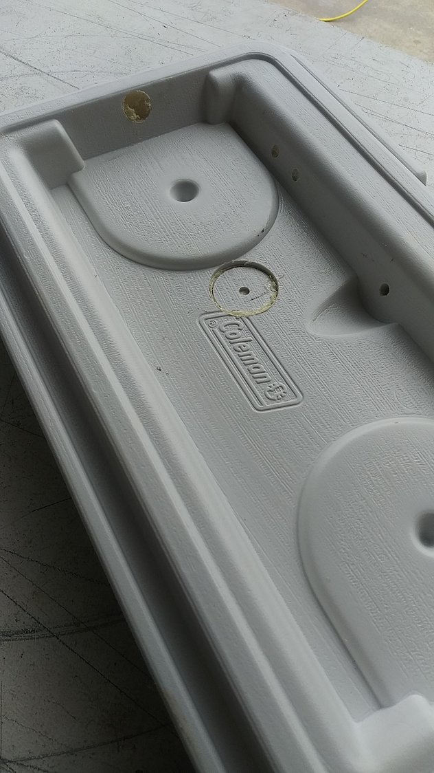

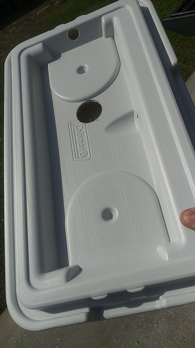

beer cooler is perfect centerconsole height, the dam thing has no foam in the lid and you cant step on it like my other one.

Helped my buddy with his gas tank, some foam found its way into the cooler lid.
