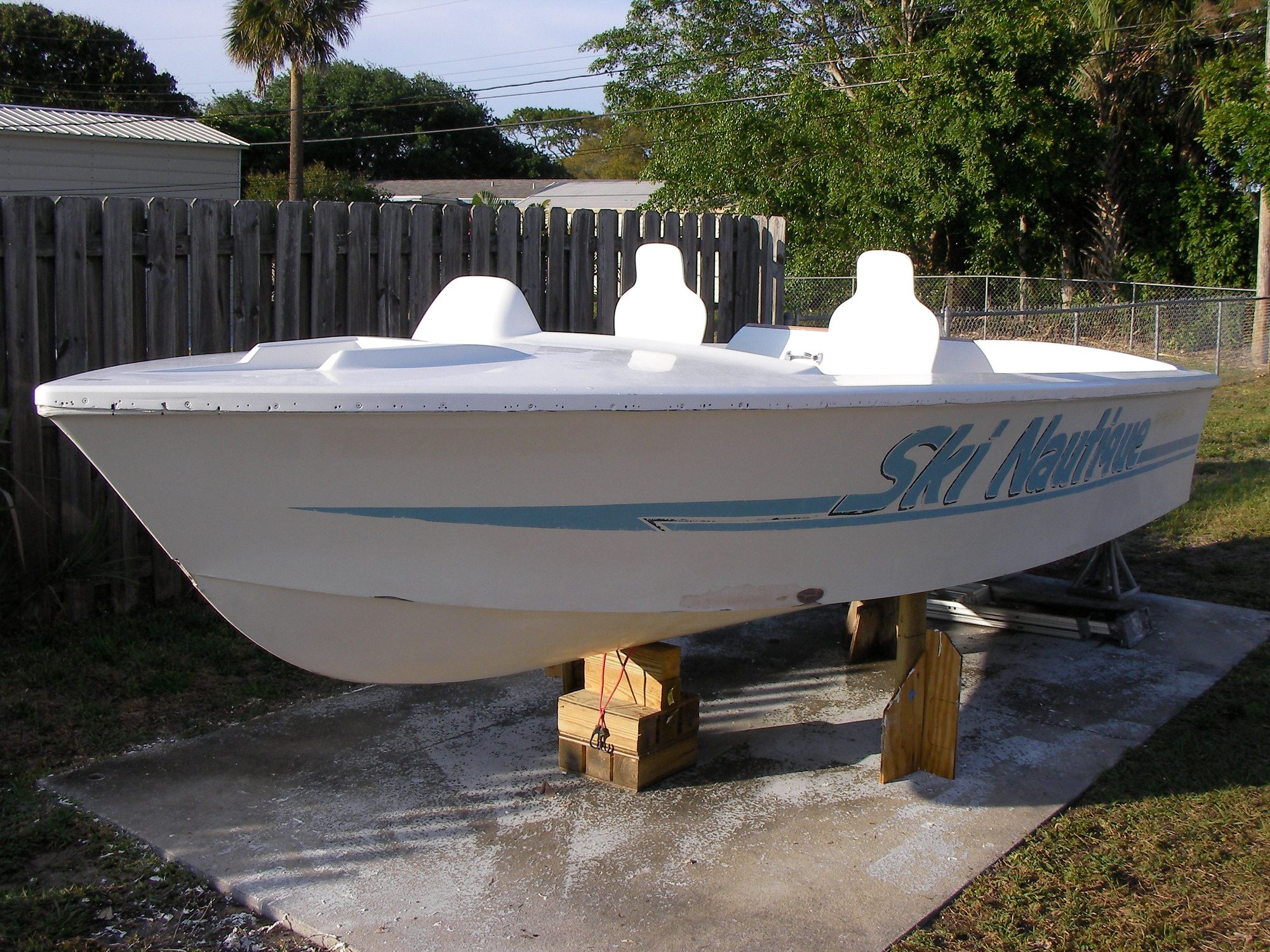

Hell yeah wildman, ski, board, tube, crack the whip you name it. Both seats can turn and face the back, check out page 7.

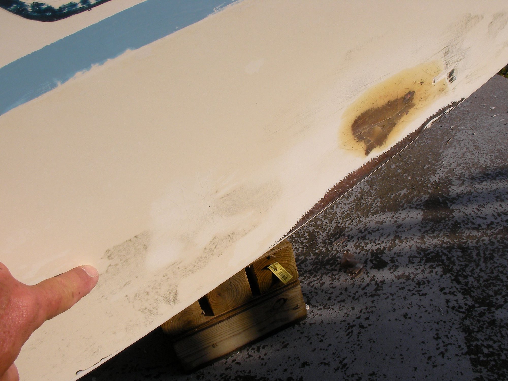

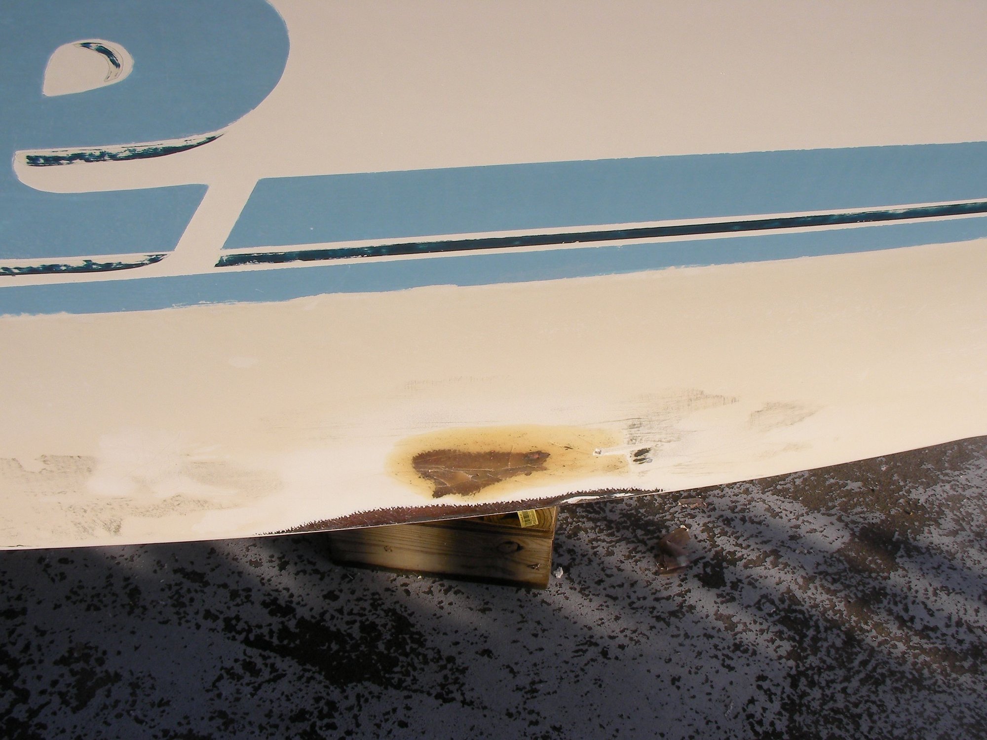

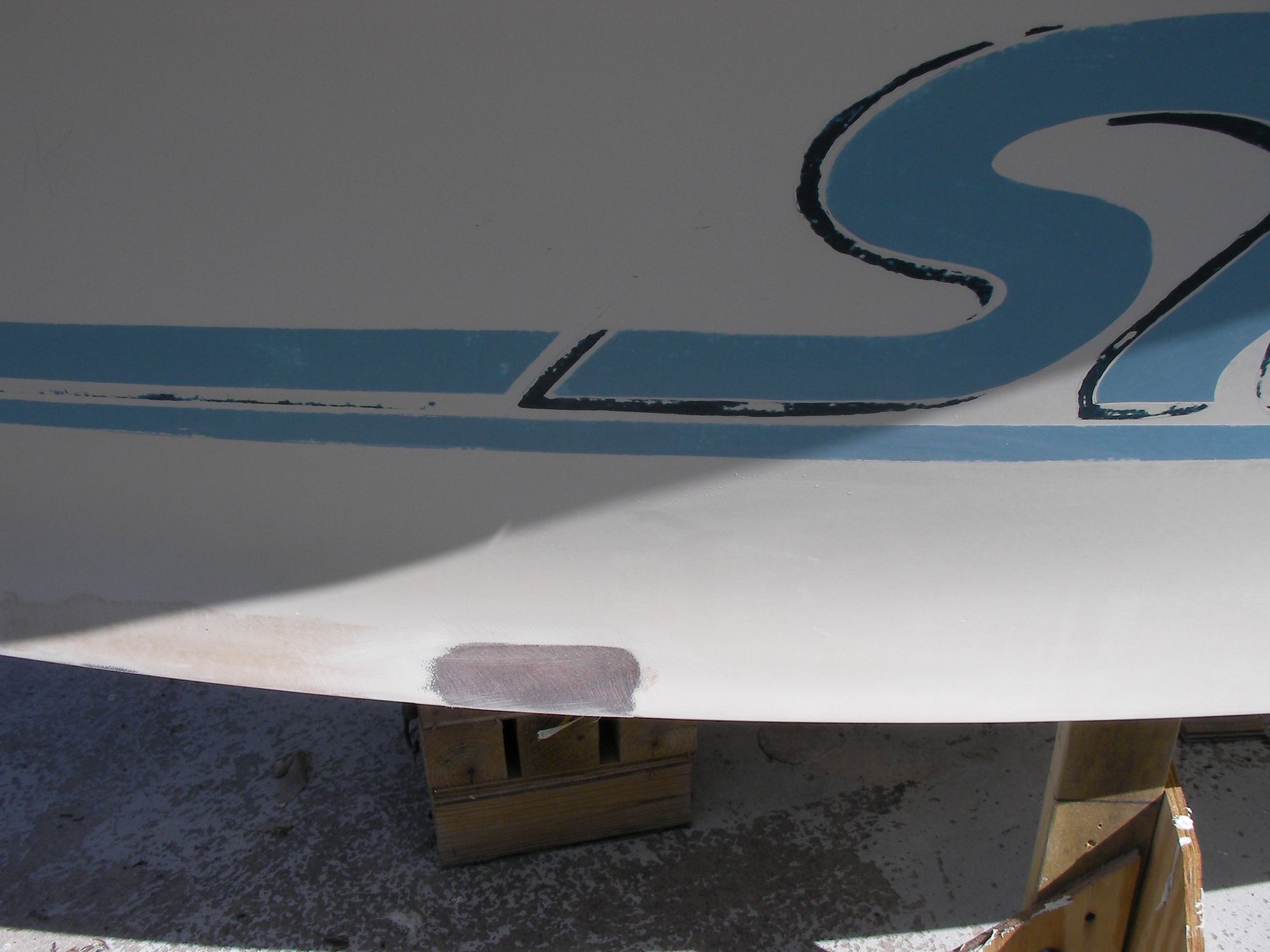

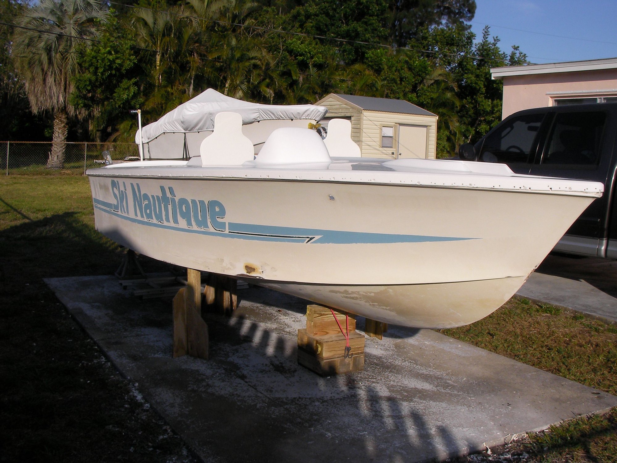

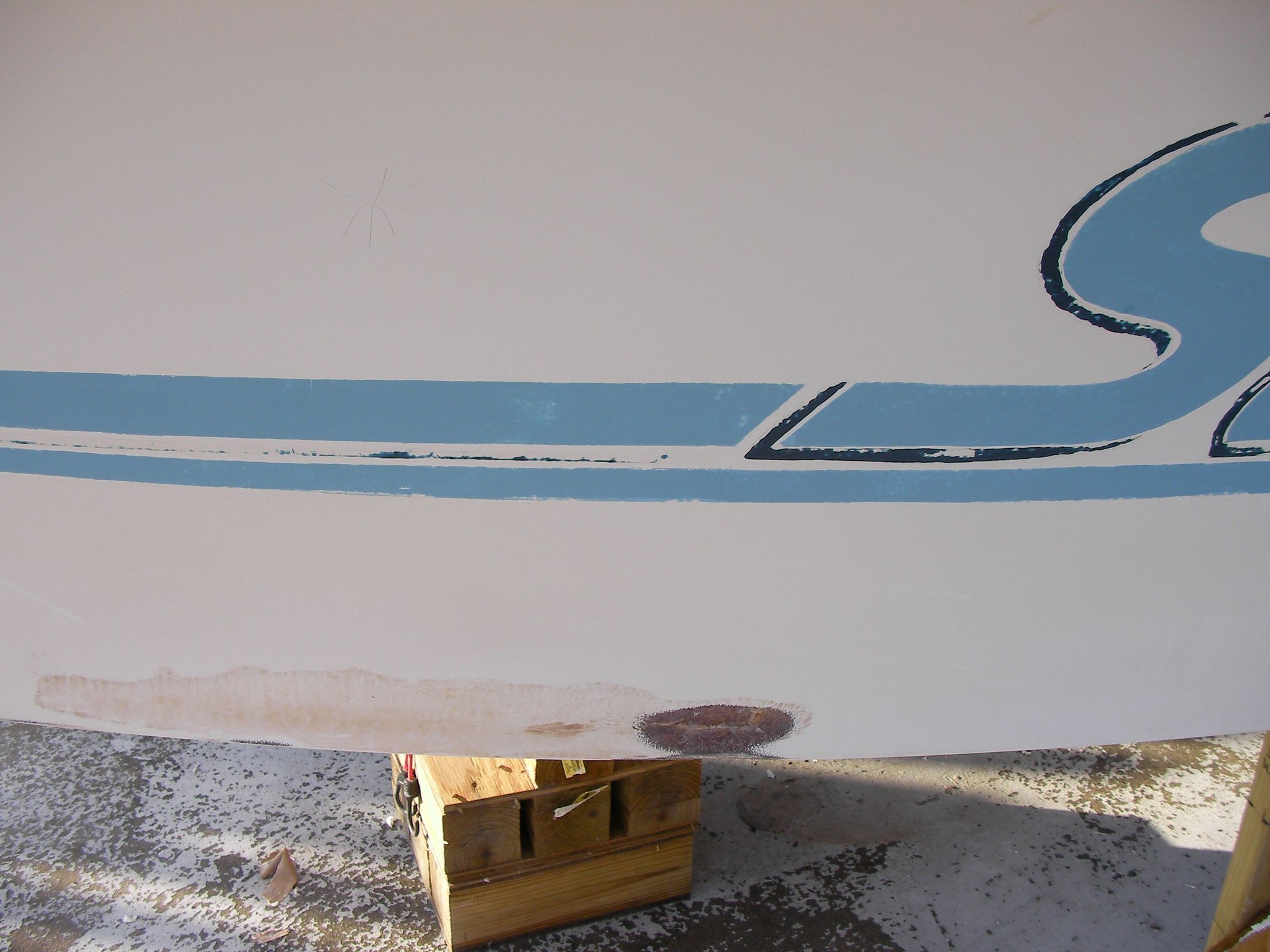

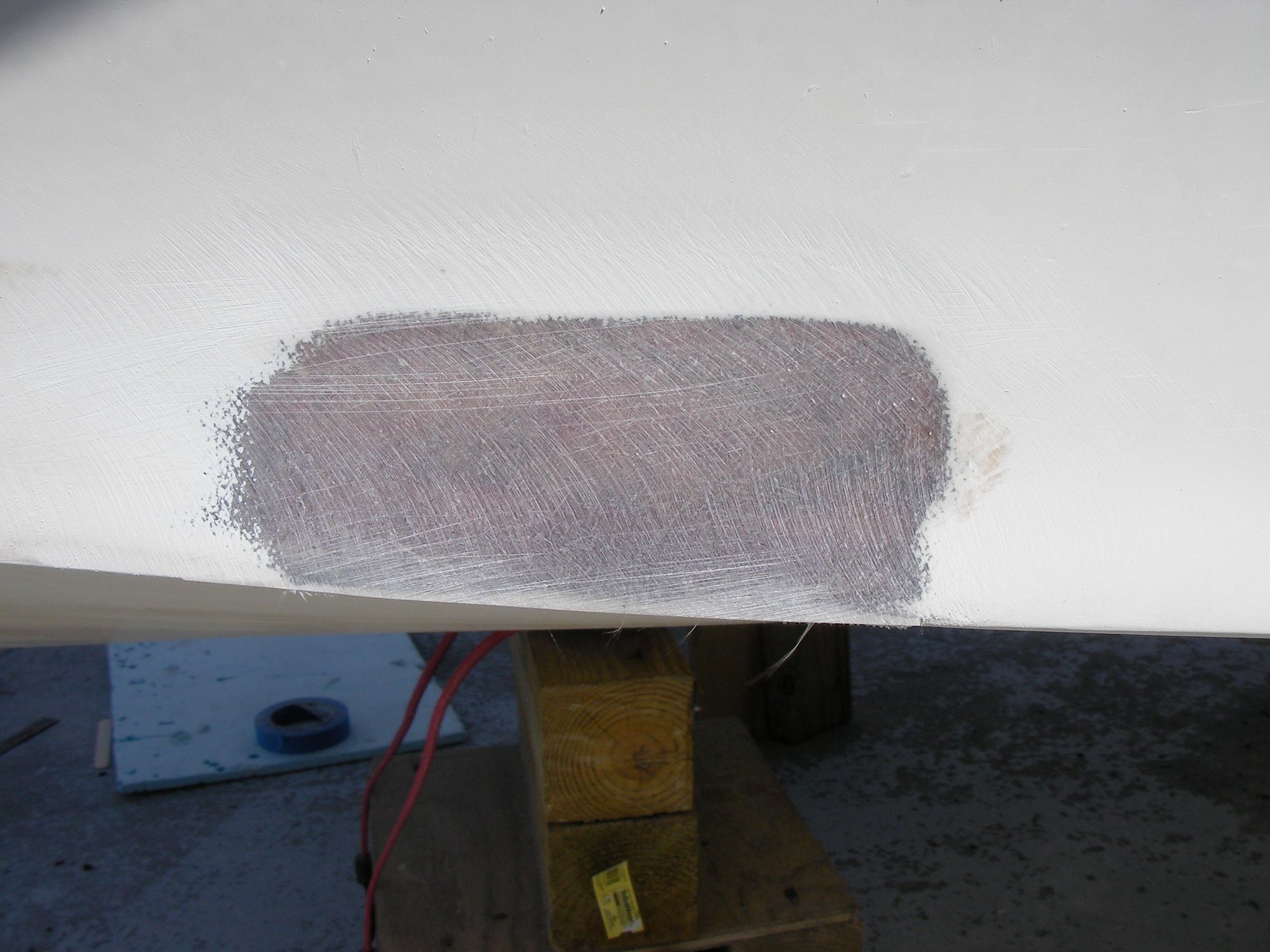

I can honestly report that GE 100 % silicone (the window tub and door exterior stuff) when swiped on a hullside, covered with bondo covered with marinetex primed painted, primed and painted again remains flexible and has excellent adhesion properties.
that's right sports fans ge 100% silicone. I knew there was 3 spots that had been repaired, and when the hull was gutted there was nothing to indicate on the inside the damage came thru or leaked. With a spotlight on the outside you could see it was gouges.
the repairs looked like some 14 year old kid was trying to cover up what he did before his parents came home.
patince paid off, paint strpper and razor blades got the hullsides from the blue stripe and down back to gelcoat.
it also removed the red bondo on the right side and the brown bondo on the left side, so a little grinding in just those areas and some tore up mat it'll be back in business.
the repairs and paint were done over brown scummy water stains.
except for what looks like using the boat to ram the trailer, 42 years of neglect, abuse and the work/maintenance completed by Big Jimbo down at uncle jim bob's airboat tours gator rasellin and marine repairs the hull is cleaning up nice.
i'd rather it wore 42 year old gelcoat than that paint job.
i have also come to conclusion that either colonel steve austin with his bionic strenght and speed or samarui night fever taped off the lettering down the hullsides because the razor marks in the gelcoat are almost as bad as the gouges from whatever they hit.
swear to god if the lettering was removed the thing would look like it lost a knife fight.

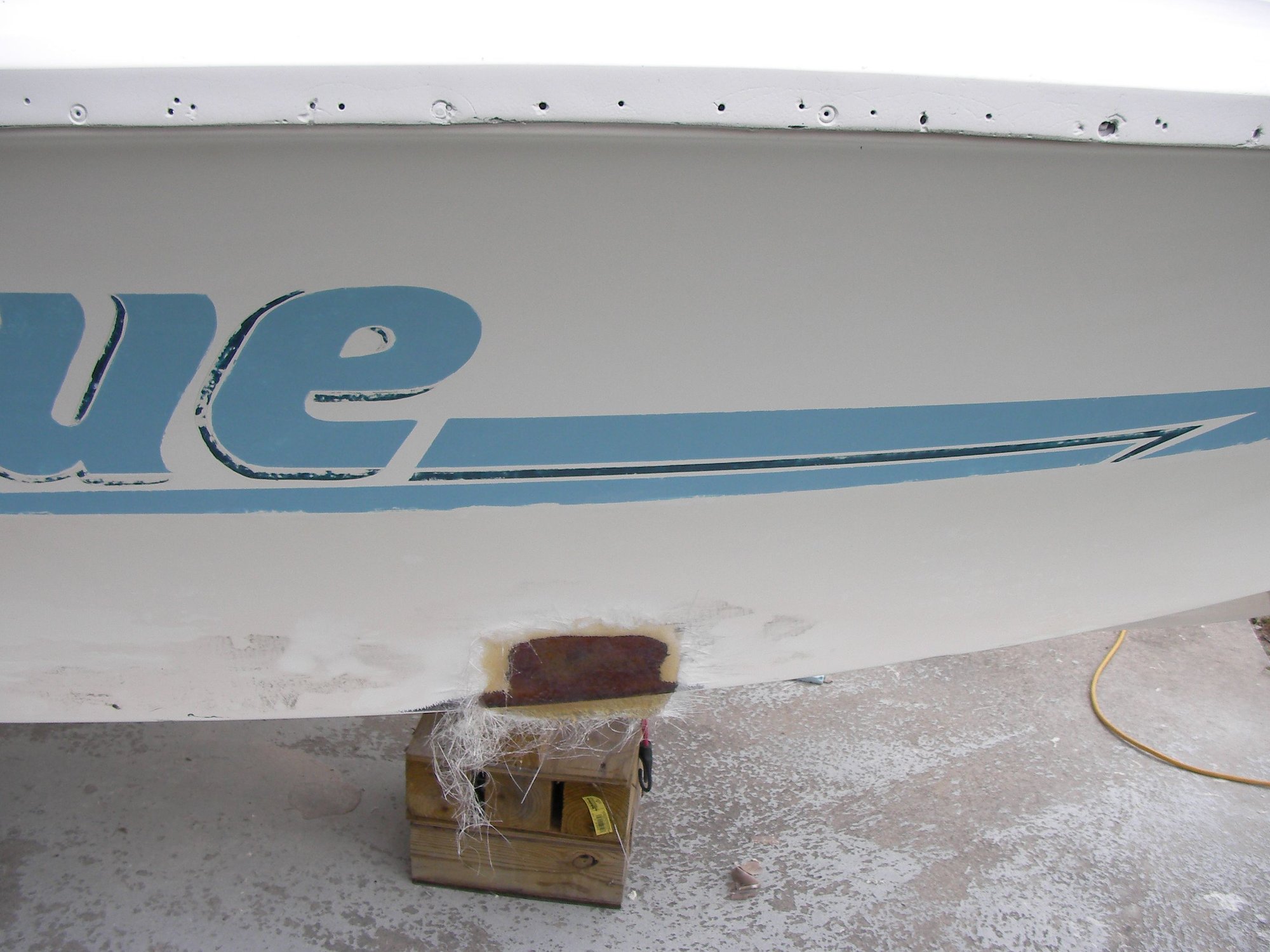

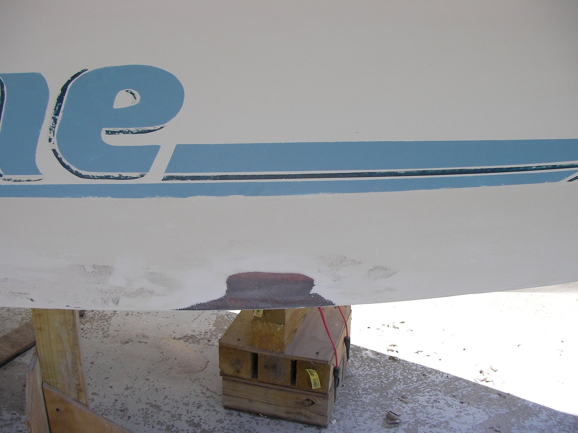

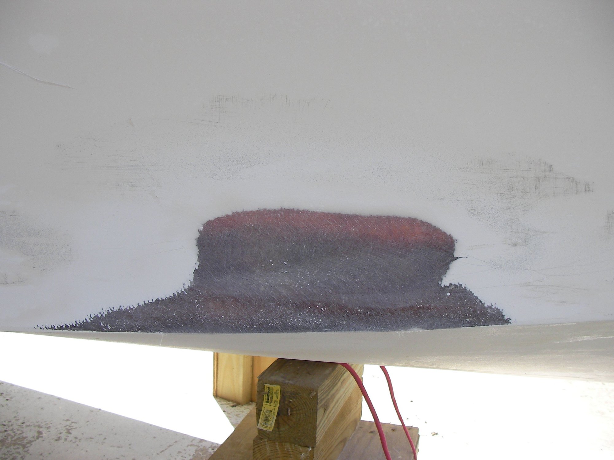

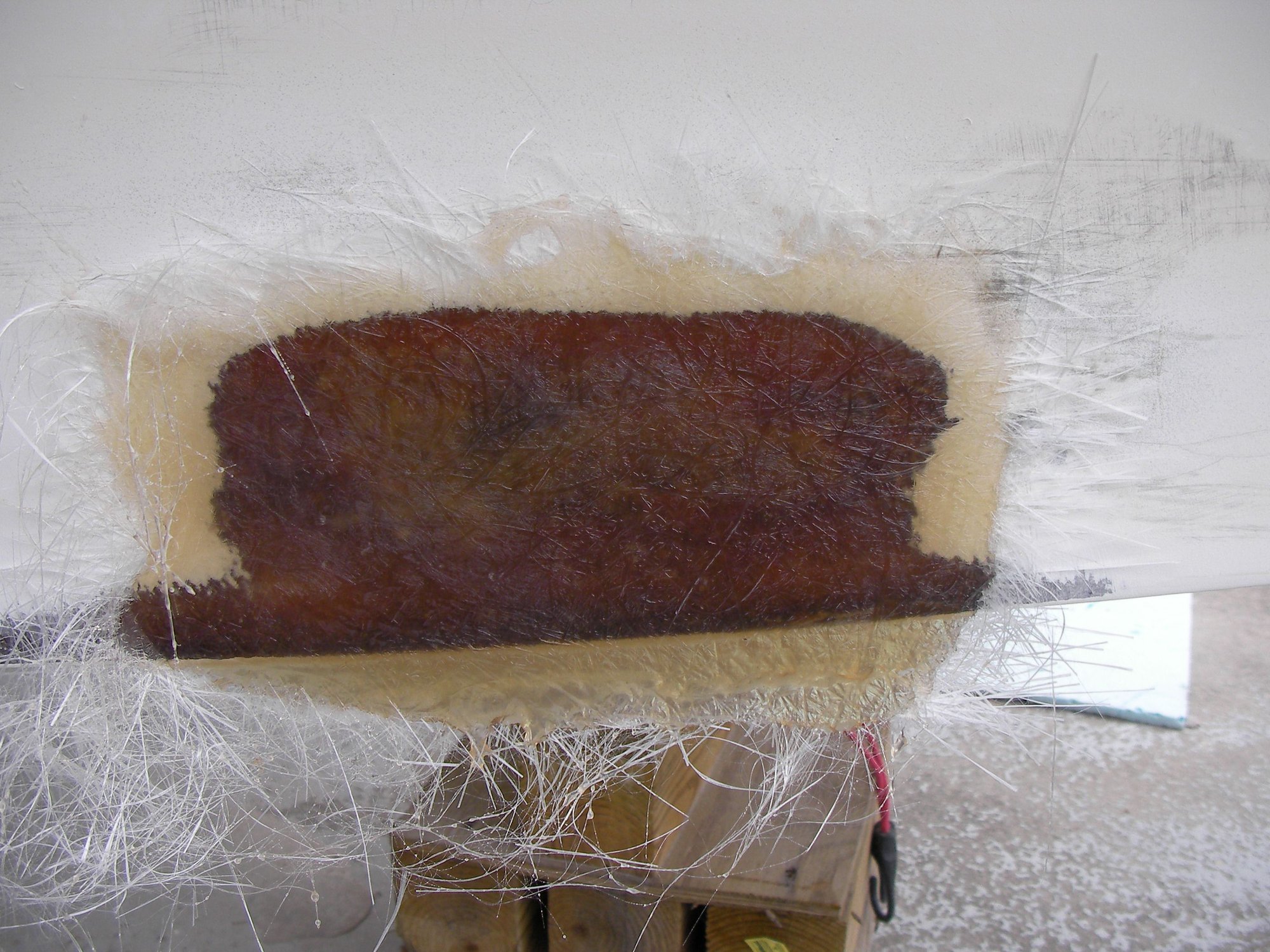

there is something like 7 layers on the port and 9 on the starb. The pieces get progressively smaller after the first 3 layers to build back up the deep part of the repair .
Both sides look to be built up enough to grind the countour back in.
going out on a limb and guessing even chopped strand mat bubble rolled out real good might, maybe, possibly have 1/2 the structural integrity as swiped silicone covered with bondo, but that silicone really grabbed on and remained flexible.

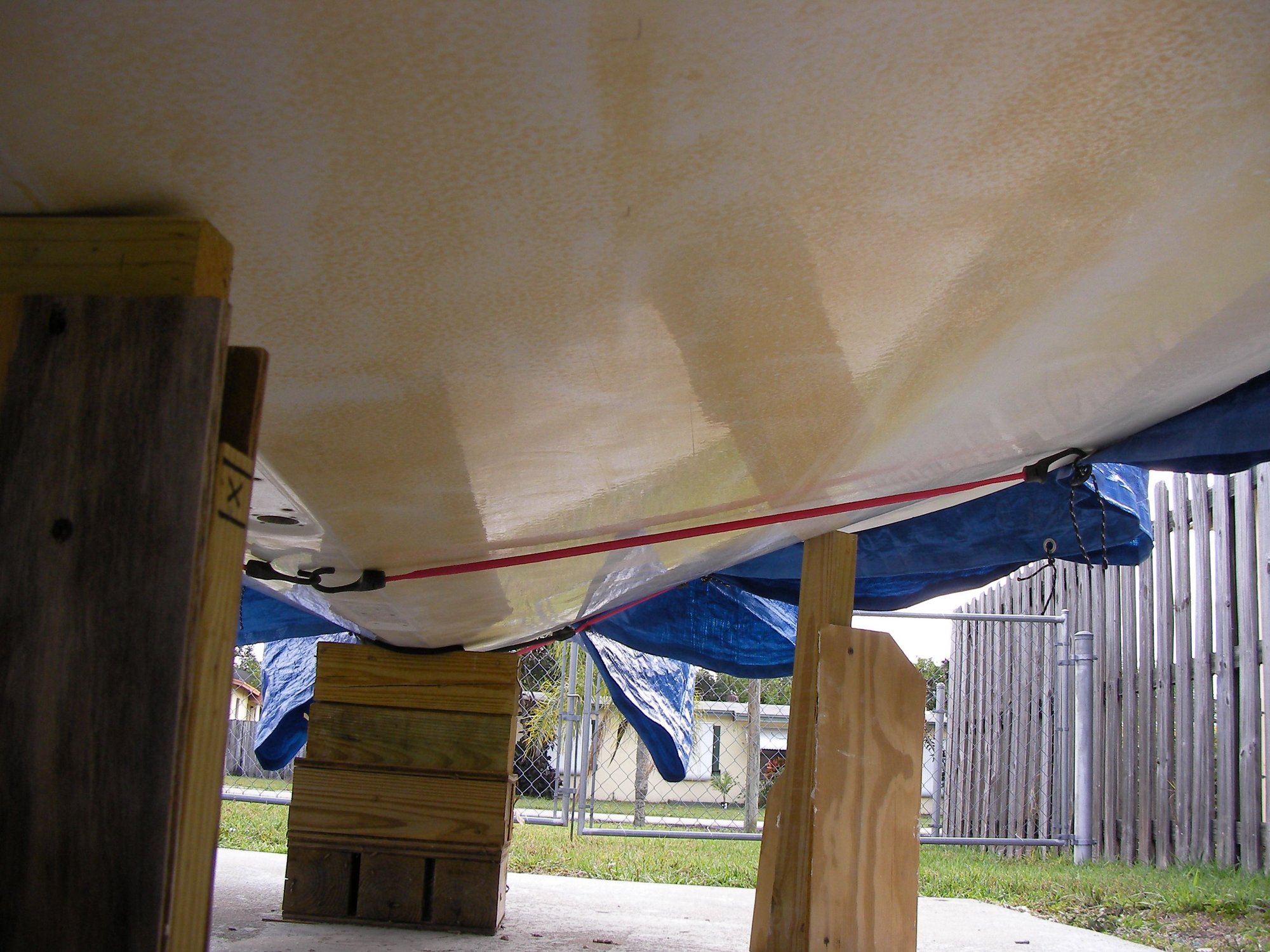

i have to partially retract and amend an earlier post where i stated the boat was never washed, ever !
It was washed to the bunks, everything below/ inside the bunks were never washed, ever !
mary kate on & off didn't touch, zero results on the brown water stains, the only water stains that were removed was from the paint remover around all the mounting pads for the underwater hardware.

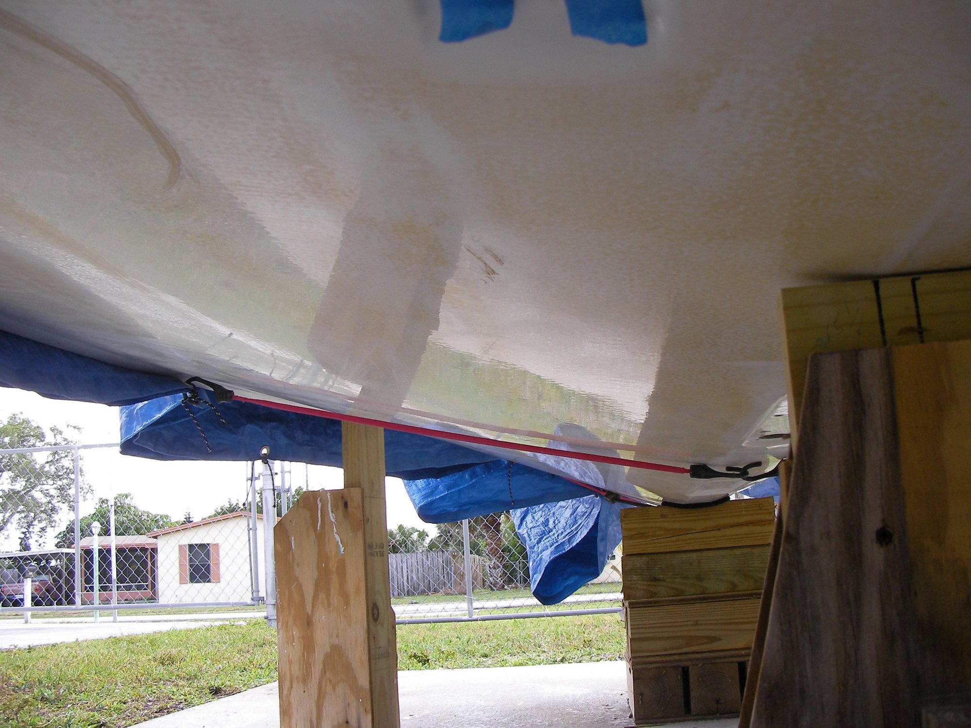

i put 1000 grit on the grinder held it flat on the hull bottom and went to town, the brown water stains came off the hi side of the print thru.
That is not blistering, that's woven roving.
the hull bottom looks like a checker board or frosted miny wheats.
