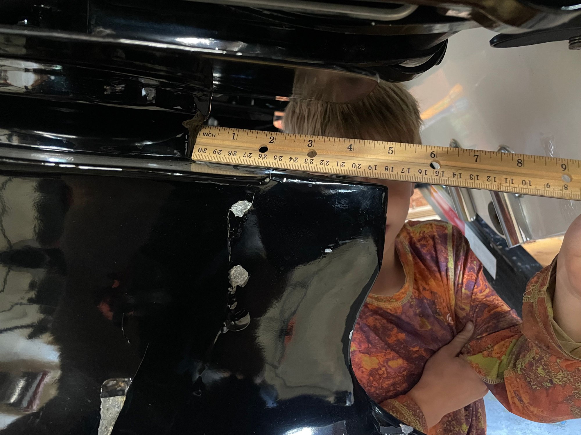

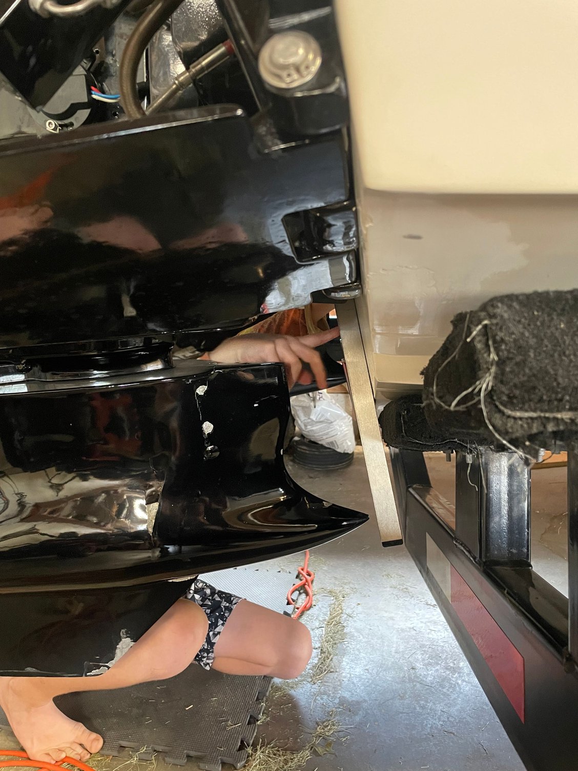

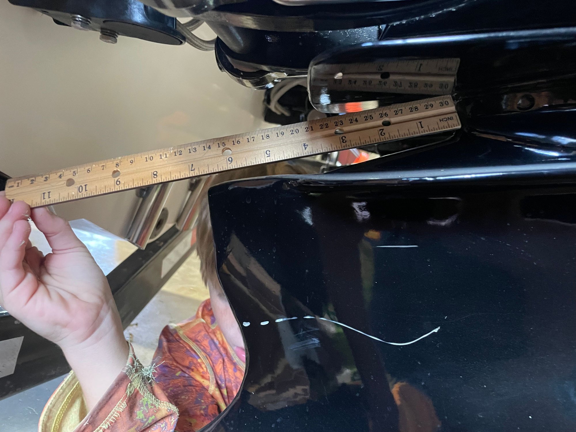

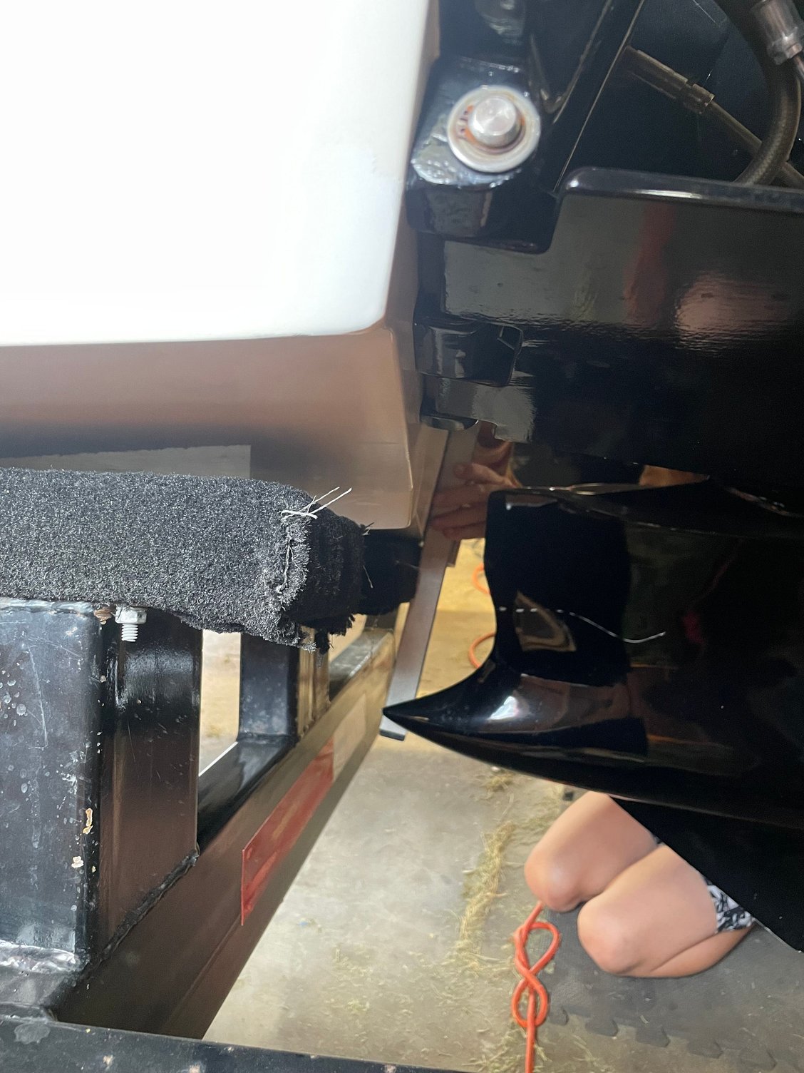

Think I found the culprit to a running list problem I had. The port side lower unit is about 1 1/2 inches forward of the starboard side. I also think the nose cones have negatively affected the ride. Not sure how I want to fix it. Either replace both complete drives with new standard bravos or maybe just the lower units. The problem is that one is like the first model bravo one design they came out with.

I wanted to repost something TeamSaris posted since there are a lot of people looking at this thread and have read about a lot of handling issues from slight modifications that other saber owners have made and for those making many changes all at once. The post is like a how-to or not-to guide as it relates to drive modfications, speeed, and props. The real takeaway though is these boats are more sensitive then many realize. They are light and narrow; subtle differences in anything on the lower unit have a huge impact. That 1 1/2 inch difference on the lowers was so bad some times the boat would drive a different direction then where the bow was pointed and the list was so bad you couldn't run past 60mph safely. The boat would be pointed at 12 oclock and be driving at 11:50; that is a weird feeling.
