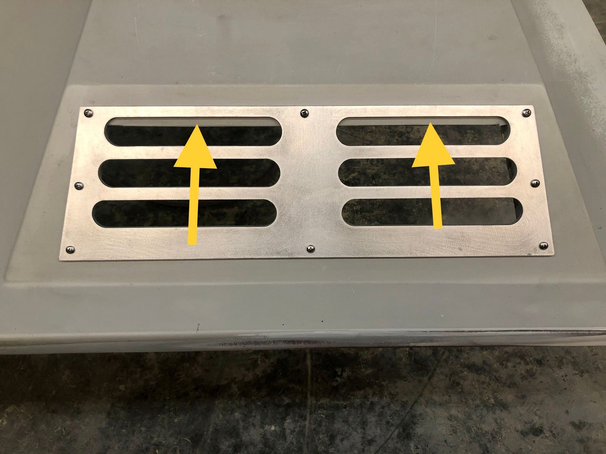

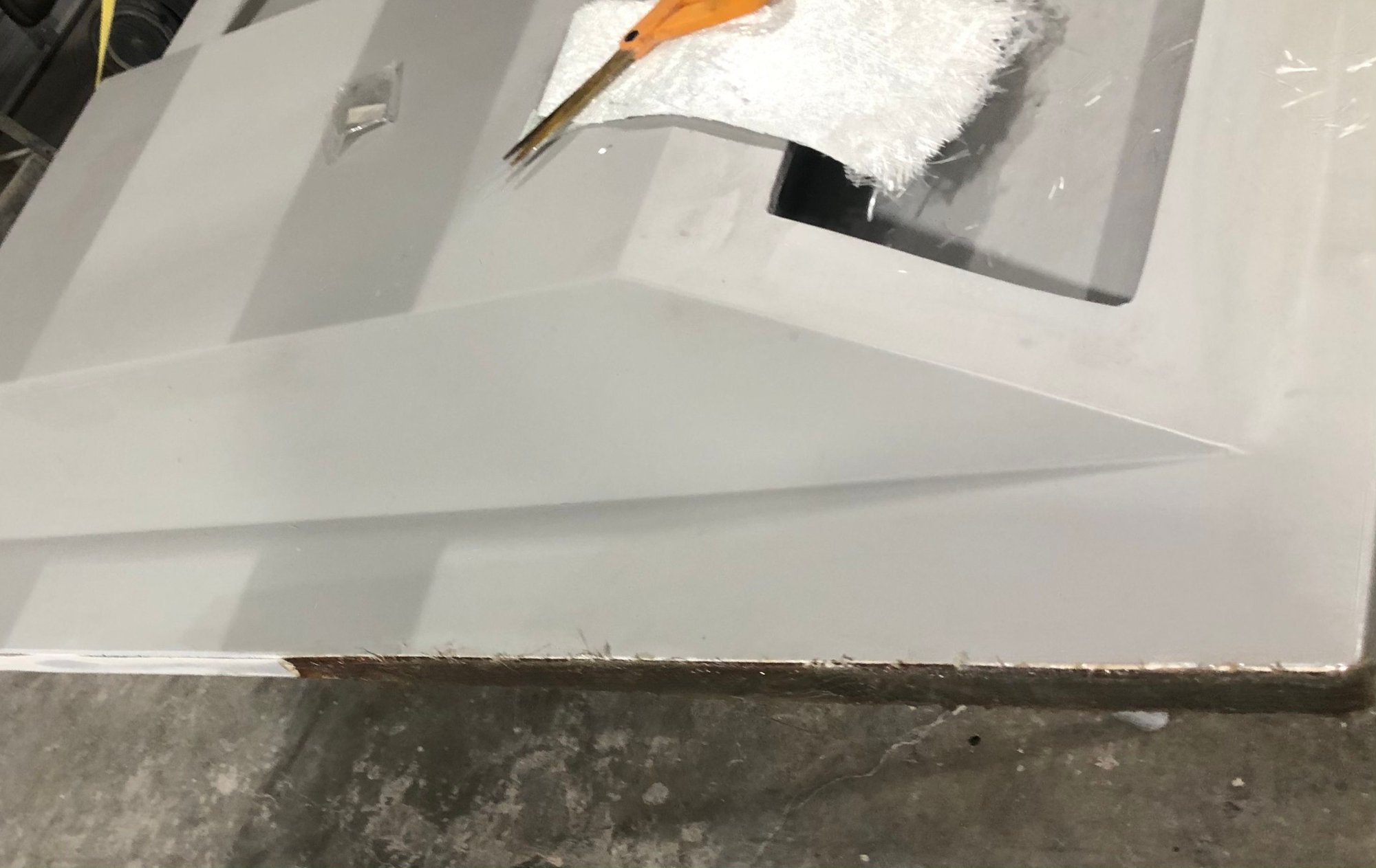

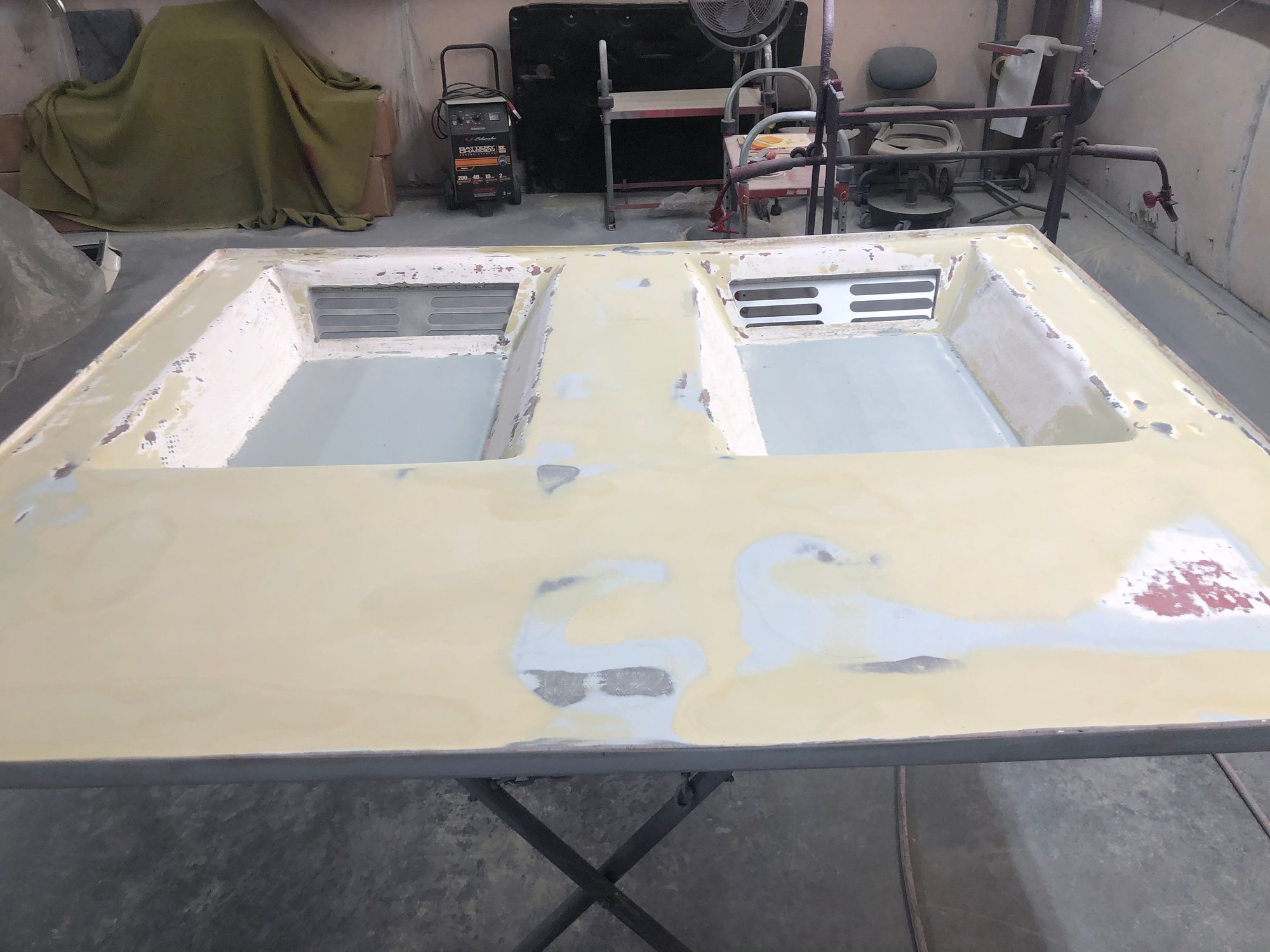

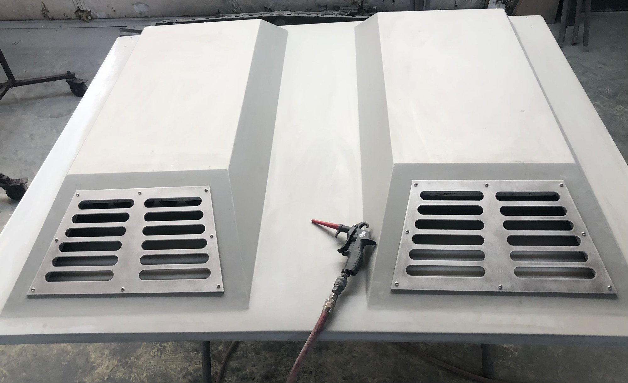

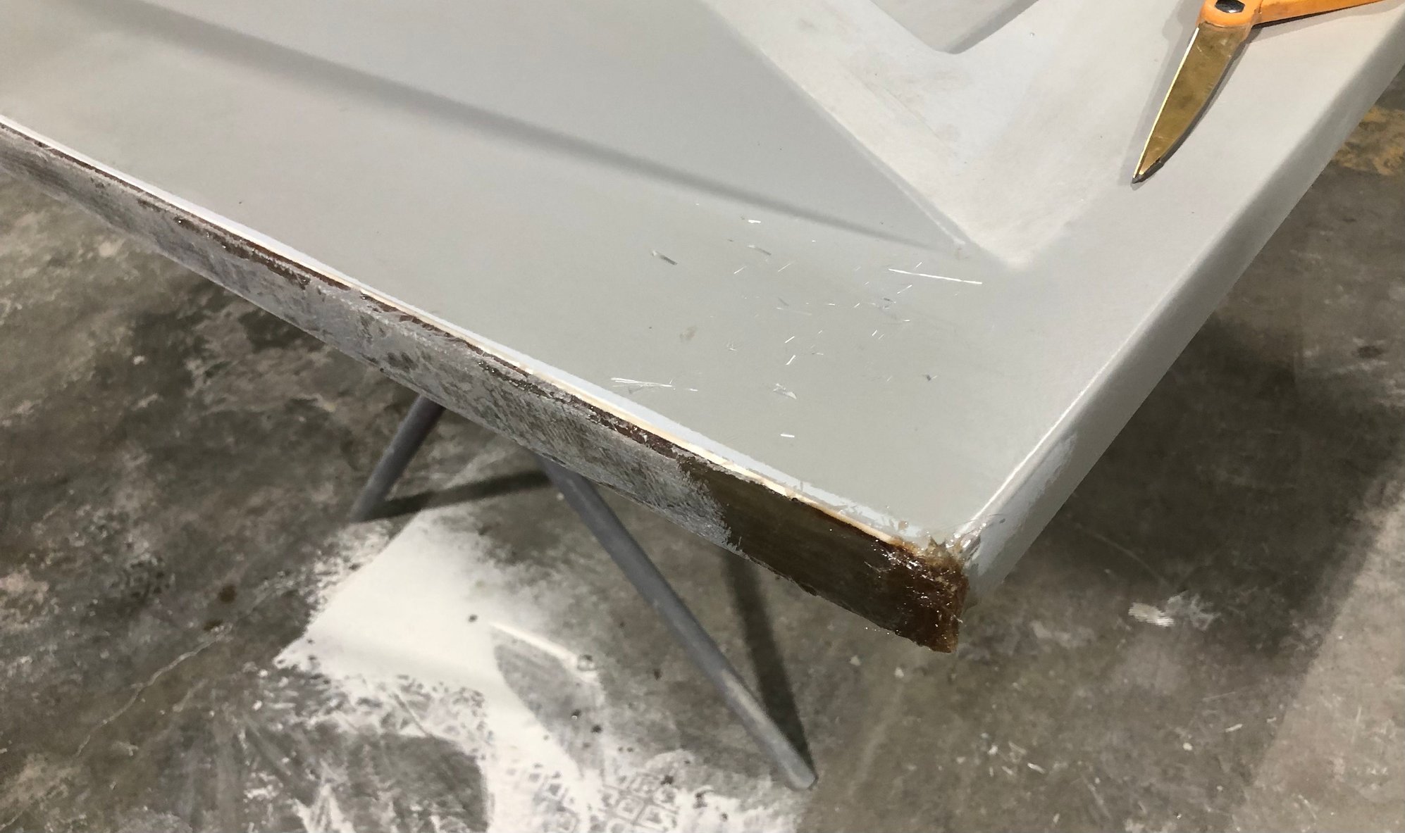

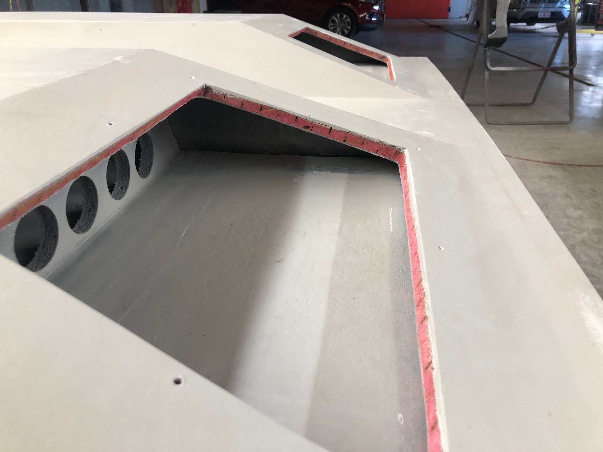

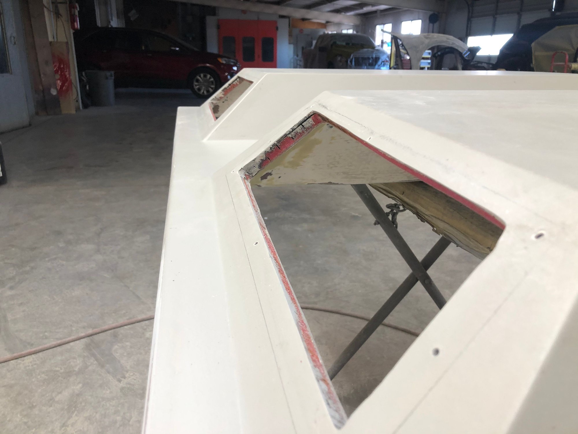

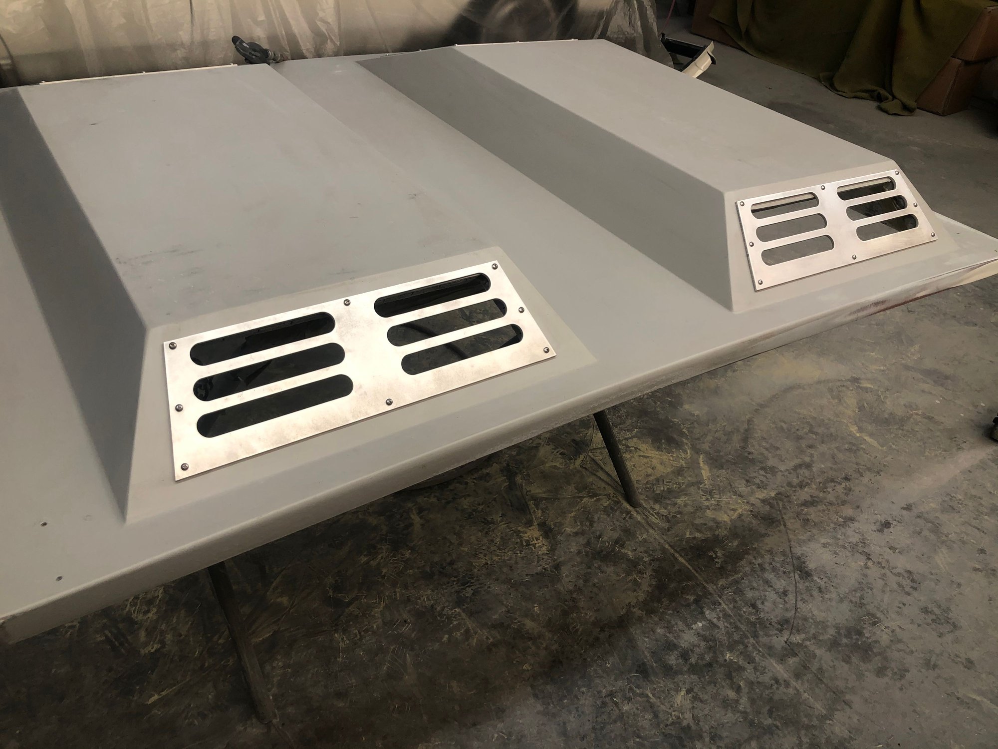

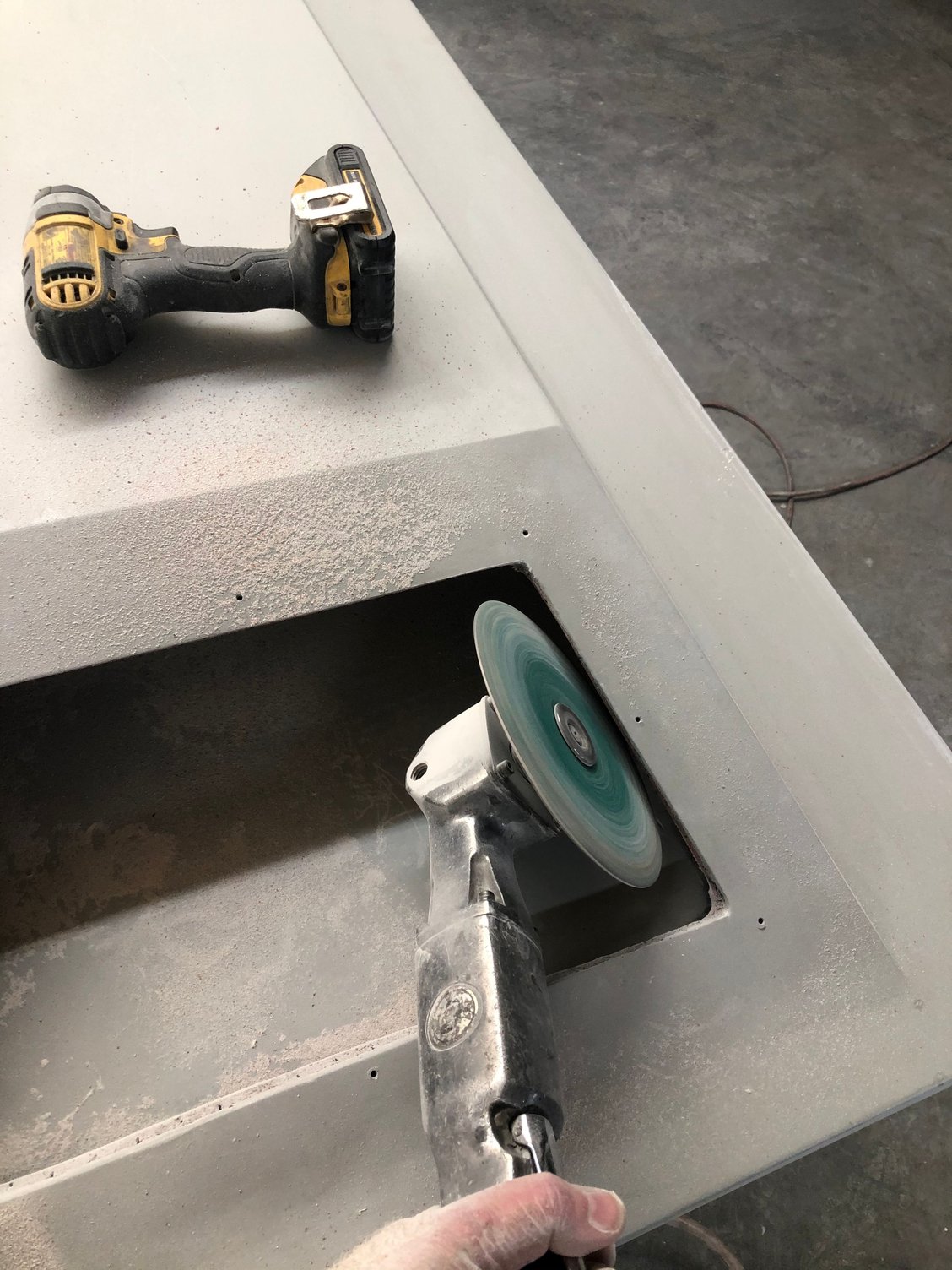

I’ve been fine tuning the hatch to fit the deck and the grilles better. I don’t know if it’s because mine is an early boat or they were just not finished precisely but just about everything needs a little more attention to be right. I had to add more material to the right front of the hatch to get it to fit better, also had to cut some material off the rt rr grille opening so it wouldn’t shoe thru the grille opening. Also spent a bunch of time repairing cracks on the underside, also worked the underside with filler to remove the roughness and smooth it up. It will be sprayed base/clear urethane.

I think the difference between a good resto and a great resto is often minor details, things like the hatch and grille fit. Most people wouldn’t notice but I reckon you’d see it every day Heath. This is definitely a “great’ resto. 👍
