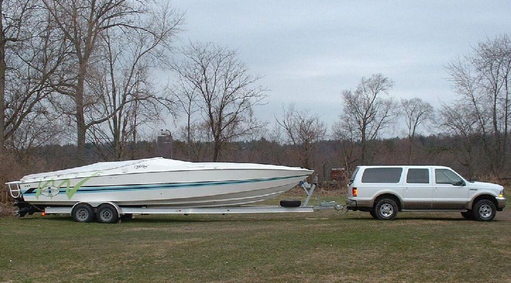

Had an Ex towed a Cig 35 Cafe Racer fine.
Put Airbags on it to tow a Cig 42 Tiger and worked for small distances it was a little much for long trips however.
Attached Thumbnails EXCURSION for towing ??-1243excur_tig0.jpg   EXCURSION for towing ??-_03-setup.jpg
