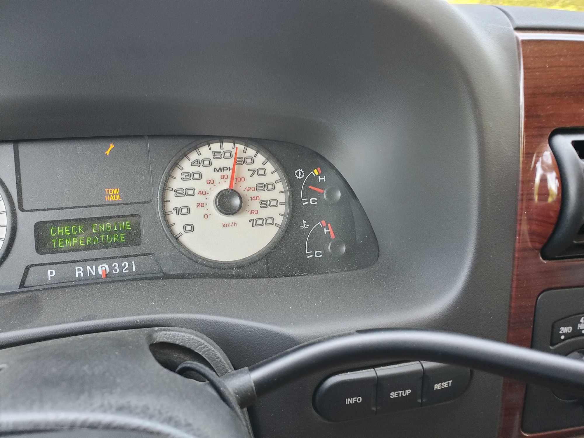

2005 with 92k on the clock, this only happens when towing, the little wrench pops up on the dash and the clutch fan starts to engage, then it says check engine temp and temp needle goes to the red, I have a programmer on it and the coolant temp reading never goes above 190*, I just had the turbo replaced because the veins sticking and loosing boost, but this had happened also before adding the new turbo. Im thinking faulty sensor misleading the ECM into thinking its hot..???? Need some 6.0 experts to chime in TIA

Could be a faulty sensor. What kind of programmer does it have? Do you know what your oil temps are?

oil temp gauge on the dash never moves above 1/2....... is that tranny temp in the pic ? or oil...after about 5 minutes of driving it all goes back to normal, I will get the programmer info

8 years driving a 6.0L and never saw that one. But I will bet it's a bad sensor or shorted to ground. Unplug and see if drops to -40. If so, bad sensor.
