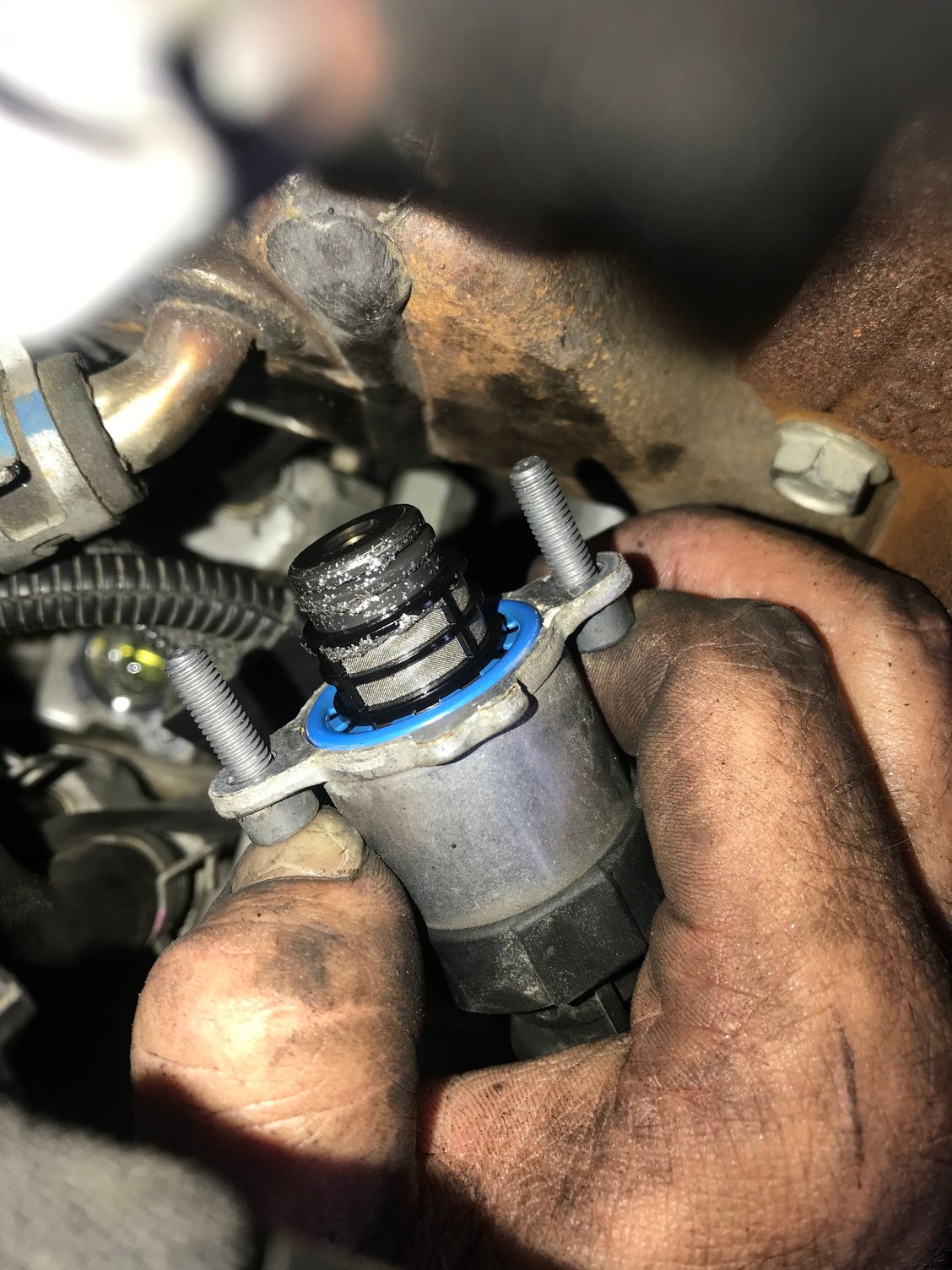

Yeah pretty sure my 200k mile 2011 LML just fragged the CP4. Got towed home last week and haven't touched it yet. Died on the highway, change fuel filter message. Changed filter and primed crap out of it an not even trying to fire. I'll end up fixing it and keeping truck, truck is deleted already with mild tow tune and DID pull awesome. It basically sits in the garage unless pulling the SxS or boat for 6-7k miles a year haha. Still cant justify payment on newer diesel nor find another rust free truck like this one for what I'll have into it.
Not sure if I'll spend the extra coin to convert to CP3 or jut put all OEM CP4 stuff back on and send it for another 100k miles. I understand the replacement Bosch CP4 pump has been redesigned from the early models like I likely have.

I don’t have a high tech diagnostic scanner and no check engine light... took the FPR off and found this...
injectors direct CP4 kit is $2400. Could not justify +$5k for a CP3 kit for an 8 year 200k mile truck. I’m glade someone agrees with me.

Yeah I've been planning on doing that to confirm diagnosis, just been too darn hot to stand in driveway to wrench on it haha. Yeah, I'm thinking go with OEM stock and add lift pump to help. I found reman OEM kit for ~$1800 and all new OEM Bosch for ~2900 in my quick searches so far.

My truck didn’t make it to my garage... I tore into mine Sunday outside and it was hot! Had to act fast, I’m missing lake time!
