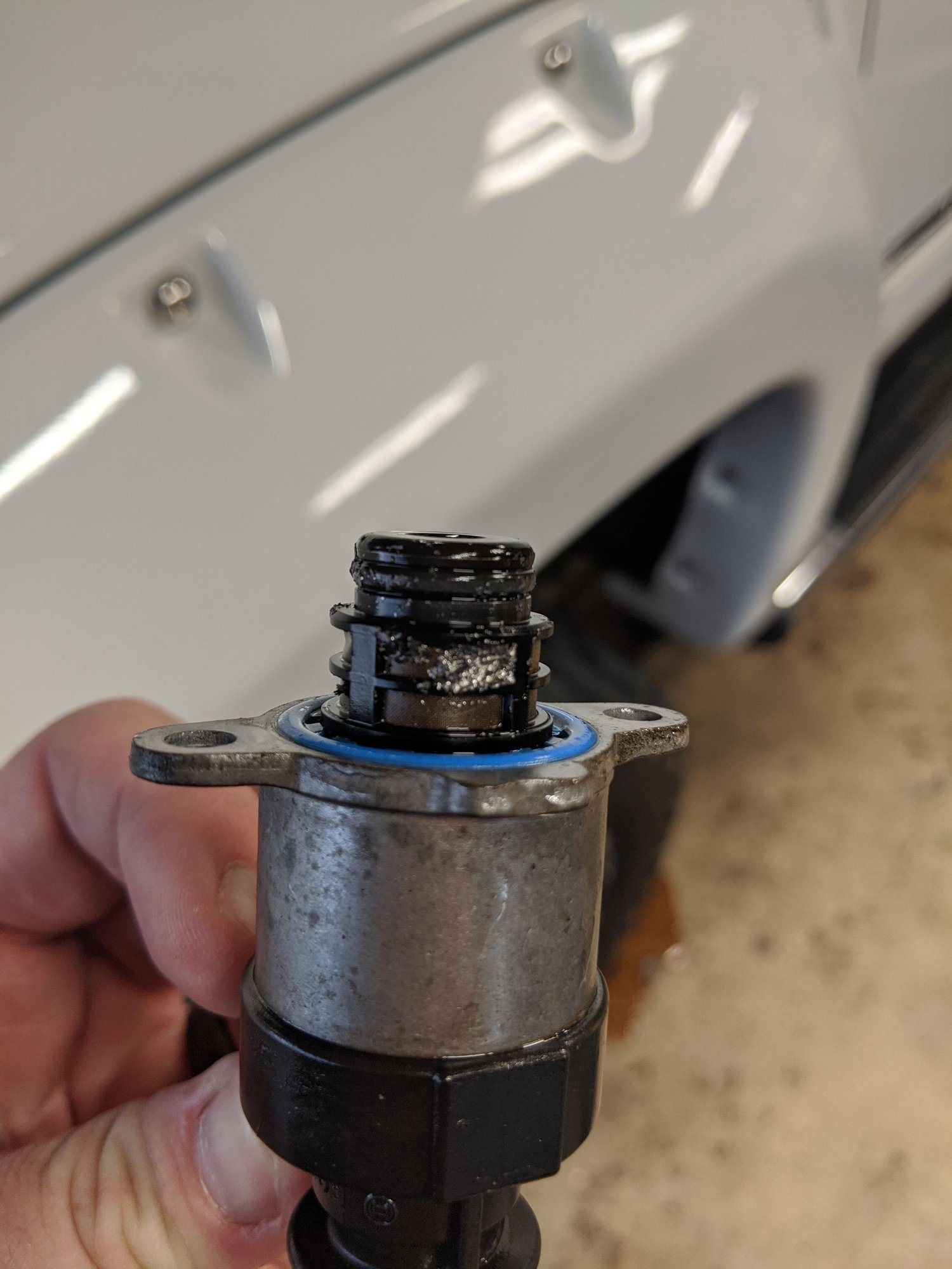

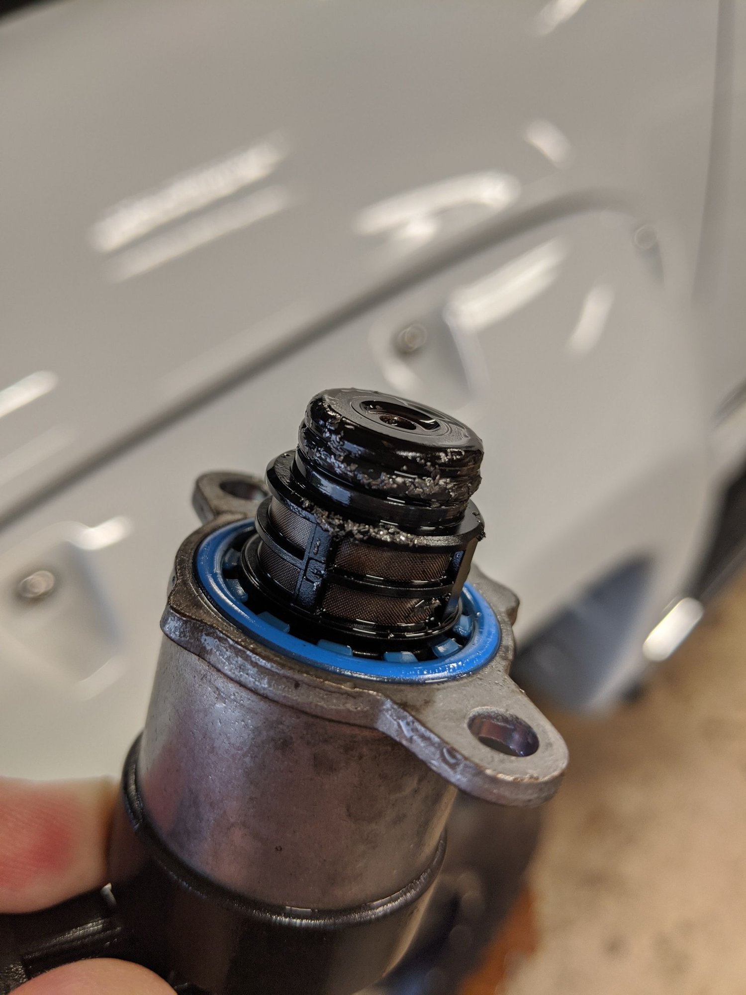

I don’t have a high tech diagnostic scanner and no check engine light... took the FPR off and found this...
injectors direct CP4 kit is $2400. Could not justify +$5k for a CP3 kit for an 8 year 200k mile truck. I’m glade someone agrees with me.

Finally getting back to my failed truck. Decided to de-grease and what clean engine lats night before I dive into it haha. Looks like it is a fairly involved process just to access that FPR, go figure there. Dump some coolant out and move the AC compressor looks like the way to get at it.
Thinking my plan will be reman CP4.2 disaster kit, add lift pump, add CP4 Exergy FPR that has dual 20 micron screens (single 80 micron stock) to contain shavings if/when pump fails in future. ~$2500 in parts im thinking. Now just need to find a decent labor quote as I'll spend a month of weekends the way my schedule goes trying to do it myself.

If you do it yourself, PM me and I’ll give you my number. I can give you some good advice. I have not found any good threads about flushing the system. Most people have someone else do it I guess. It is NOT easy by no mean. Friday will make my 5th day working on it (6-10 hour days) if all goes well, it will be put back together and hopefully start. I may be able to give you some time saving advice.
I saw the FPR you are talking about and I like the sounds of it. I couldn’t find any real life experiences after a CP4 failure though.

I’ll correct myself. I figured today would be a short day but I was wrong! Worked on it 16 hours but it is running!
Anyone need advice on changing a CP4, let me know.

Ouch. I feel your pain. I’m past my frustrated stage and decided to keep mine as well. I’ll PM my number if you run into anything. Buy some 3/8” and 1/4” swivel extensions, they will save you from taking a lot of extra things off. I did not take the whole EGR cooler off because the down pipe bolts are a pain. I also didn’t take off any of the coolant lines on the front of the motor. The CP4 bolts were hard to get to but the swivel extensions will get them out. The CP4 MUST be timed. Keep that in mind. I used a mirror to see the inspection hole.
[img]blob:https://www.offshoreonly.com/03746f89-7cc4-4a51-a398-f432155b53b3[/img]
[img]blob:https://www.offshoreonly.com/75f4551e-b255-4ba1-a30e-3f0bbc8dbe0b[/img]
I done A LOT of research and head scratching. It’s a pain. I’ve pulled my boat twice since fixed and so far so good. Running opti-lube in my fuel (popular choice and saw some good data). I’m going to change my fuel filters even more frequent now.
