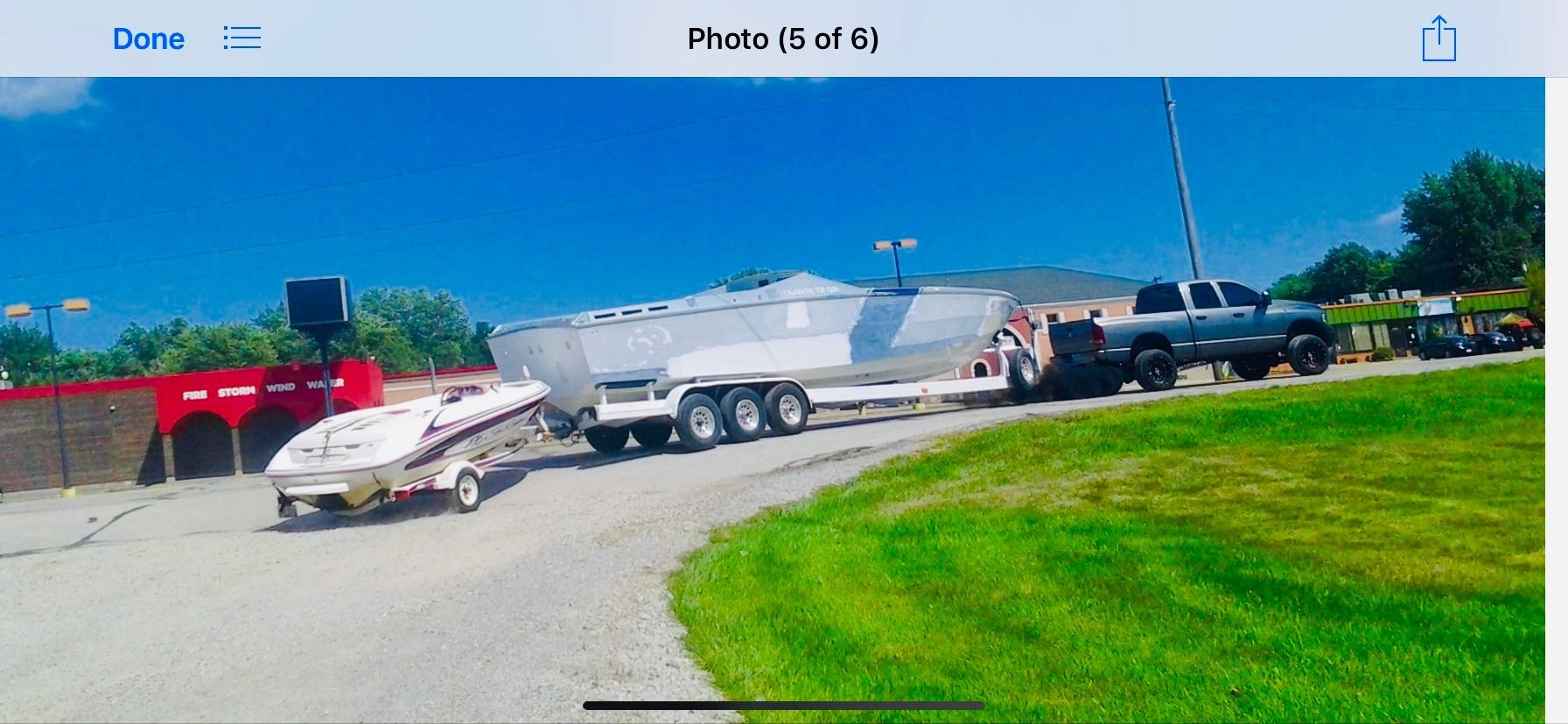

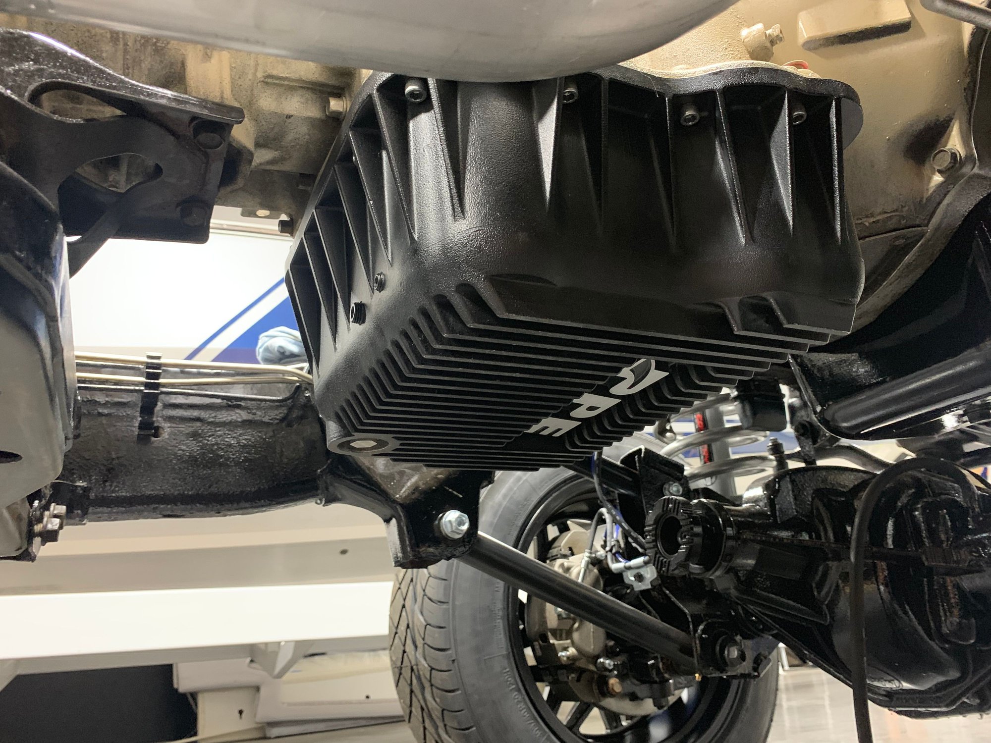

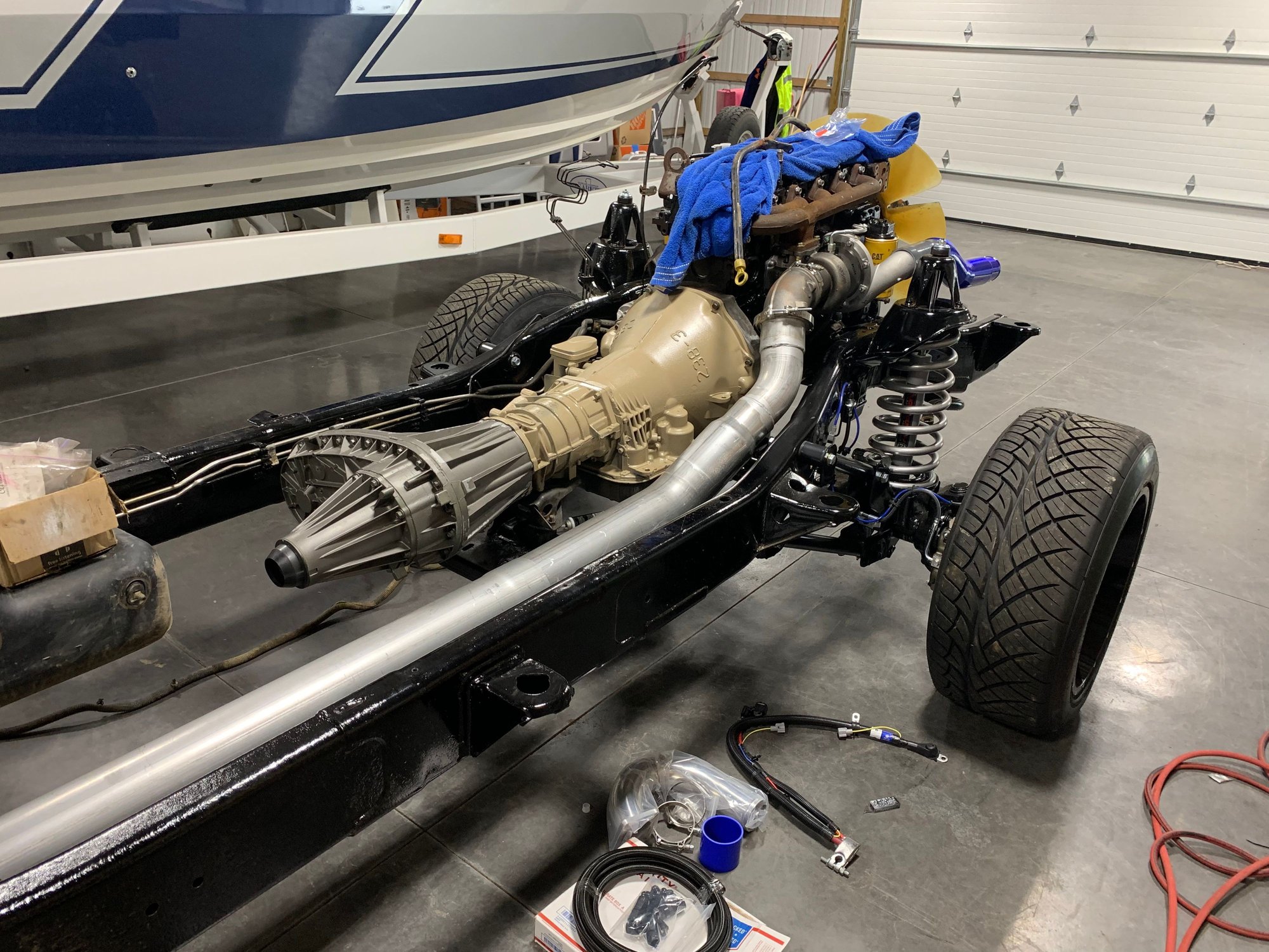

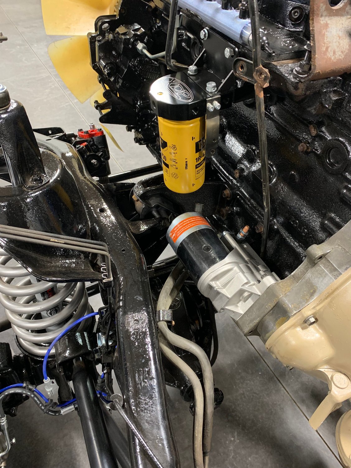

I totally agree with you on how expensive these new trucks are to work on after my 6.7 needed turbo and head work after a glow plug fell out I decided to go back to my roots and built a truck from the ground up to tow my 38 gun one that I picked the newest platform that was pre egr and dpf. Ended up with 2005 dodge 3500

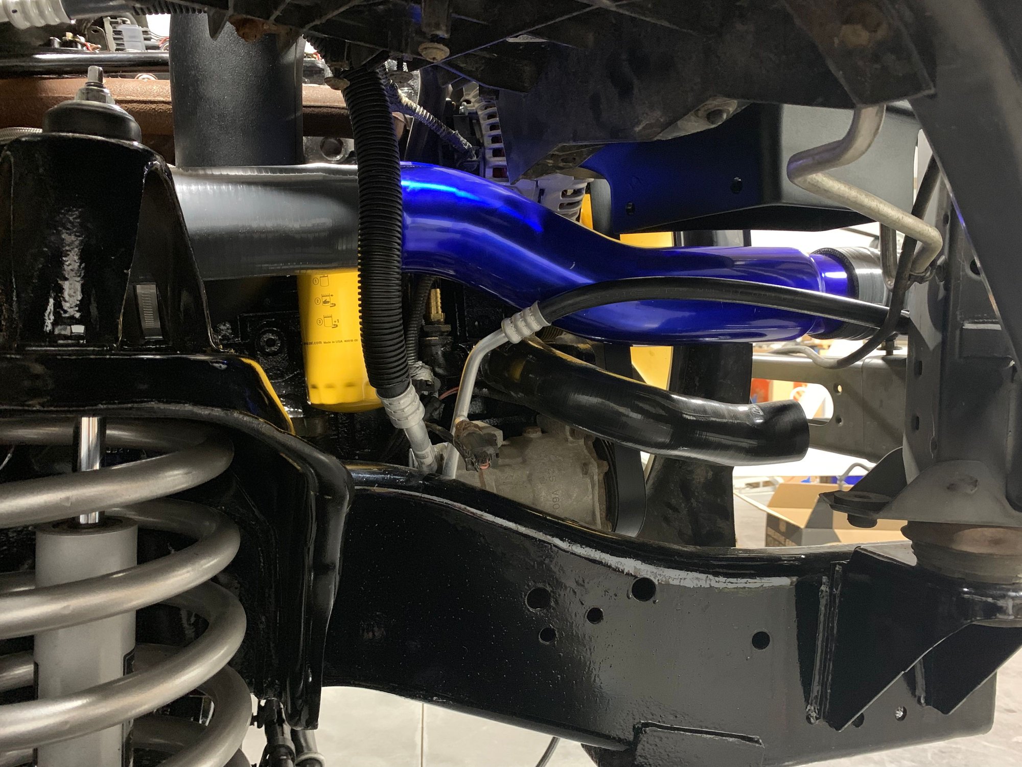

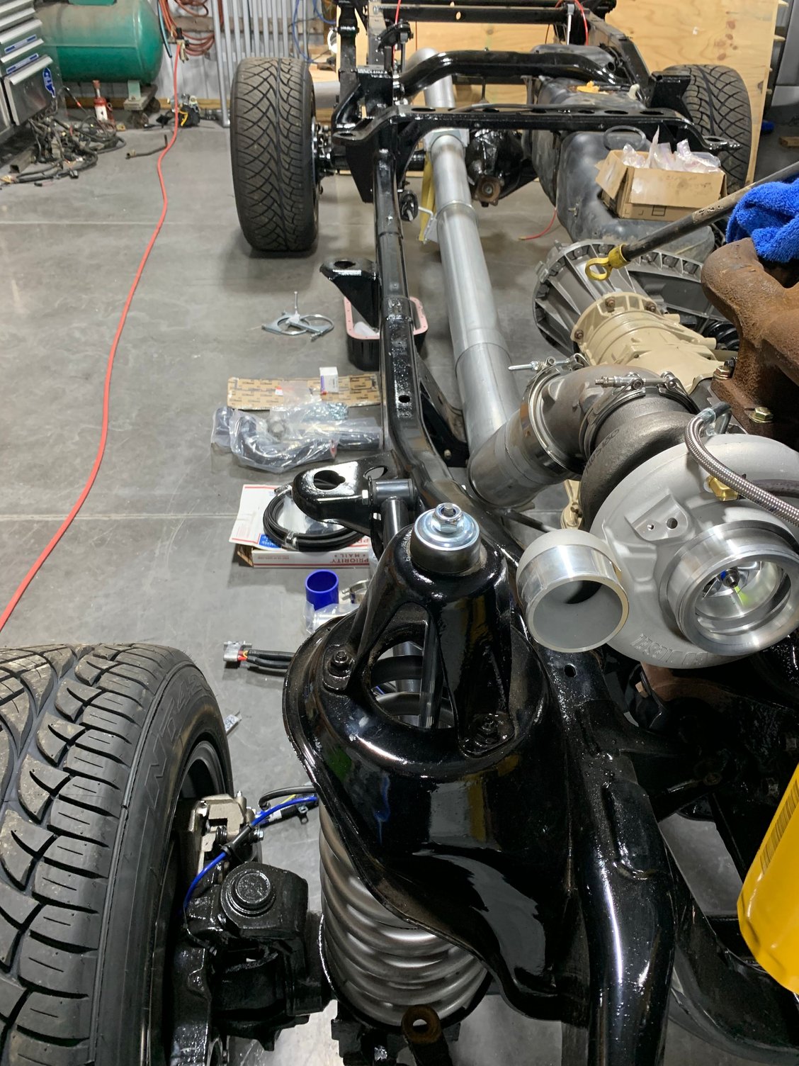

Replaced every part
New every thing
Sandblasted and power coated frame
Bdc trans

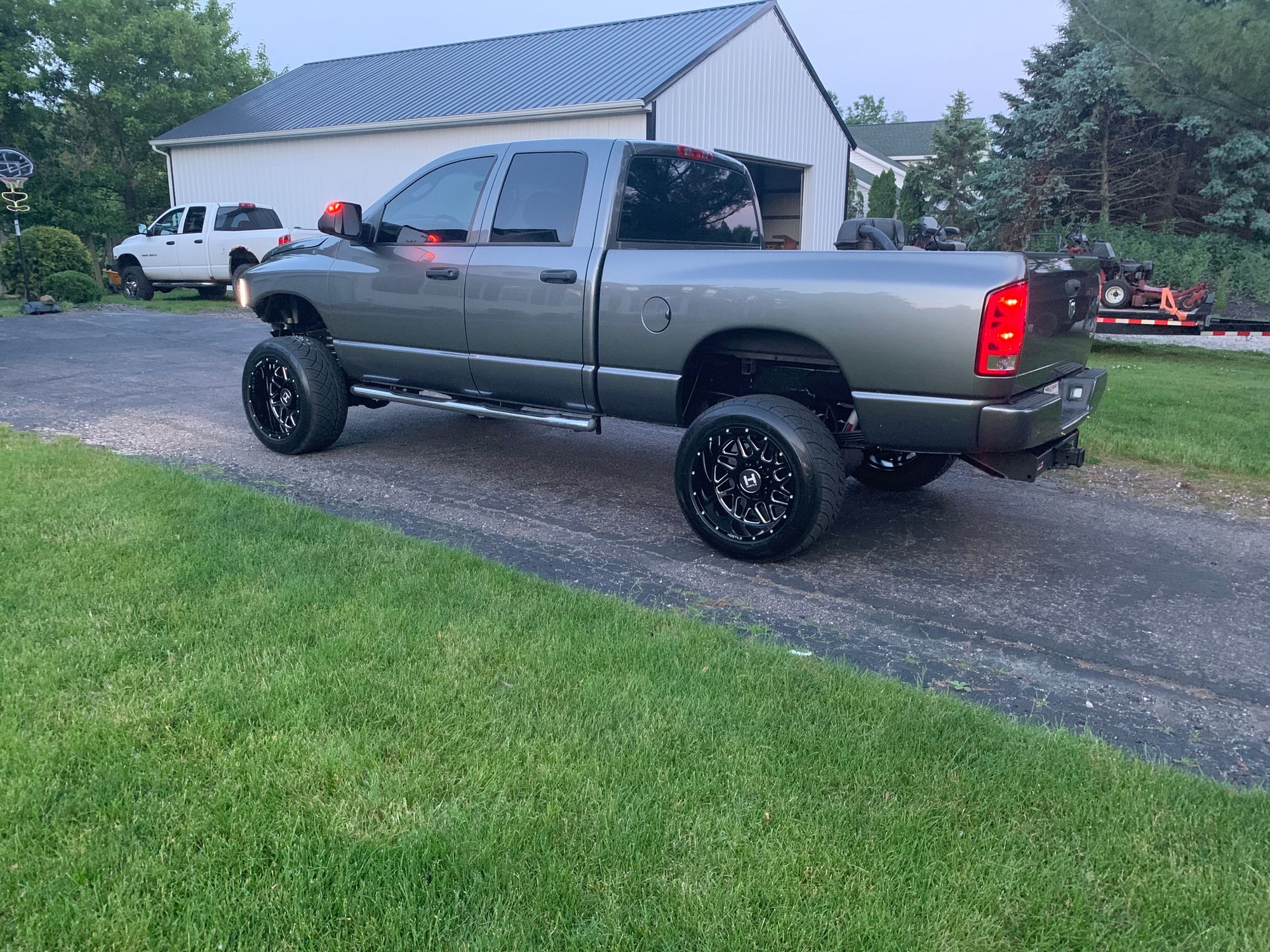

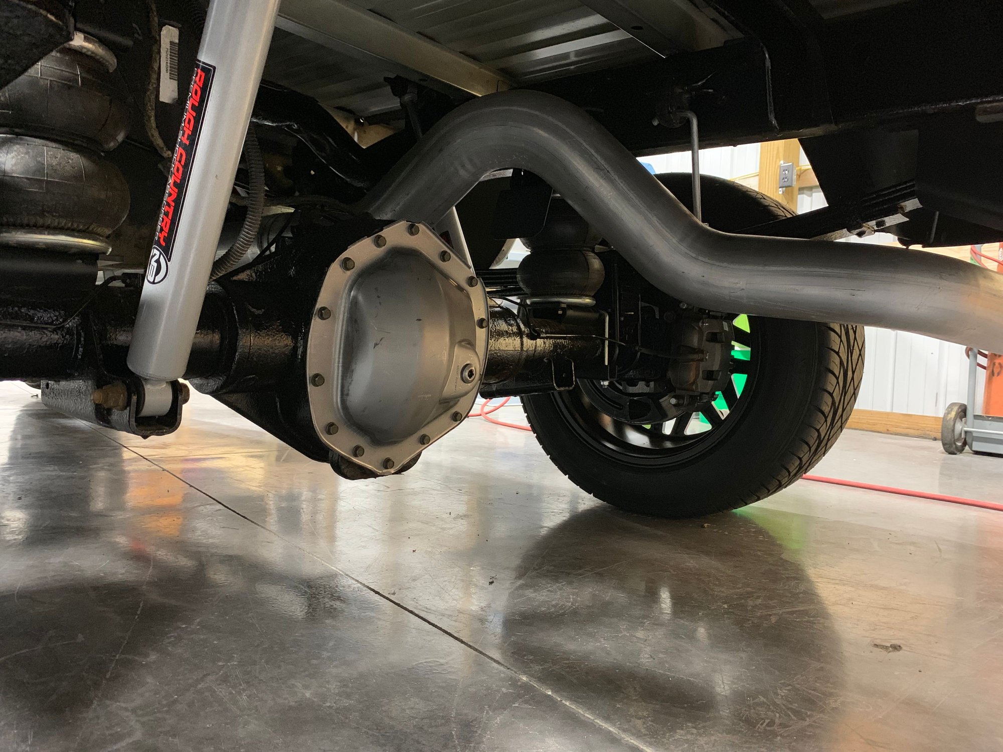

Starting to take shape
Air bags and traction bars
Body came from Palm Springs Cali no rust
Slt interior heated seats every option I could get in 2005 lol
Working hard

Id like to see you back that up...........

Lol yes that was a bit of a Dicey one 😂
