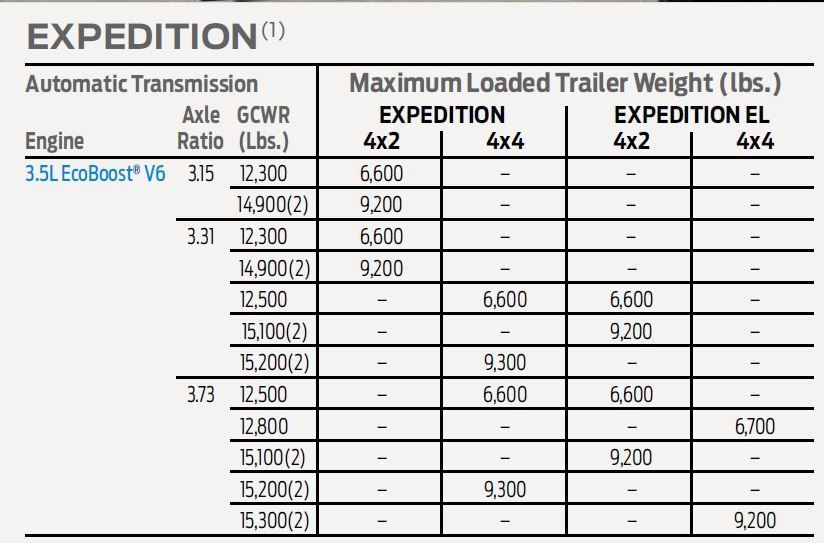

My Expy has a GCWR of 15,300. Trailer weight max for the Expy is 9,200. My boat is 8,500. The aluminum trailer weight must put me way over lol. Braking is the biggest part of the trailering equation. Have you ever even seen an Expy's brakes? There's plenty of good stopping power there on their own. It has huge rotors and calipers and linings. Like I said before, yes, the trailer brakes do their job also which is important no matter what you tow with. Wheelbase? What's your point about that? You think a regular cab or even an extended cab has a ton longer wheel base than my Expy EL? A standard '99 F350 for instance is 137". My Expy is 131". That 6" difference huge... You haven't even mentioned tires which tells me you really don't know much about towing. I have D rated tires. Tried for E, but couldn't get them.

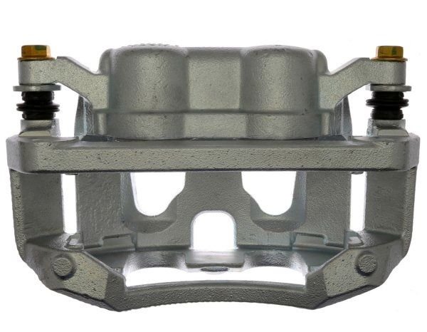

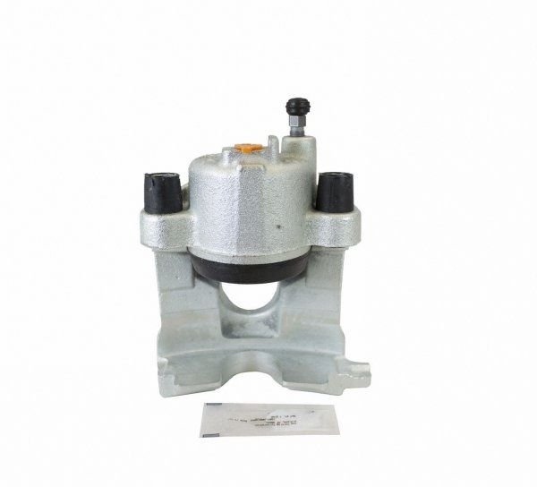

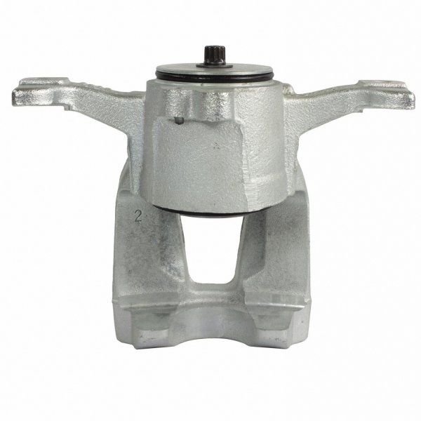

Your Expedition has the same brakes as an F150.
An F250 as a "next size up" comparison has an average 1" larger diameter rotor front and rear.
And here's an Expedition rear caliper compared to a F250 rear caliper.
HMMMM

"My Expy has a GCWR of 15,300. Trailer weight max for the Expy is 9,200. My boat is 8,500".
I'm sure you don't know what GCWR is even though you seem to think you're an expert on trailering so I'll spell it out. Gross Combined Weight Rating. That's truck and trailer weight combined. I won't try to show you how to calculate it because I wouldn't want you to strain yourself. My boat is 8,500. Maybe less because there isn't a genset in it now.
