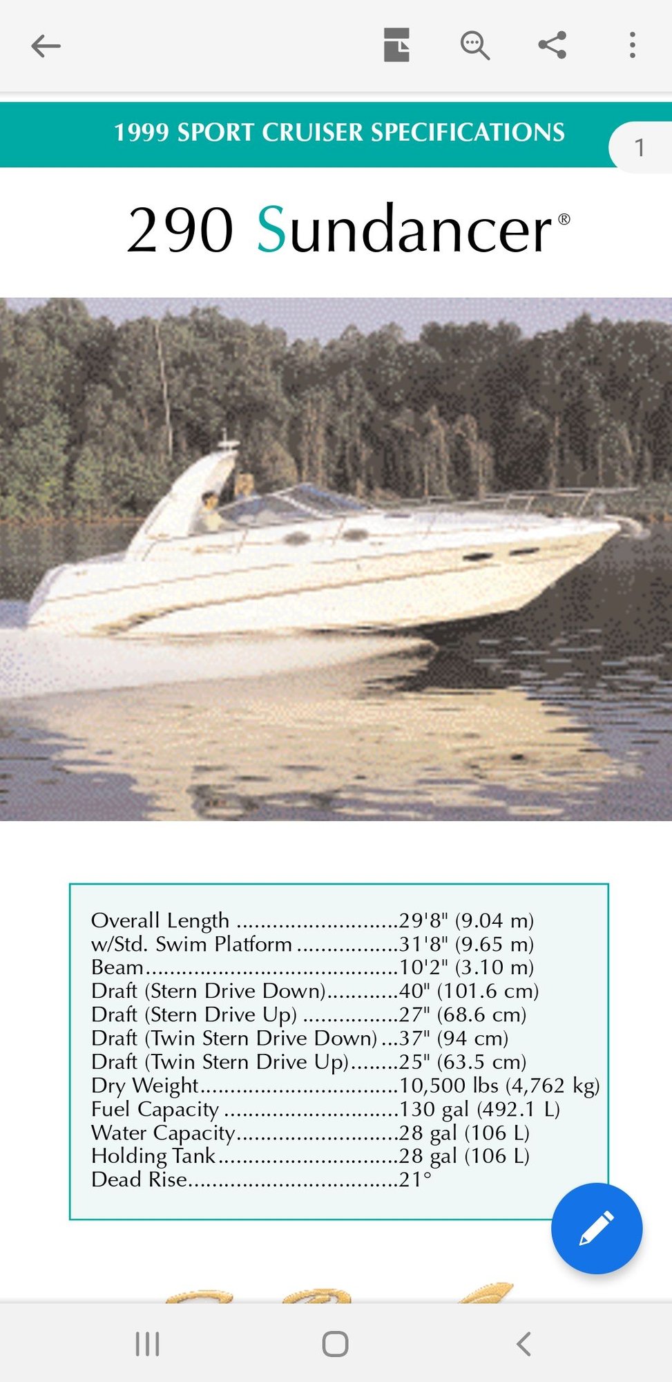

A short Google trip came up with a Sea Ray brochure, albeit a 99.
Weight at 10,500#

A short Google trip came up with a Sea Ray brochure, albeit a 99.Weight at 10,500#
I get that you two aren't the brightest bulbs on the Christmas tree and that you're grasping at whatever you can to save face, but would you at least try to use some factual info that pertains to my rig? The 99 Sundancer is a different boat in a lot of ways. ie., the beam is 5" wider. Mine is an early 97. Here are some guys, other than me, talking about weight. So, you can go start an argument with them too about their boat and trailer combo weight lol As far as staying right and 55, apparently Cheech has problems with reading comprehension and making assumptions also. I drive 7 miles to the boat ramp. No highways...

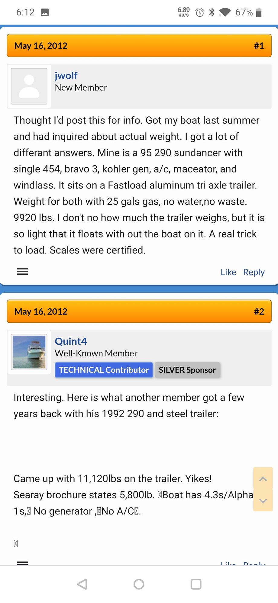

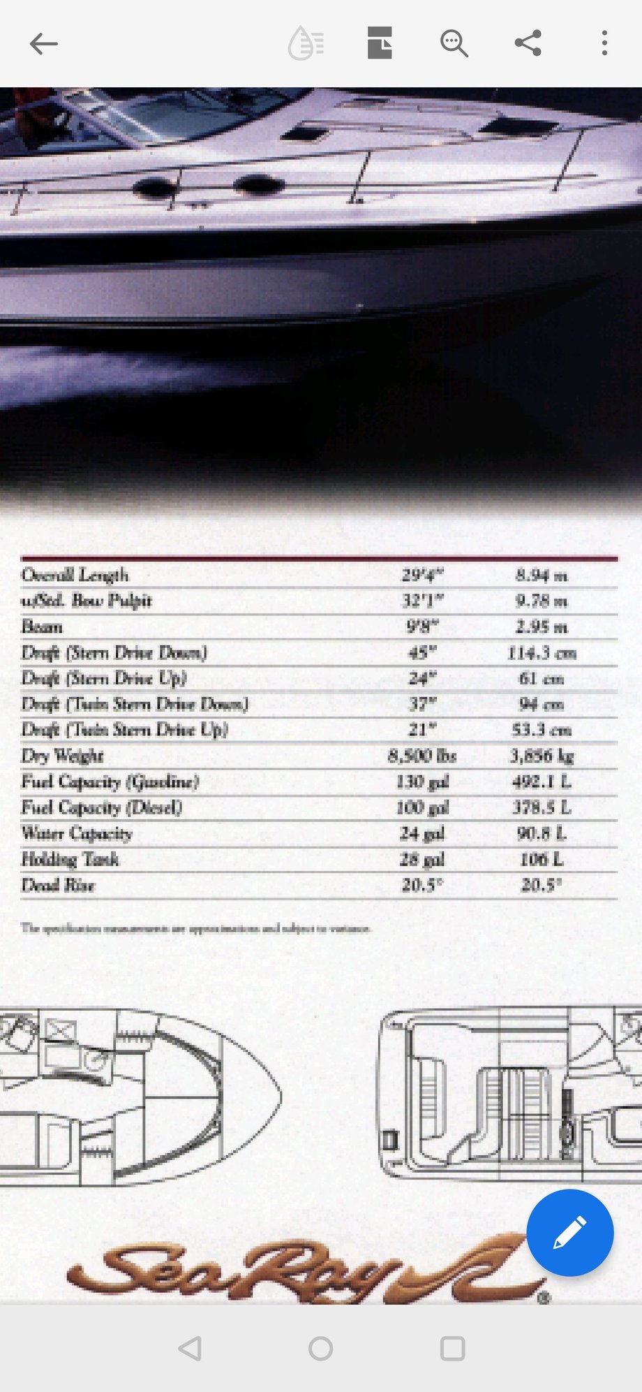

Here is the 97 brochure as well as other guys with MY boat talking about the scales... 95-early 97 are the same. 9,920 with the same set up as me on an aluminum trailer and 11,120 with a 92 on a steel trailer.
9,920 lbs with the 400 lb genset. I know it's a lot of math for you, but get some help to walk you through it. This means mine is 9,520 lbs. Woah... 320 lbs overweight. Call the DOT!!!

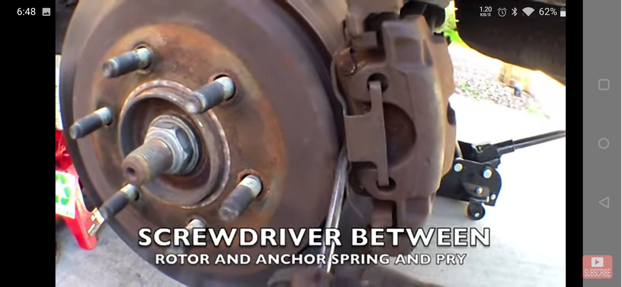

I'll even throw in pics of a real Expy front and rear caliper and rotor. Not cheech's fantasy caliper...

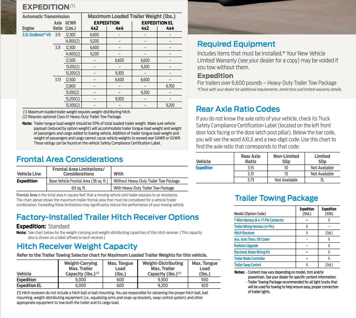

I figured in the interest of data to post the full ratings for the tow vehicle, I assume its the Max tow version. As normal for the companies they get these ratings on the stripped down vehicles, not the max optioned ones. But hey, it is in the small print so all is good !
Anything different from what I've explained already?

Uh oh, someone brought facts...
I'm sure those aren't your own pics.
No fantasy caliper. As you're not very bright, don't include the bracket in the size of the caliper.
