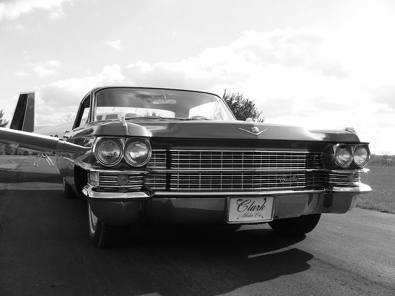

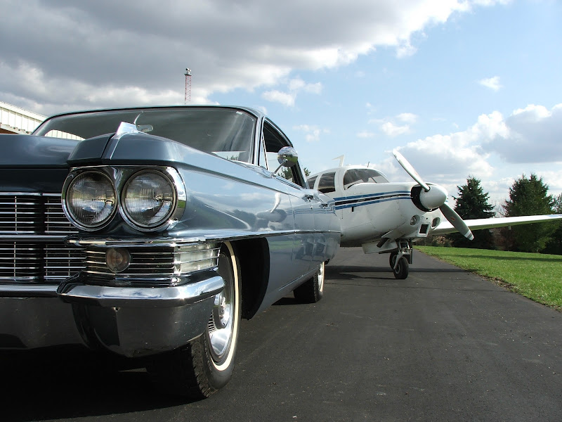

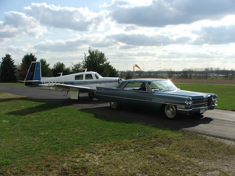

I see you got the picasa up and running! I couldn't help but notice the 63 Cad you restored, sorry for the hijack but heres a shot of a few of my other interests.
that is ok with me.... nice rids,, I just brought my car in to my shop to respray in base clear... I sprayed her in ppg laquer and it didn't hold up well at all...
