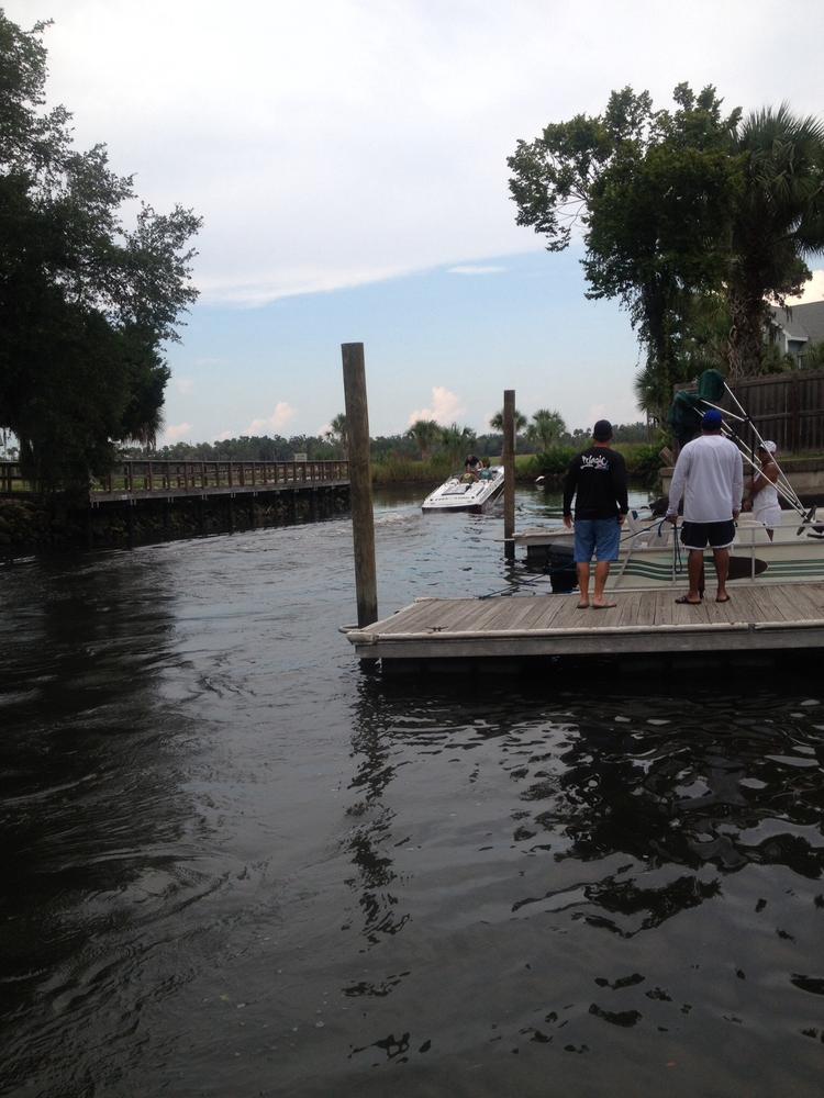

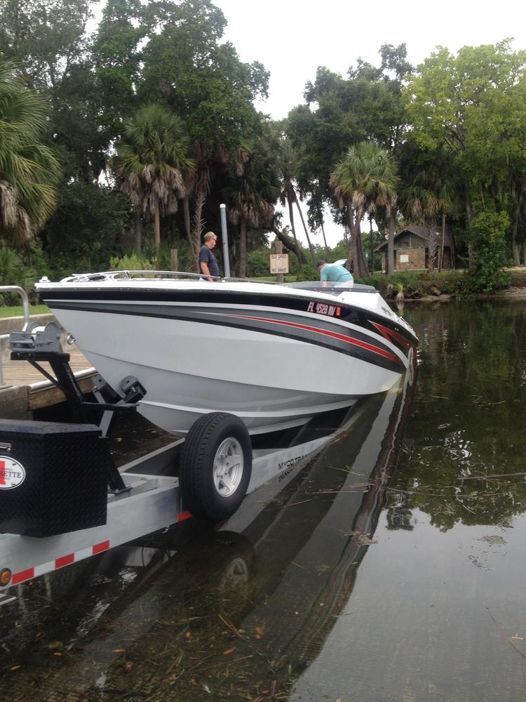

5 blade 34s to big, it ran 270 miles last weekend running 4 blade, 34s. Tops out at 95, still looking for the right props. The 4 blades are fast but suck at cruise (3500). We don't run fast WFO, but cruise at 3500. Going back to turning in now. Looking for 5 blade 17.5 x 31 15 rake.100 miles back in the rain, 3-5 foot seas, dodging thunder storms. What a .Blast
