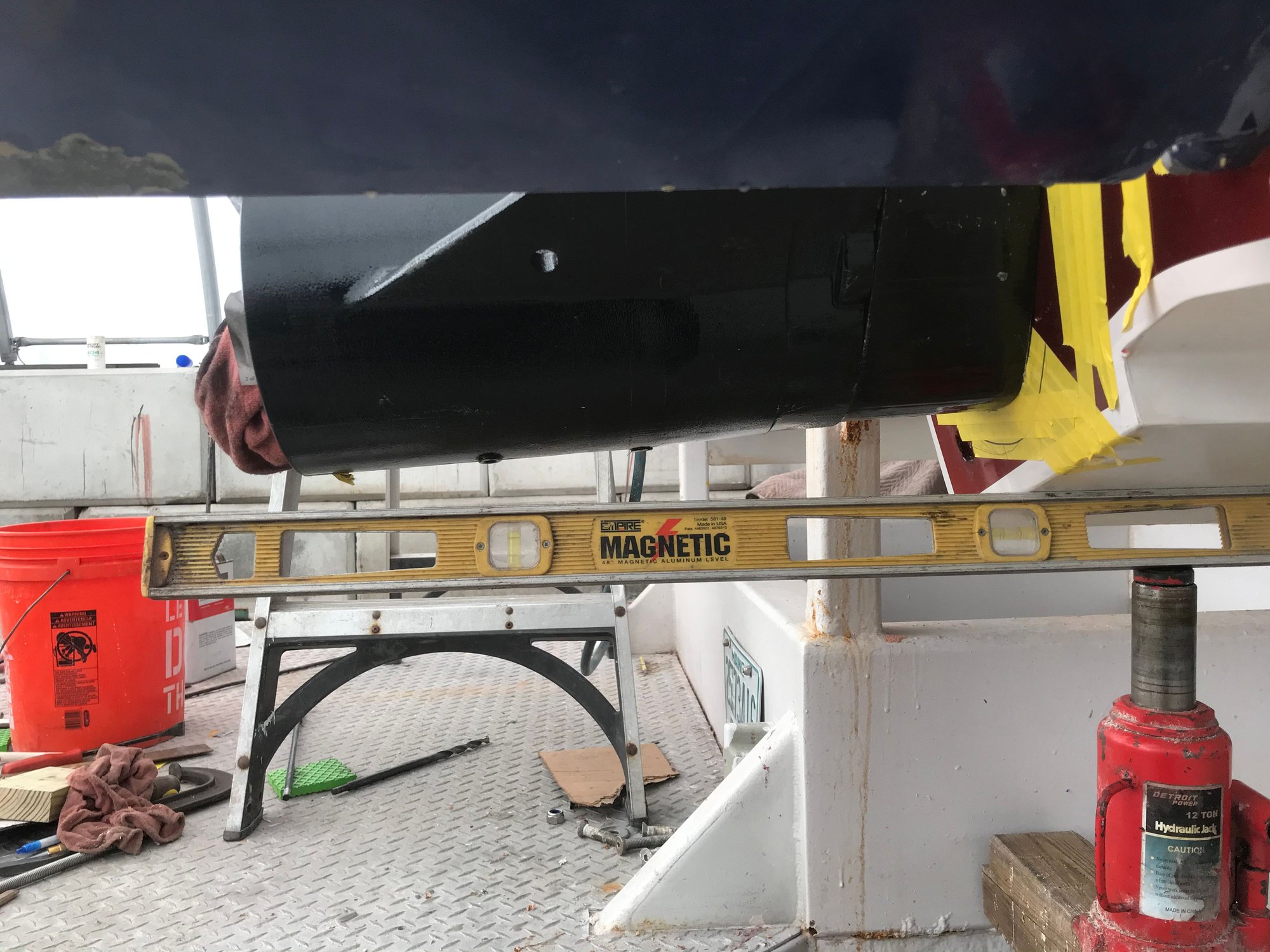

Originally Posted by sutphen 30
should you have lowered the whole assembly closer to the bottom of the boat?arneson wanted us to be 3/4" from the bottom when we did the conversion on the 47 excaliber?
good question
Did you have drop boxes?
My drop box is 18 inches long
I have cut out some of the floor in the skater
to accept the lower stud holes.
the reason i chose 4 degrees is thats transom
angle on the mystics and no more then 6 on others.
You should see my speed dial list of who has
helped me lol
here is low altitude
Notice height 4 degree transom

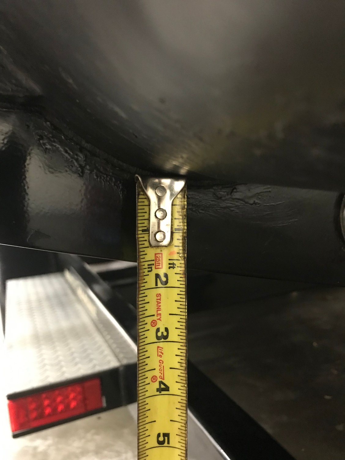

This is mounted 1 inch above transom With grinding half moons in bildge Notice whats going to happen
This is at current height
KNOT-RIGHT is offline

I wouldn't worry too much as when the water leaves the transom it starts to rise from the running surface anyway and most BPM setups I have seen seen don't seem to have any positive trim.
It's all going to be trial and error as your hull was designed for #6 and I really don't think you're far away from what my setup looks like.
How many steps has your hull? steps, tunnel configuration weight CG are all going to play a part in your bow lift as well as speed and tunnel compression.
At this point I would say try what you got . is it possible to remove any material from the bottle jack mounting flange if you can't get the trim angle you need ?

I plan on doing a dry start and run on trailer this weekend checking everything
im about a week out for sea trial. i am currently waiting on parts so i have some idle days
where i could pull the boxes and re drill one inch lower which would increase my positive trim range by
over a inch. I am 9 months into this mess so whats a couple more weeks.
By raising it one inch i would loose some negative trim.
There were so many variables involved like how much tunnel water to grab.
Sixes were at 86 inches apart. The Angled Bpms are 68 inches. Props are grabbing much more tunnel water.
Which leads me to Aerators are you running them?
the mystics have them built into the bussel.
Sounds like you got a chance to run yours????
oh yea 4 steps on the Skater two large ones and smaller ones.
