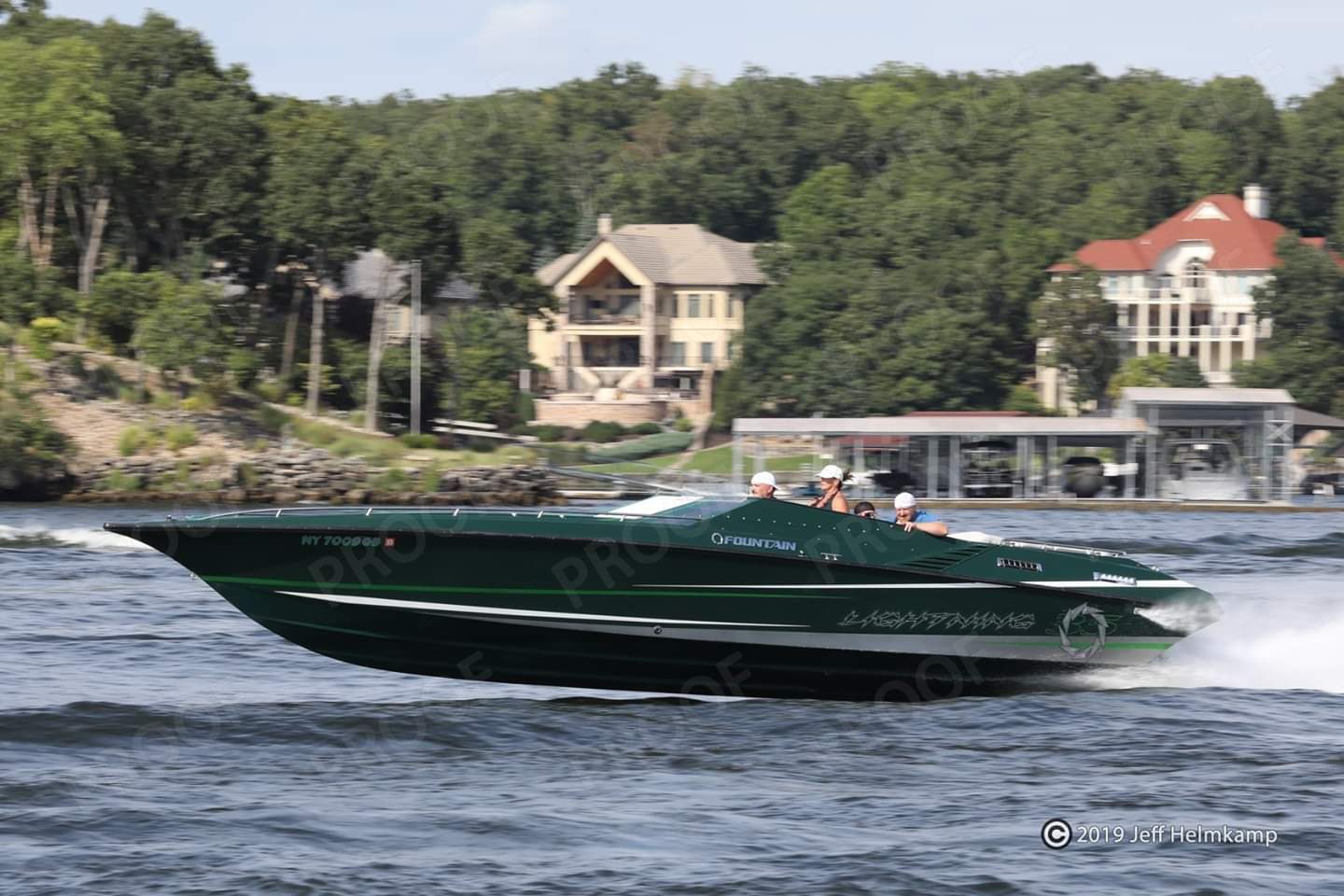

The above boat back in Her earlier Glory and life ..

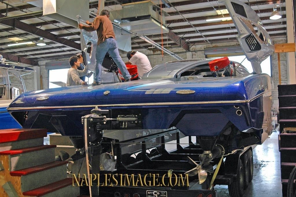

Originally Posted by sutphen 30
should you have lowered the whole assembly closer to the bottom of the boat?arneson wanted us to be 3/4" from the bottom when we did the conversion on the 47 excaliber?
Sir William these: Just Turbines-4450695_20130903075052770_1_xlarge.jpg

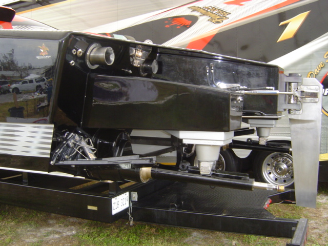

Here is Dave Scotts old Boat that are reconnaissance satellite took some spy photographs of.
these are fixed arnesons note spacers
it does not look to have positive trim eithier
