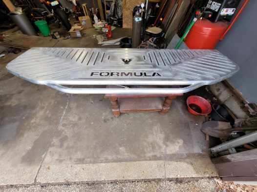

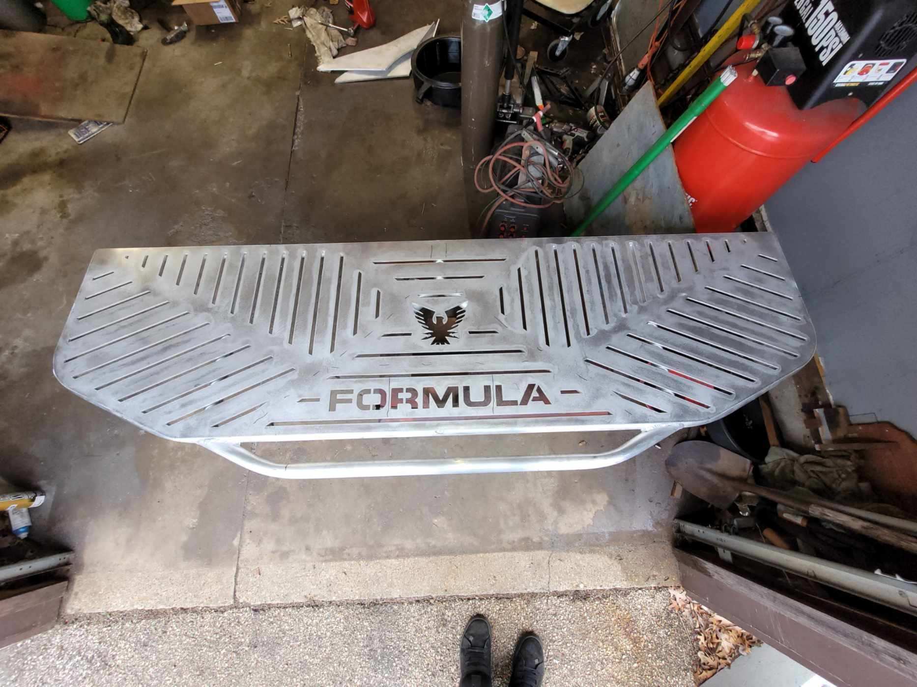

The platform is getting close to being finished and ready for final finishing……I’m still thinking the navy blue (paint) on the boat because that is the easiest for me and I still have enough paint to do it.
In the pics you will also see the supports we made for the platform. They have bases on them that are 10” tall x 2” wide. We put (2) 1/2” holes in them (near the top) to bolt to the boat. We are also making large plates for the inside of transom to help distribute the “point pulling” when weight is on the platform.
A couple questions for you.
1) Are 2 supports enough without anything additional?
2) We put the 2 holes near the top of base thinking that is where the platform would want to pull away from the transom. Should we add more lower?
3) Is 10” tall x 2” enough surface area for bases of supports on outside of transom?
4) I have quite a bit of room to make the inside plates a decent size. What size would be sufficient on a 2” thick transom?
I know I should have asked these questions earlier, but we still have time to make necessary changes before paint.

Supports are good, I would add two more fasteners per side (mine has four stainless 3/8 bolts). This will prevent any potential rocking.
We used quarter-inch thick aluminum backing plates on the inside (platform came with all the hardware).
The platform was suspended via nylon webbing and moved into place. Once aligned, everything was cinched tight and then checked again. The holes were drilled using pilots that confirmed to the angle of the bolts holes coming through the mount. We removed the platform, finished the drilling, then used resin on the exposed wood. Once cured, we mounted using 4200 to seal it all up, inside and outside.

Thanks for the help TomZ!

Thanks, It’s is coming together and nice to be nearing the home stretch with it. This new platform will look so much better and I lifted it myself.....a lot less weight hanging off the back. I think it will sound much better with the Corsa tips vs going through the platform.....even with the extra holes drilled and baffles out of the ST.
