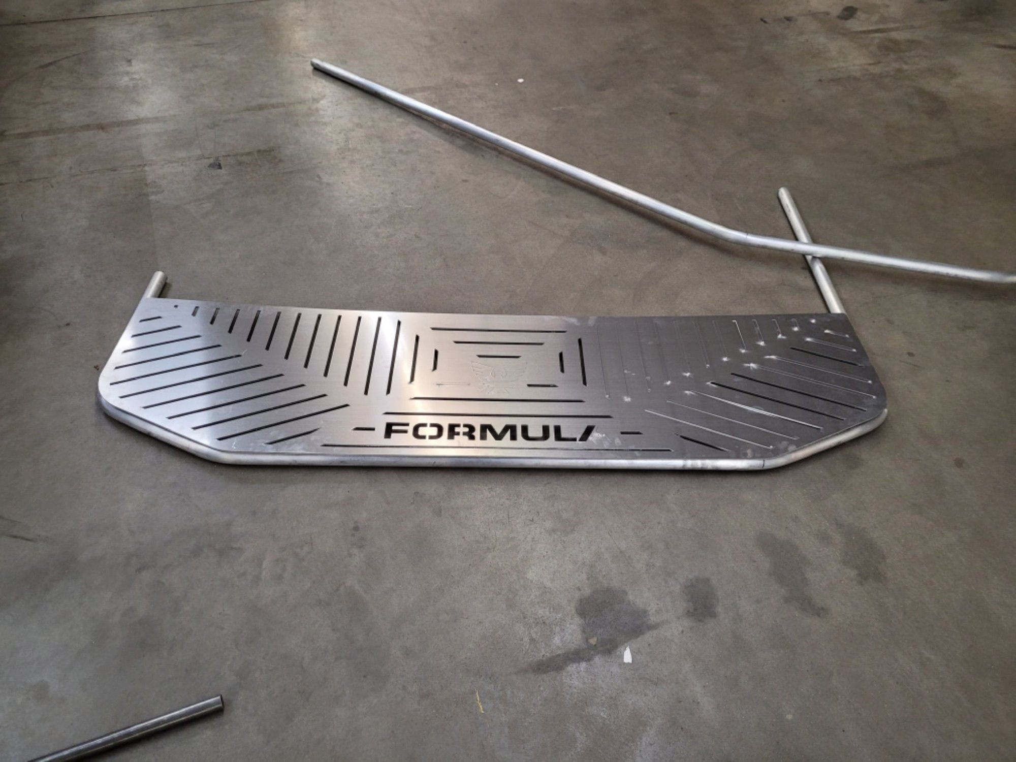

Here is a better pic of the “deck” of the platform. Also is a pic of the tubing being bent to go around the perimeter.
I kinda like the natural aluminum color.
Not sure how I would “non skid” and would I have to seal with something to preserve the natural color from tarnishing? I think that’s the correct term for it. I’m still thinking blue, but thought I would get your thoughts for those of you following.

I agree the standard alloy finish looks nice but yeah, I think it would lose that finish quickly.
I vote powder coating and match it to the current colors. You’ve got white, blue and black to chose from. Could you do the platform blue and the tubing black? Otherwise, I’d go all blue.
RR
I have heard of a product called alumetron (guys use on pontoons to coat their aluminum toons, but not sure if that lasts or would be the right product for this instance. I think you’re RR, I’ll probably keep blue, not sure on the two tone......didn’t think of that....interesting.
