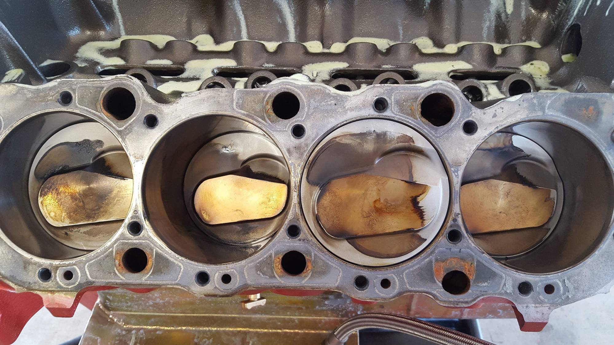

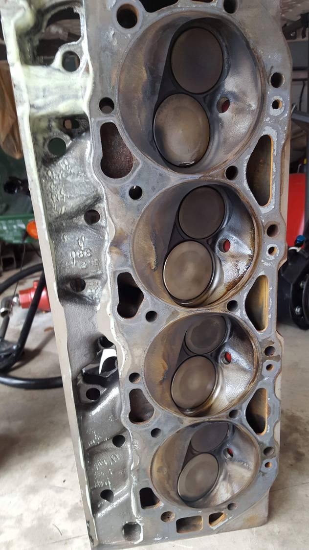

I got 621 HP and 675 lbs of torque out of my 548 with 088 iron heads. I would have to assume a 540 with better heads and cam should bump me up enough to put a smile on my face. I will still go with a small dome piston to be around 10:1 mark depending on the heads.
Here are some of the pics of my setup and it really looks like the intake to head connection was sealed and the head gaskets looked perfect. I have looked over the block and heads with a very bright light looking for a crack or anything weird. I have not found anything. I really think it has to be from the 2 sleeves that were installed in holes 3 and 5. No other invasive machine work was done.

Dude, why don't you spring for a set of head gaskets, bolt the heads back on and pressure test before you spend big bucks building another motor. If it turns out to be the sleeves they can be redone. It's summertime bud............

I have all the stuff to do it. I can put it back together sometime this week and test it. I do have another boat I bought this spring for the smaller lakes around my area and we have been having fun in that. This boat of heartache is strictly for Lake Tahoe.
