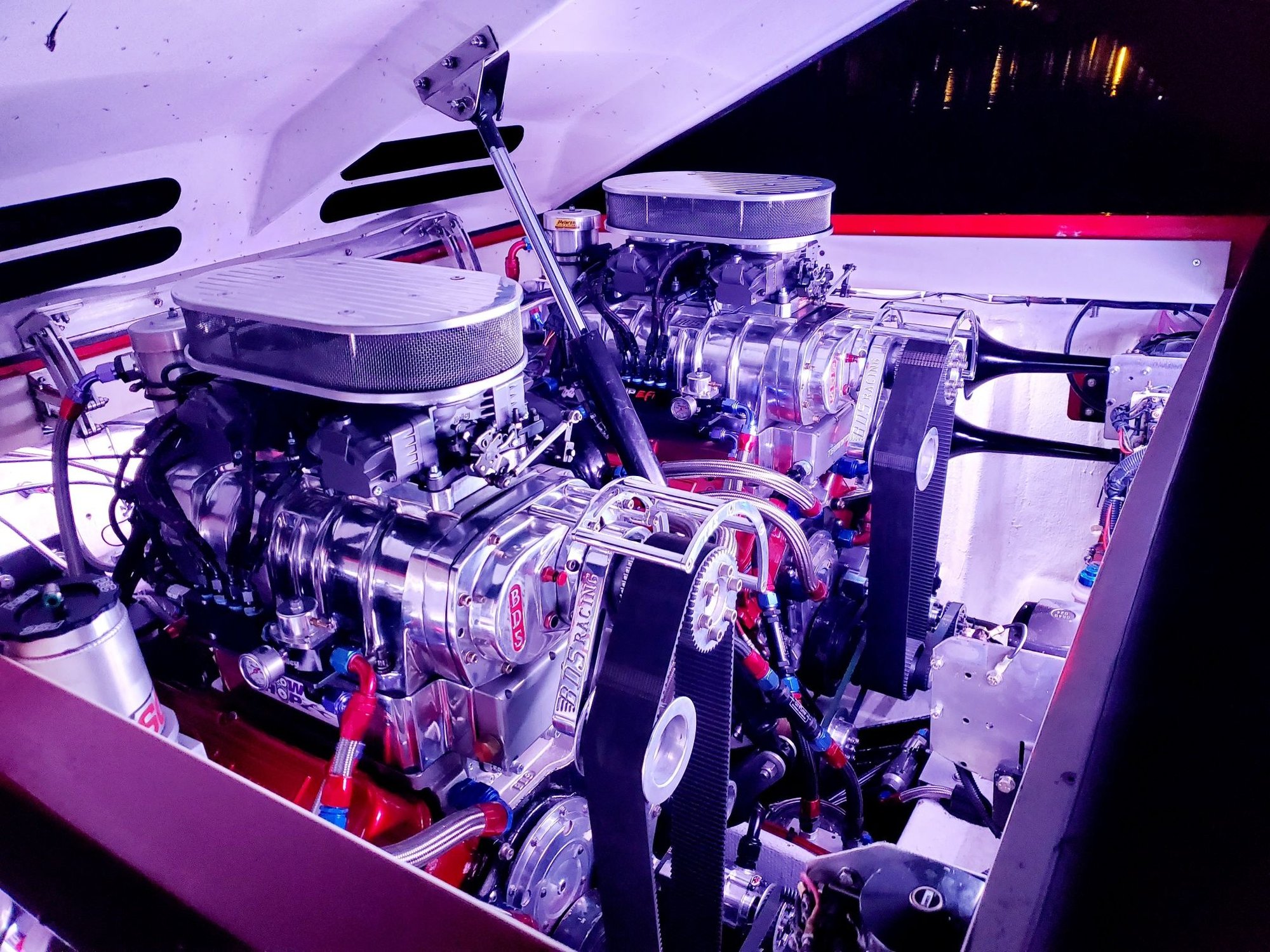

10 02's !!! Thats gonna be fun to monitor! I'm sure its data logged too, but trying to watch 10 AFR gauges just seems like a fun challenge. Looks amazing! I say white and OCD sucks.
Arcticfriends dyno is set up that way.

I`m hoping for better fuel distribution, future ready port or meth injection, plus room to be able to mount my coils finally.
Tunell rams always wins on Engine masters.
+1 on the port injection! Depends on how much reliable HP you want to make, there is a tipping point where port injection is a must have to be safe in an endurance (boat) engine. I think you will be very happy with the end results. and it looks so bad ass!

Are those going to fit under the lid still?

Still 2" shorter than the roots with all that stuff on top.
At least I hope I measured right ! lol

My plan is to dyno with 10 02`s to see what that fuel distribution is. You are correct , not a standard set up lol . Took me a while to pull the trigger , I thought it looked funny but i`m getting used to it .
What about welding bungs in each port. Injectors in all cylinders and then 4 injectors batched behind the throttle body. That's what I'm thinking of doing. Thoughts???
On my mustang 5.0, I think I'm going to run 4 injectors behind the throttle body and 4 injectors in the blower intake. 1 in each quadrant.
I will be dynoing at Smitty's with 10 O2's again.
Are the results similar when its forced induction?
