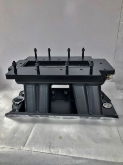

GET her done, https://www.alkydigger.net/proddetai...PRO216-Blower9
Had em in a week...nice folks to deal with. Even gave me a 5% discount for getting 2
Edit: I just found a pic of a black on that link.
I like it !
I like it !

I was looking to adapt this for my Mustang and Whipple but it definitely won't fit under the hood. And they don't make them for big blocks that I know of for my boat.
https://www.holley.com/products/engi...arts/300-274BK

[QUOTE=ICDEDPPL;4813361]GET her done, https://www.alkydigger.net/proddetai...PRO216-Blower9
I like it !
QUOTE]
Oh it’s gonna happen tonight - no doubt 😂.
On another note how’d you decide between the dart and profiler or even the 7085 eddy. I’ve read up on the 3 years ago when I was in this predicament and seemed up in the air. Seems like the darts need a lot of work or more than others but makes sense I guess to tailor to one’s specific build. One thing I do know for sure is they look fken cool and I’ve always wanted a TR build but always talked myself out of it $$$. I suppose in my case a single dom on top would be like putting perfume on a pig so dual carbs it is. Gonna stay old school until I convince myself to get with the times.
I looked up site early during a search however wanted to confirm they had in stock or a direct ship before paying and finding out later back order. I’ll give them a call tomorrow. Tks
Wonder how true it is longer runners work better NA and a little shorter runners like 5” work better with forced air. I have no direct experience with and just going by a few articles I read.
I like it !
QUOTE]

I think black too would look best .
