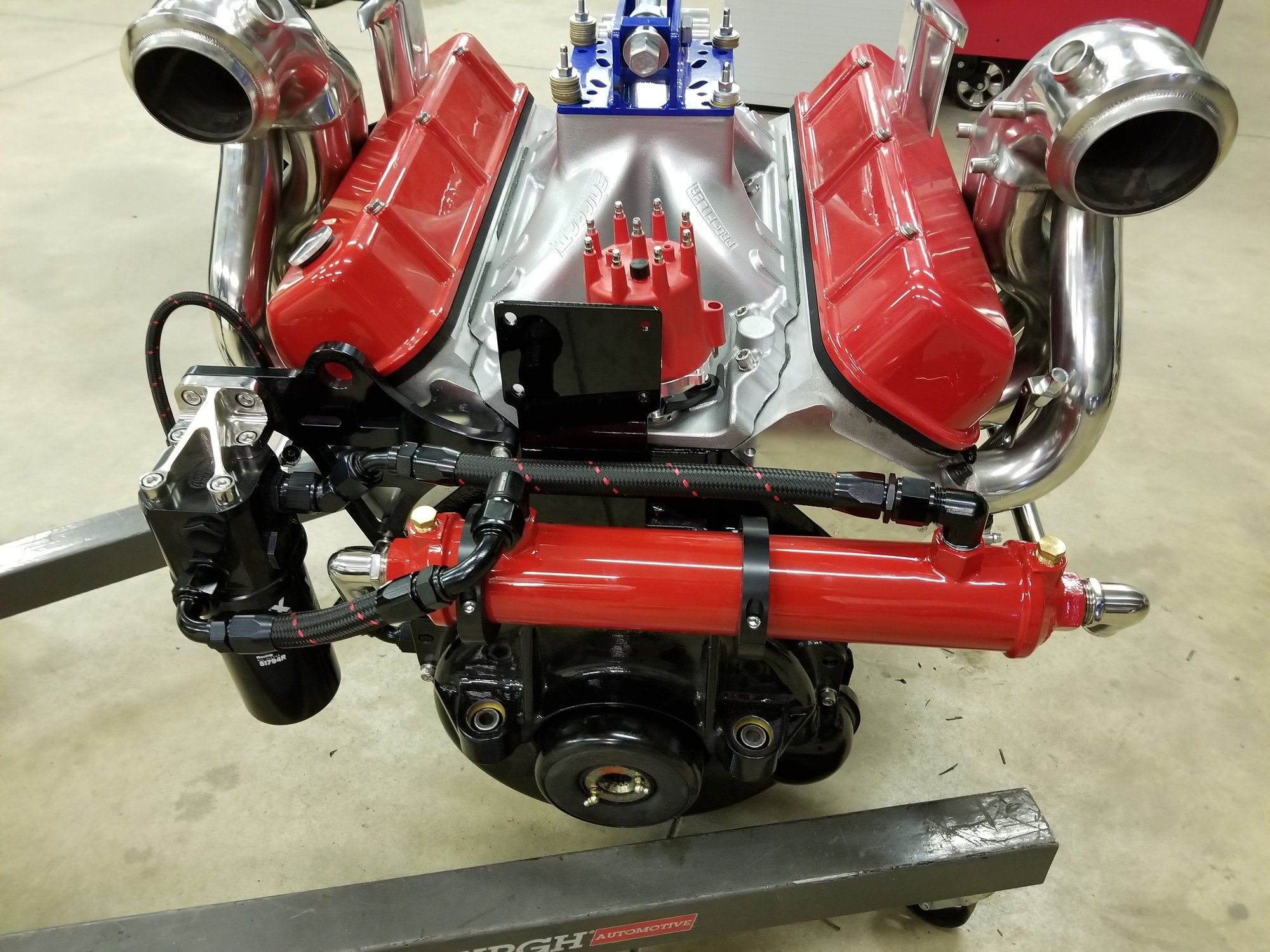

SABER28 10-08-2022 07:42 PM
this is mine, nice , compact and clears the transom bolts

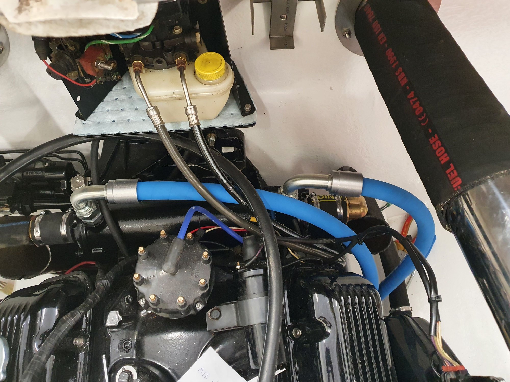

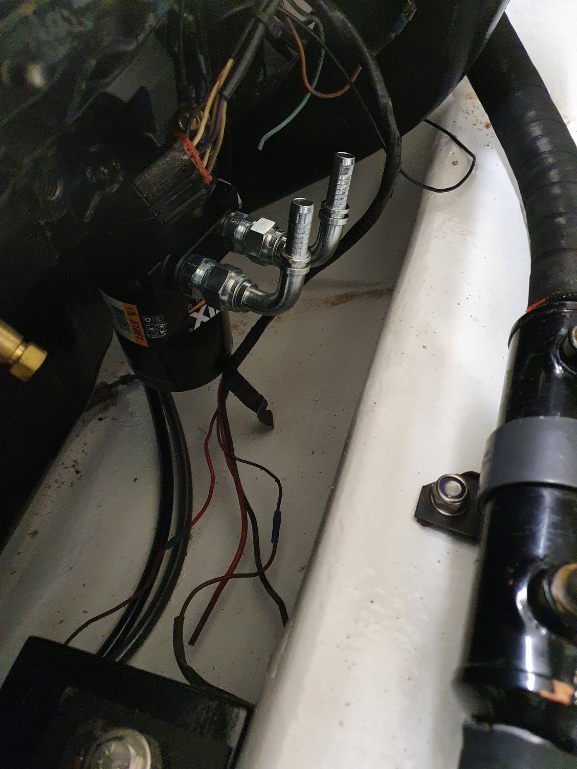

JaniH 10-09-2022 01:46 AM
I have plenty of room to change the filter so i kept it simple. Mocal s16t billet sandwich thermostat, jic 12 fittings.
https://cimg4.ibsrv.net/gimg/www.off...21c28ba366.jpg
https://cimg5.ibsrv.net/gimg/www.off...2dffc05337.jpg
Here is good picture of the difference between jic 10 vs jic 12. I have understood that AN fittings are better, but there is big differeces between a same size AN fittings, depending the manufacturer/type of the fitting, so look carefully when you choose the fittings.

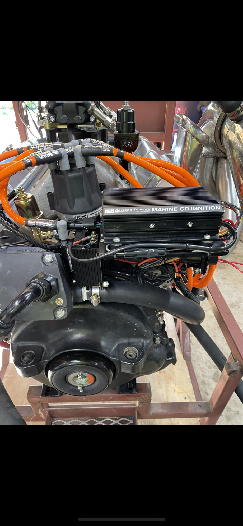

chancer540 10-16-2022 07:53 PM
https://cimg5.ibsrv.net/gimg/www.off...76e04b45c6.png
This is my 13 plate oil cooler an Daytona ignition.
